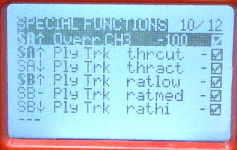

In the default model "FT Plane," when you push SA, it toggles the throttle off and on. But I didn't realize that for a long time. The audible message says "pressure on" and "pressure off". It took me forever to figure out that it was talking about the throttle.
But I can't figure out where that message came from. If I go into special functions, it says to use the audio file "thrcut" and "thract" depending upon the position of SA. There is also a special function when SA^ that it sets channel 3 to -100, which makes perfect sense.
So I connect the transmitter to my PC using USB. I copied the entire contents of the SD card to a folder and went looking through the .wav files. There are over 700 of them. I found "thrcut.wav" and "thract.wav," and when you play them on my PC, it says "Throttle Cut" and "Throttle Active."

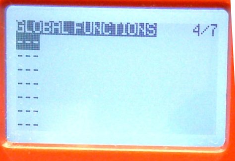

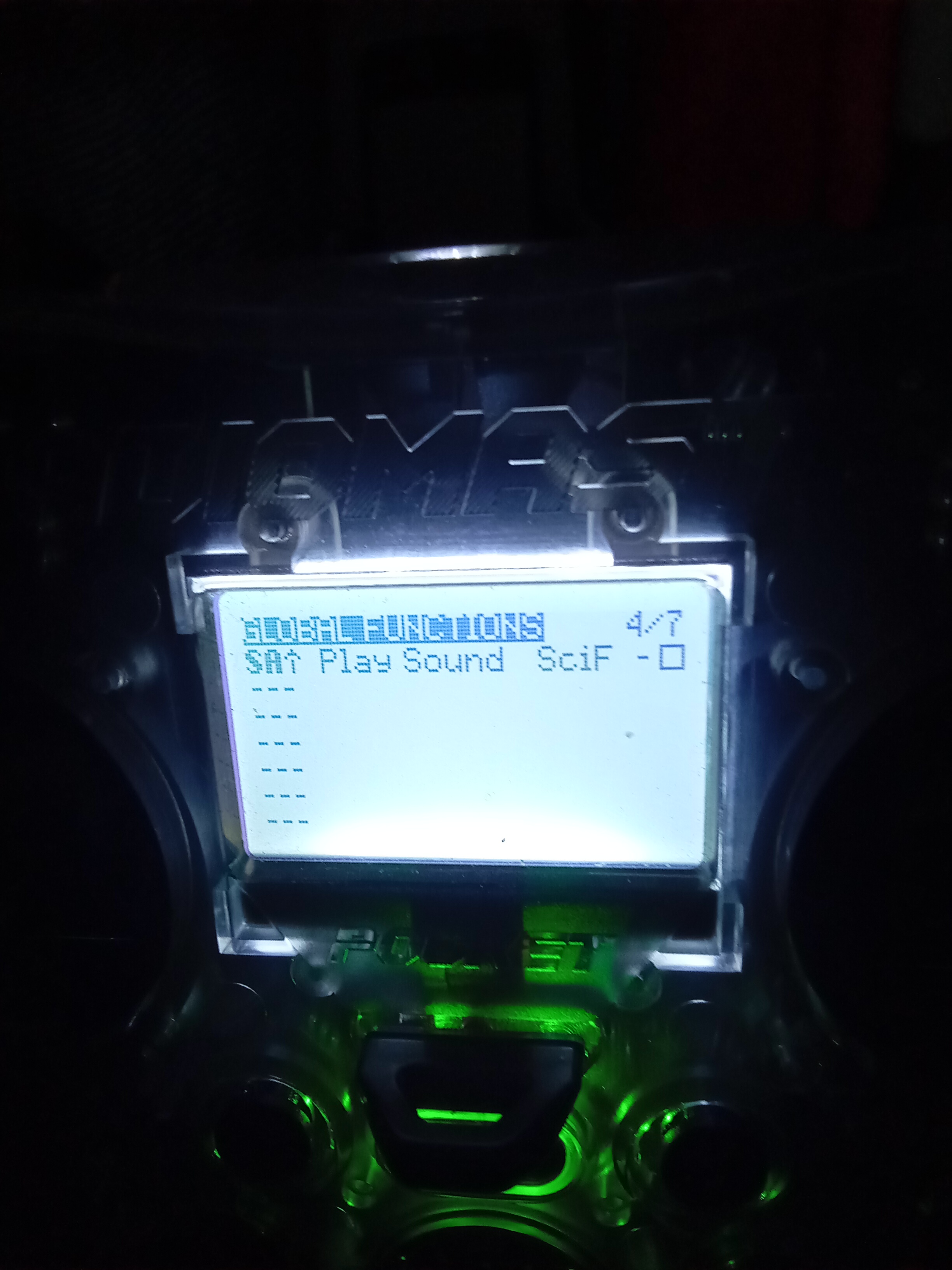

Is there a set of "special functions" that overrides model settings that is global to all models?
