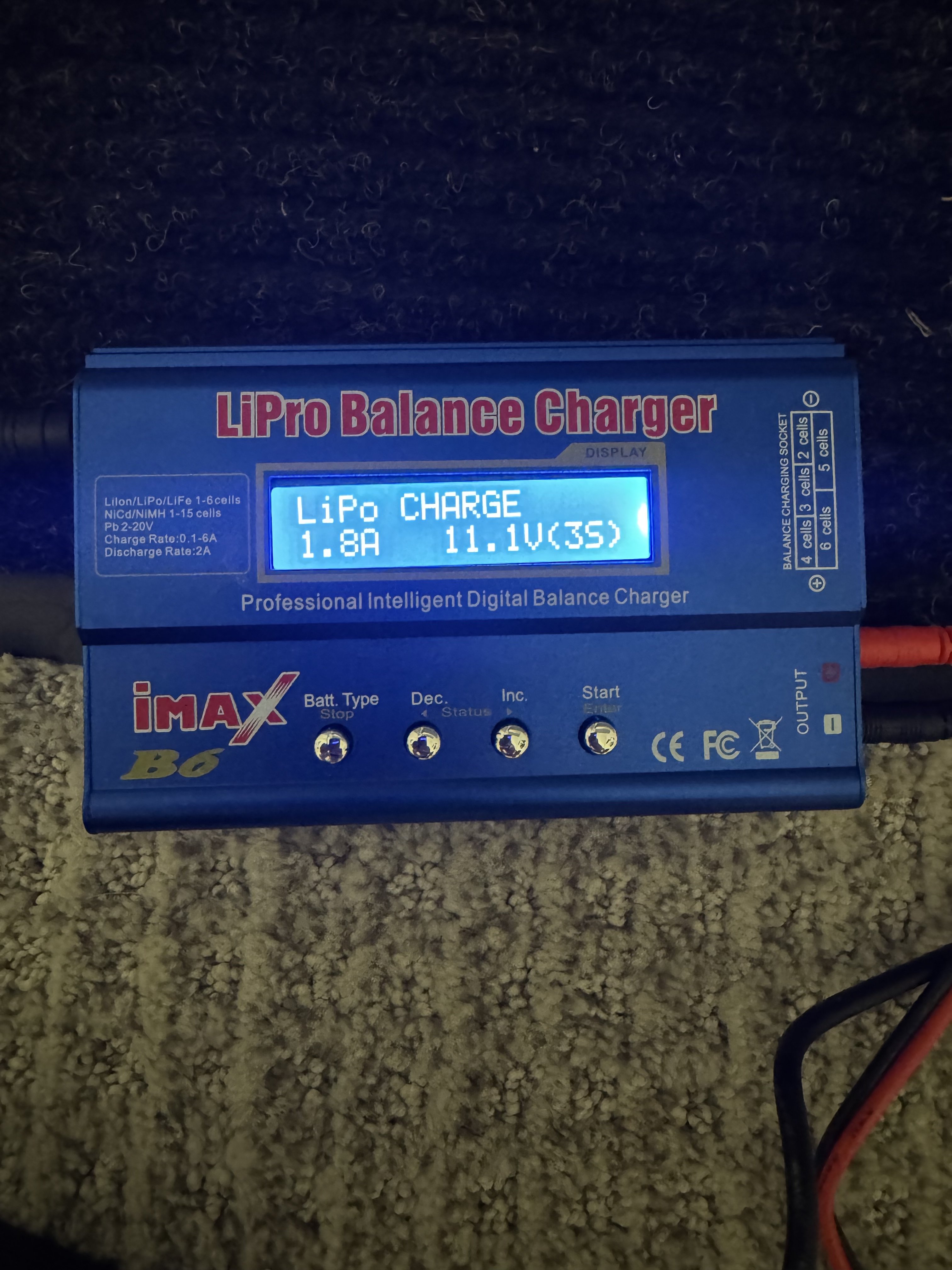

I bought the tattu 3cell, 11.1V, 1800mah battery and smart charger from flitetest. I set the charger to 1.8a, 11.1 V, 3 cell. I’ve charged it 3 times and this last time the battery swelled up like it was going to blow. Is 1.8a too much or is this just a defective battery?

Also you should NOT be using the "charge" program. You should be using "Balance Charge" program so that the charger is looking at the voltage of each cell in the battery.
