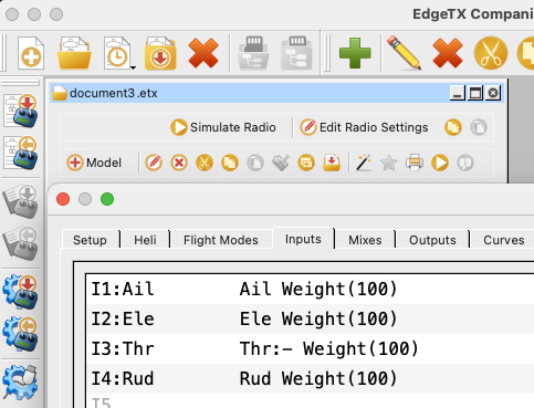

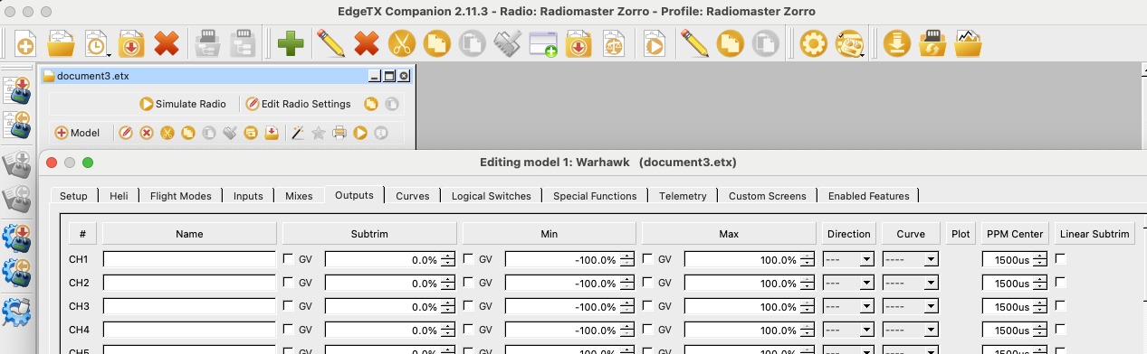

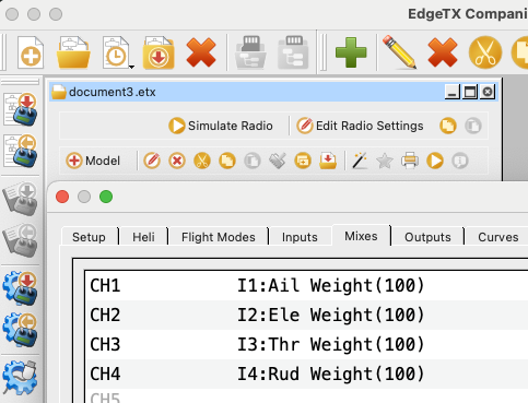

If it’s not that, I would check your input settings, mixes, and output settings for your throttle channel. Make sure you didn’t accidentally put your rates switch on your throttle or something. Also, make sure there is no trim or subtrim on that channel. There should be no mixes on your throttle channel either.

I've attached a few screenshots from EdgeTx Companion in case anything seems obviously wrong in Inputs, Mixes, and Outputs. I removed the Mix for channel 3 and that also didn't make any difference. No curves or switches.
