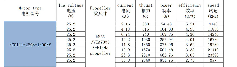

I have used the emax eco series motor (eco II, 1700 KV) for my vtol, and I can tell you that these motors consume a lot of power. I also saw on the official EMAX website that the motor you selected draws a maximum current of 56 amps. so, I would suggest choosing a higher-rated ESC, like I am using a Ready to sky 80 amp ESC
Though if you are using prop on the spec sheet it only shows 33amps...

Though if you are using prop on the spec sheet it only shows 33amps... View attachment 255839
I think the data on the spec sheet is tested in a controlled environment. In real-world conditions, you also have to account for other factors. I’ve often noticed that motors tend to draw more current than what’s specified in the datasheet, even when you run them with the intended battery and prop
It will draw maybe 10% more cold, resistance/actually impedance is less. Chinesium electronics do not work to published specs so add as a minimum 20% to keep smoke contained. Always buy bigger than you need, because..... I have some .010 gasser motors that are practically worthless for flying. Stop the prop from spinning and it will draw 20% more current, get hot, lets out the magic smoke. It's only too big if A: it wont fit, B it's on fire.
