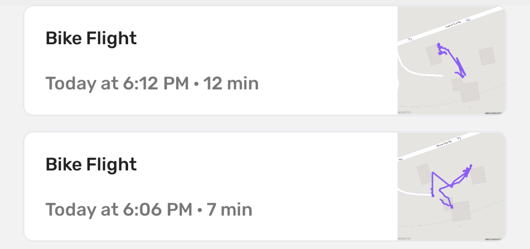

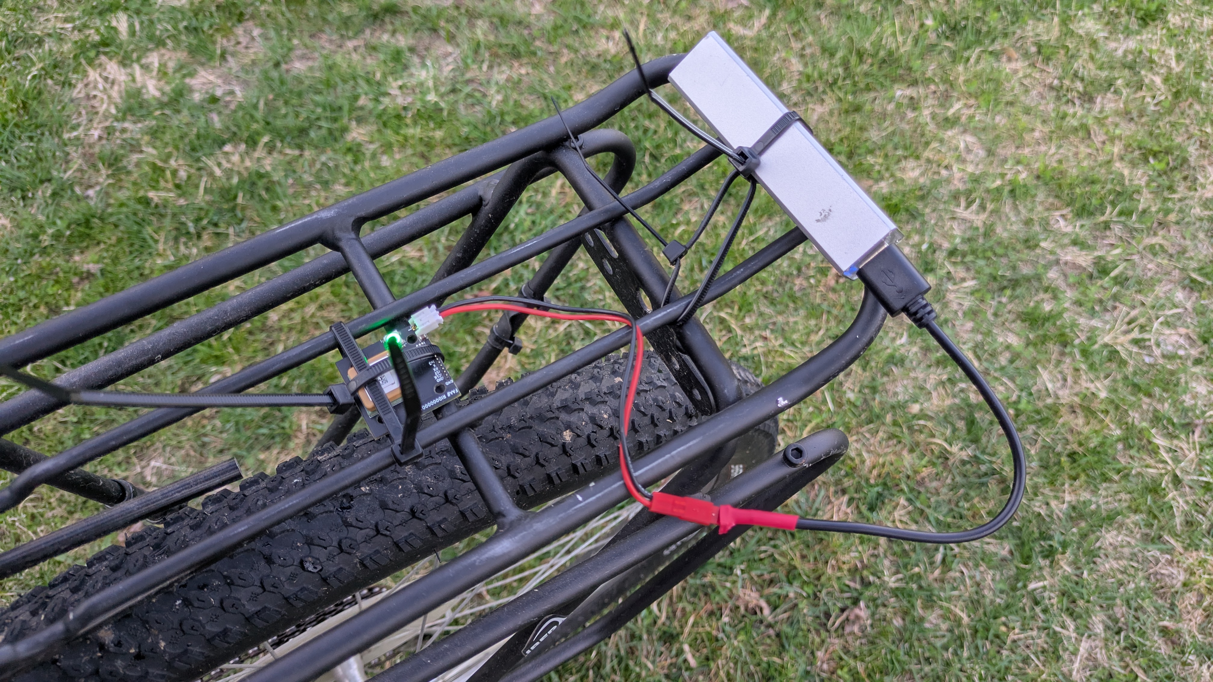

My ez id is having connection issues with my phone. For some reason, it only works if drone scanner is also open. This led to some testing with the ez id strapped to my bike since I have no working receivers right now. It works as expected. Not sure what it proves, but now I have "Bike Flight" in my logbook on the ft app. That's an interesting idea... The gps seems to work fine so it should work with ardupilot.

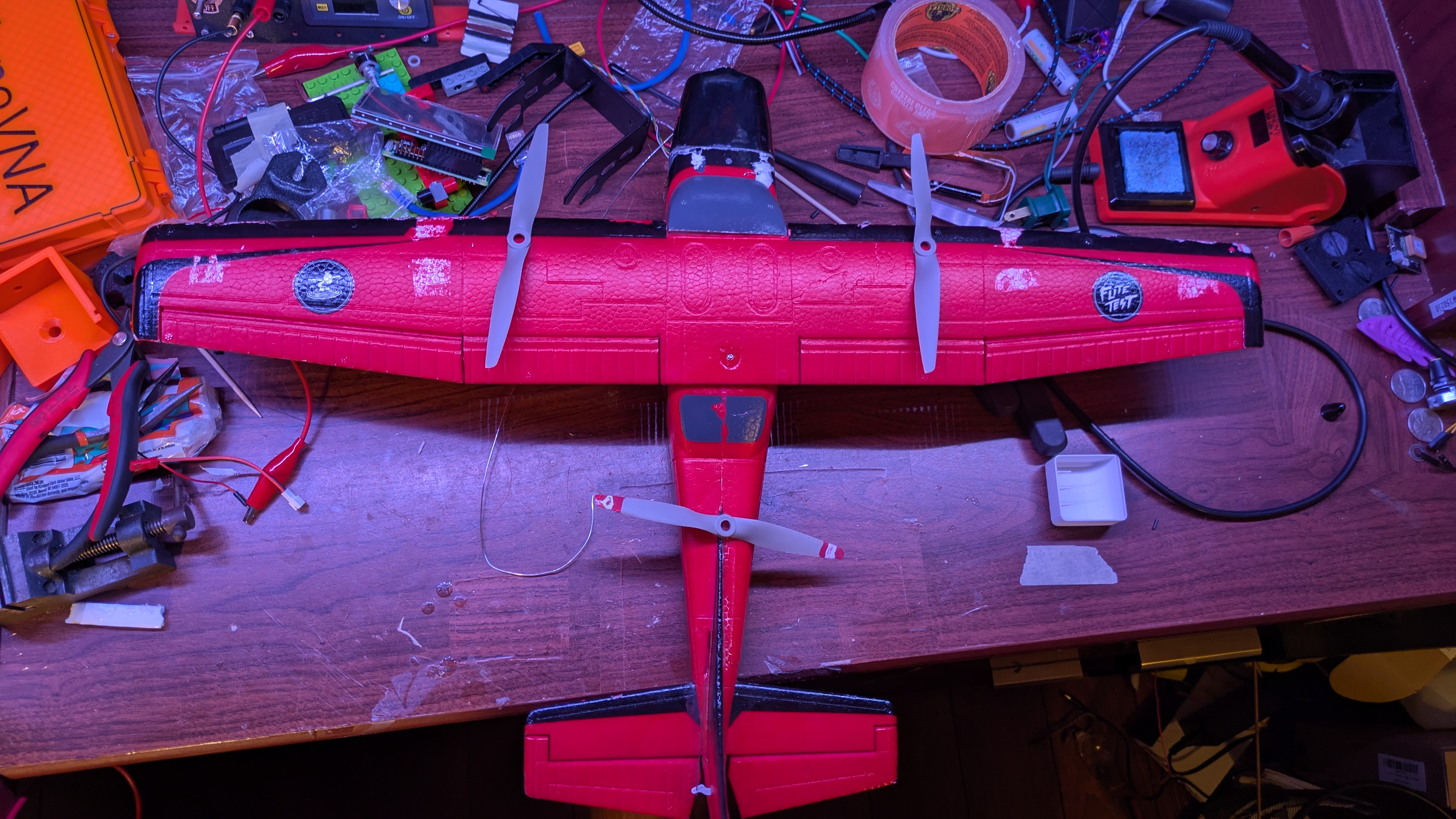

Thank you. That makes sense. And now I wait for the fc to get here... Maybe I can modify my tx (again). A new receiver is arriving tomorrow, so hopefully I can fly the mini explorer and see if it still works. It recently suffered from a very fast nosedive after my arduino based ground effect experiment failed, but I think I fixed it.

I had poor location data from the EZid which has never been resolved. Instead of smooth arcs and lines, it was more like 6ft chessboard square notchyness. The coordinates move in very blocky jumps which is not ideal for navigation. I would recommend a dedicated serial GPS which will be much more precise. Sure, the EZid can connect to a flight controller, But you will most likely have glitchy/erratic flight characteristics in flight modes that utilize the GPS.
FYI, The RemoteID apps get the same blocky data. I have tested a few other RID units, one with Ardupilot connectivity, and have had smooth results like a serial GPS would get.

Interesting. Mine seems to have some of that, but it doesn't look as bad as you are describing. Probably because I only have "flight" data from me on a bike. I would imagine that going faster would make this a bigger issue.

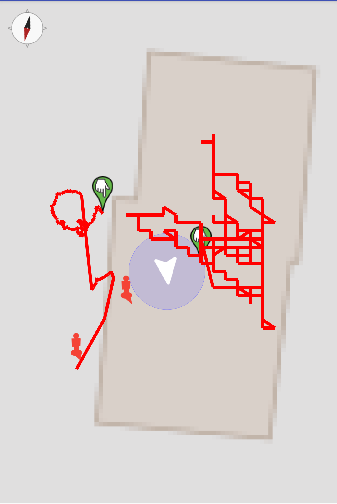

This was the result from two different tests with a Ruko and the EZID. Ruko (not roku) on the left, and EZID on the right. It looks like some sort of rounding or decimal mismatch in the firmware.

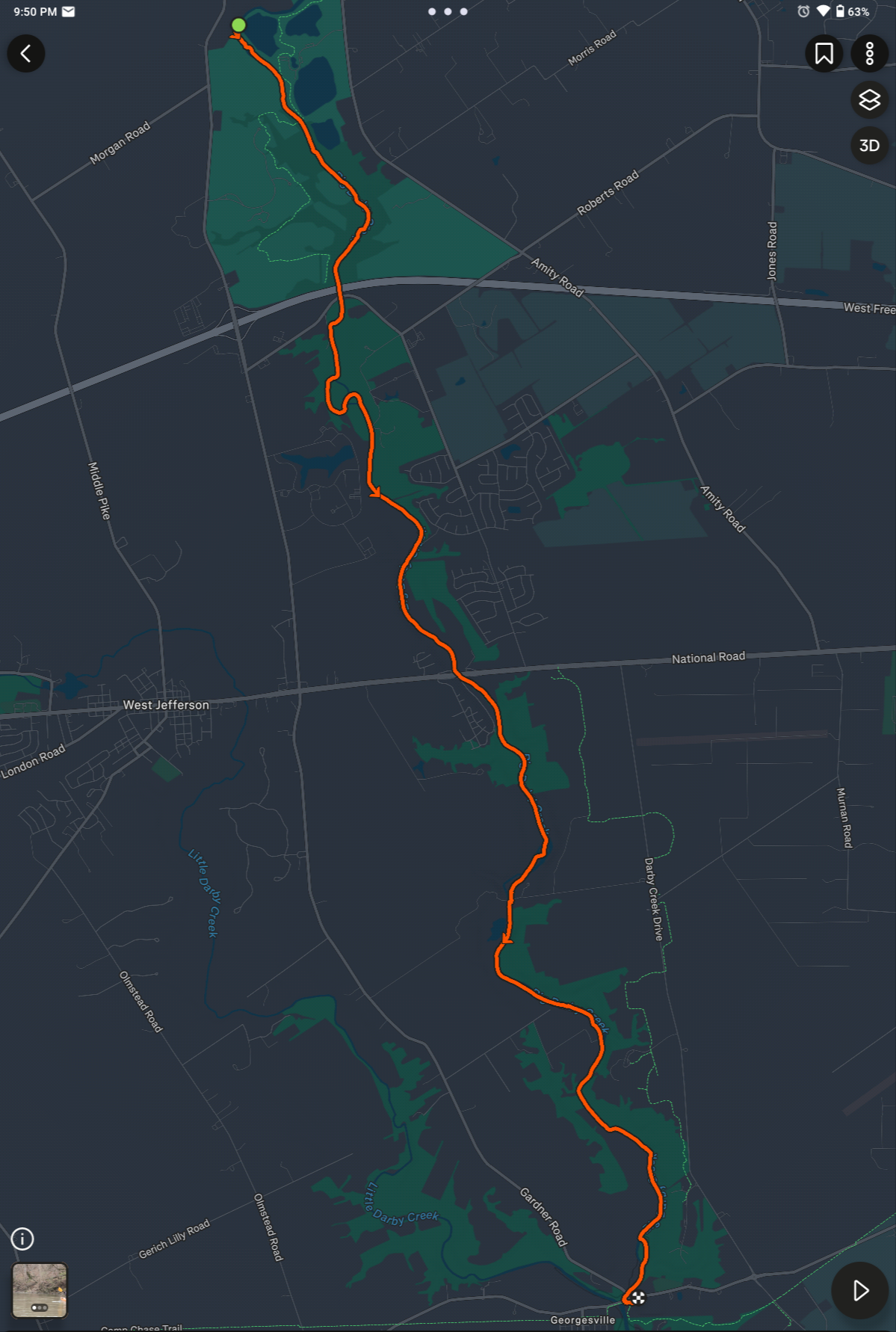

LOL. I should take mine on a bike ride tomorrow and compare it to my Wahoo Bike GPS. People in last years top speed challenge remember some of my bike escapades last year.
