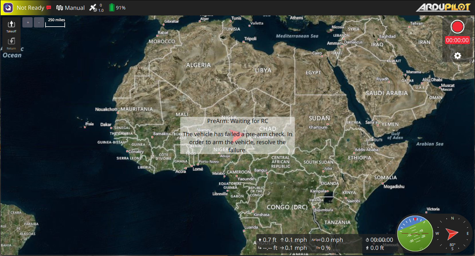

Well, it's doing something...

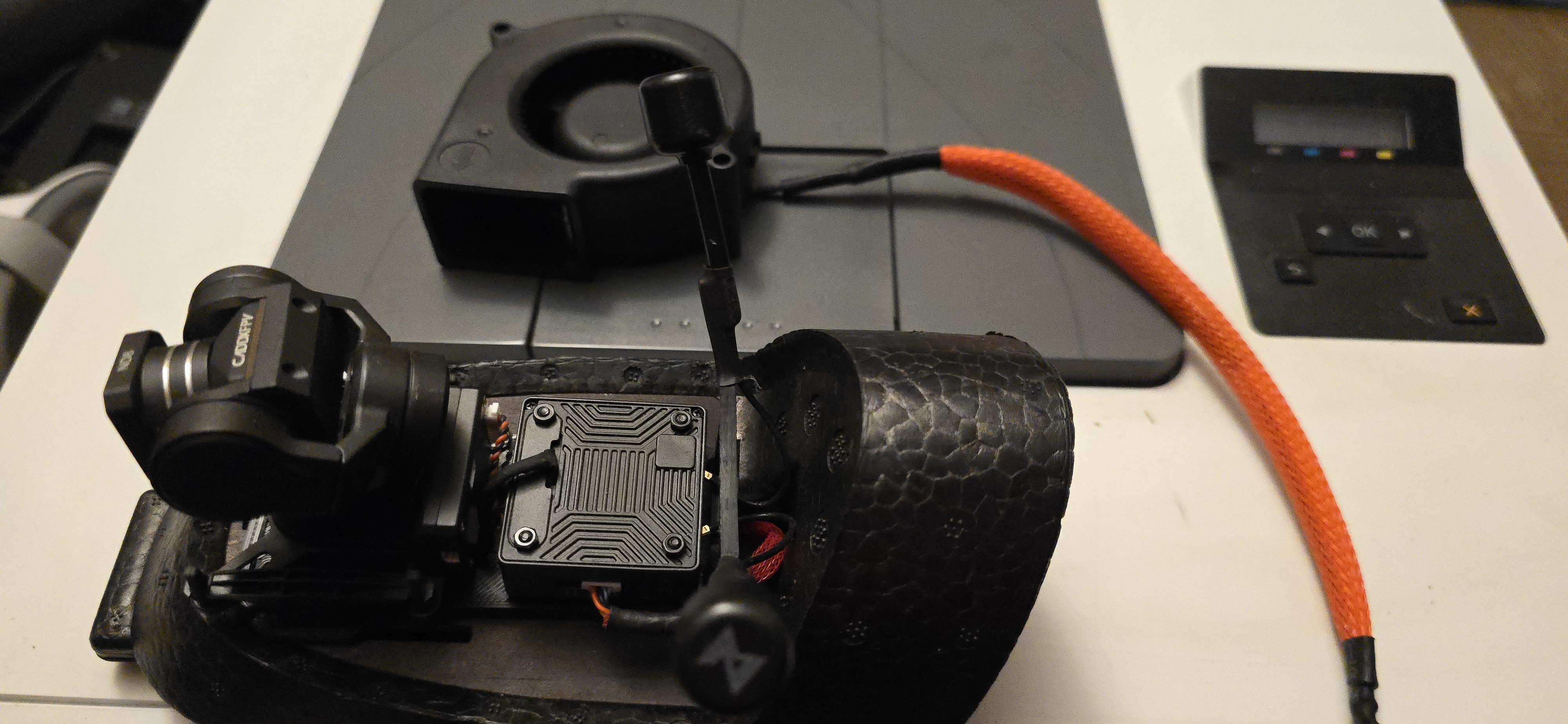

Supposedly mine has a pit mode, but the manual doesn't say anything about turning it on and I can't find anything about it. What does that fan look like?
Tree Feeder
I think my vtx defaults to full power, so that probably wasn't helping. I think I have a fan from upgrading my 3d printer that would probably work for that. I did get a few very succesful flights on that EZ pack plane with the aio camera on it and I should be able to fly the mini explorer with ardupilot soon. I did test ardupilot's video system, and everything worked!

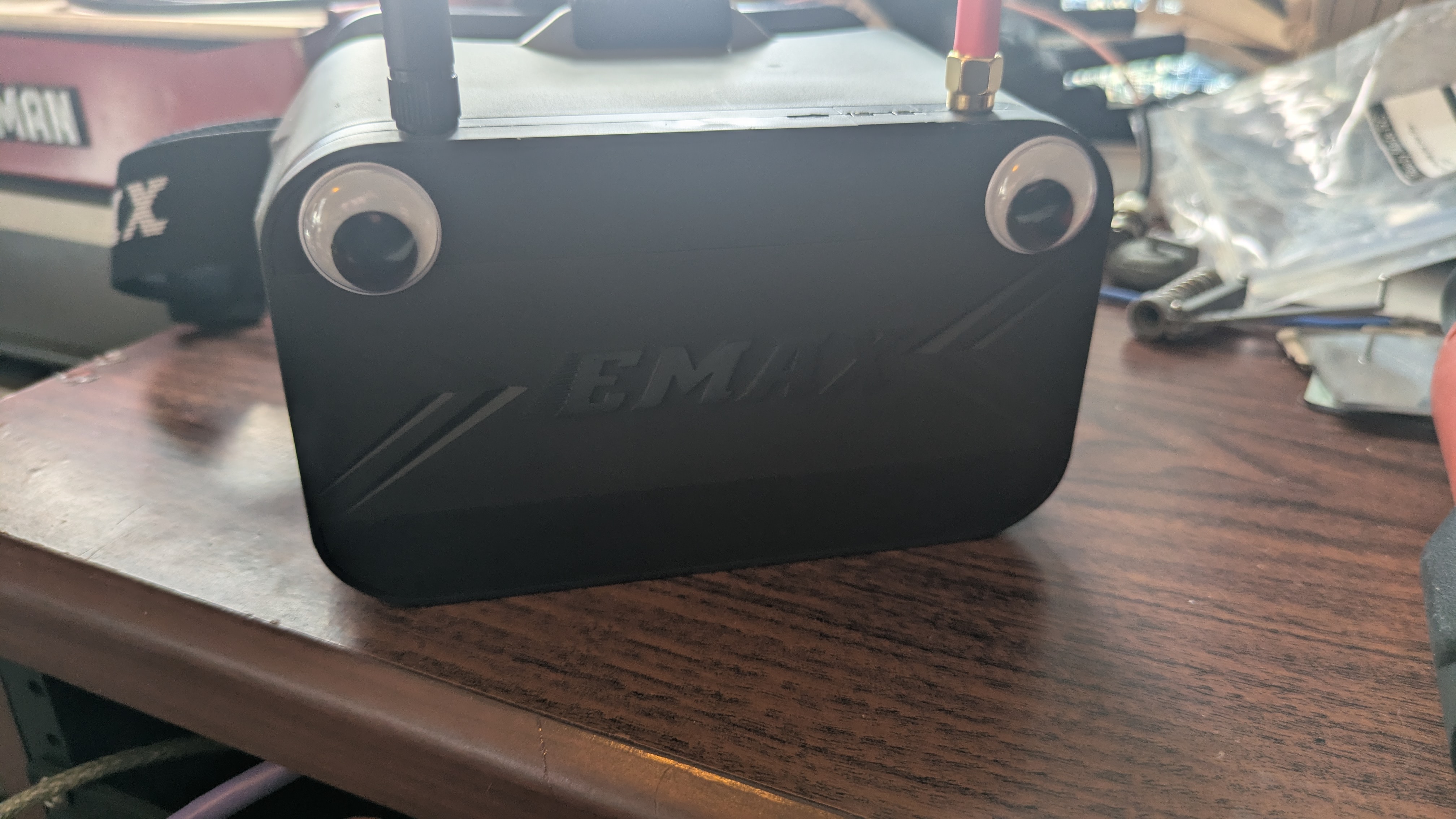

Also did the most essential goggle mod ever! :)

I have experimented with ibus telem, but I haven't been able to to get it to work. I went back to the normal firmware because I was having issues with my EZ ID as a gps, but I tried it again today after resetting everything and then it wouldn't even power on. After further testing, I think that I burnt out another GPS. I did get in some amazing FPV flights with the little EZ pack plane (and I think I set an altitude record too for those planes) and I tried to make it work without a gps, but there is always the ekf3 error whenever I try to arm. I am not sure what else I can change, because I have looked at almost every possible parameter that seems relevant, but I can't find anything. Does anyone know what these parameters could be?

So far, I have disabled EKF3, disabled GPS, and it is still giving me the AHRS: EKF3 not started error when I try to arm.
EHRS errors are fun to diagnose... Usually GPS related.
Disable the GPS check bit in ARMING_CHECKS
