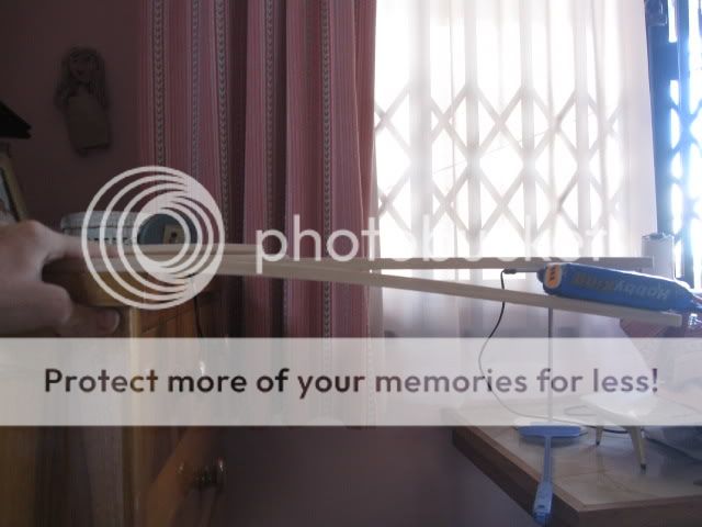

Is balsa Wood too soft for the arms of a tricopter?
For 60 cm arms, yes. I bought a bag of 10 - I picked the three most rigid ones, and after some time opening and folding the frame, one of the sticks broke at the axis screw. Maybe around 30-40 cm arms it will get better with the rigidity, but not with the breakability problem.
I also found that zip-ties sink into the wood quite harshly.
In a month or so I'll have most parts to start building my tricopter - so then I'll be able to test the range of booms I have gotten. These include:
3/4" (actually 5/8") square aluminum tube
13 x 13 mm cheap wood of some kind
10 x 10 mm laurel (?) wood, not well cut, width varies badly
Maybe I'll try eucalyptus booms!
I've heard that balsa and carbon or Aluminium (U- or L-shape) reinforcement makes for stiff arms!
colorex
Rotor Riot!
For a 17 inch arm is it okay with the balsa?
That depends - how much power does your copter have?
For the standard RCExplorer tricopter it's 24 inch arms - and it has around 3000g (6.6 lbs) of total power - which makes for 750 grams of pull on each boom. The following setup is at 17", with a 2200mAh 25C LiPo - Around only 200 - 250 grams, and the boom bends too much.
colorex
Rotor Riot!
Would basswood be more efficient?
I have no experience with basswood. If it is stiff enough it can be used.
How stiff, you may wonder. In my opinion, a 1x1x60 cm piece, with 50 cm over a table edge, shouldn't flex more than 1 cm with a 2200mAh battery on the tip, like shown above.
If the booms are too flexible, they can break if you push the throttle, or you'll have a bouncy platform.
