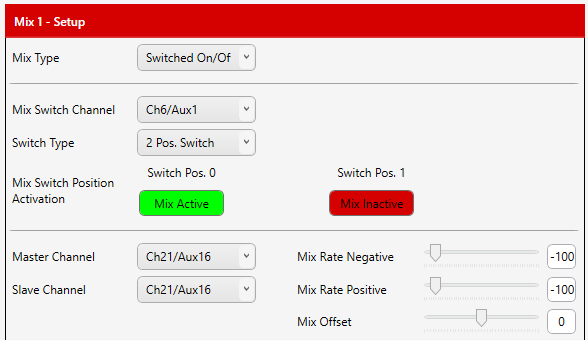

I am in the final steps of getting my Tubby B17 ready to fly. I have installed an Aura 5 connected to a Radiomaster R88 receiver. Everything is programmed and ready,with Channel 5 for the mode select on the Aura and Channel 7/Aux 2 set for the bomb bay.
My question is in regards to channel 6/Aux1. In the Aura Config file it appears in the mixes tab for the differential thrust that this mix is set up to be enabled/disabled by a to position switch on channel 6/aux1
My assumption is this is in place to allow the diff thrust to be turned off as wished if i assign a switch to channel 6, correct?

I have a Bronco "A-tail" twin, but I don't mix the throttles. I have only one throttle connection. and normal rudder control. If you want to test this, be sure to REMOVE THE PROPS ON THE PLANE!
One caveat; You should have only one of the BEC connections to the Aura.
Is this a config supplied by FT?
On my Bronco, I have to reach between the props to connect the battery. I added a switch to the rear of the fuselage to make sure the props don't spin when my hands are near the props arc. I can reach the switch without my hands coming anywhere near the meat-chopping spinny things (aka props).

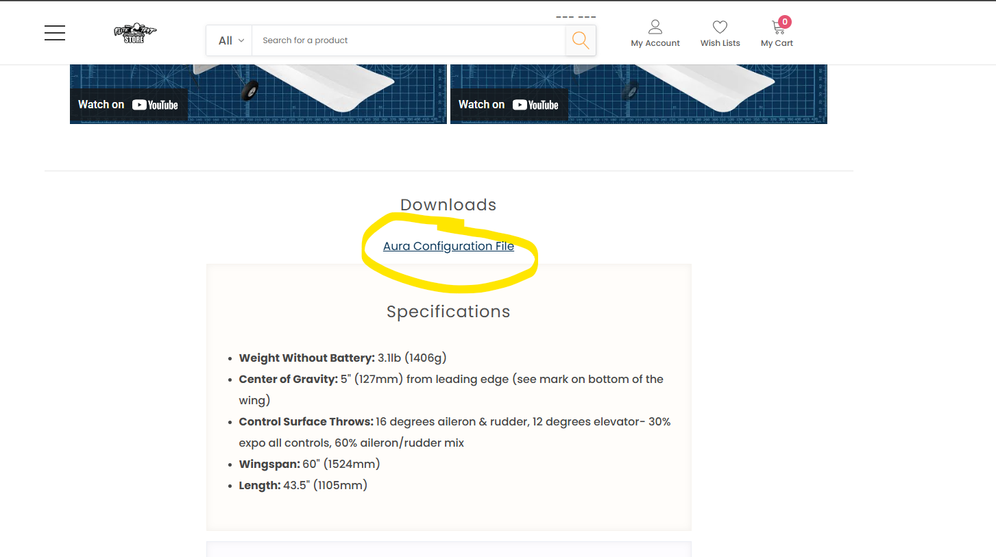

Love that you get the profile from FliteTest. I am having trouble locating the files (user error). Where do you find those? I'm looking for the one for the Super Scout XL. Thanks!!!!
kdobson83
its found on the Flite Test store under the Scout XL about 2/3rds of the way down. See screenshot below.
