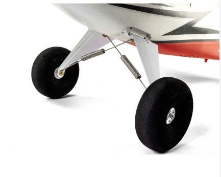

I re-did the printed inserts to use 1/8" wire, but I must suck at landing, cuz I'm still bending 1/8" wire gear. To be fair I'm flying on two 4S 4000s. I think I'm going to upsize it even more. Might try to fit in some of the old school 'springy' gear with a loop if I can find some that fit
dave0498
Agreed. I thought about trying to get Timber Evolution gear on there, but I couldn't figure it out.
