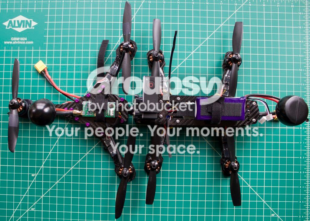

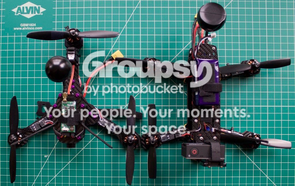

This frame is almost exactly the same size as the Blackout mini H 220. Here are a couple photos of the two frames:

so im guessing the point is they are more aggressive? wider blades, by snubbing up the end. is this the correct logic behind them?
Right. From what I can tell, they are the same as the 6x4.5s with the last half inch (the tapered portion) cut off. Before HQ started producing the 5x4.5s, people were buying the 6x4.5s and cutting them down to 5 inches to get the same effect.
They're not as efficient as props with a taper, but most minis aren't going for efficiency anyway.
