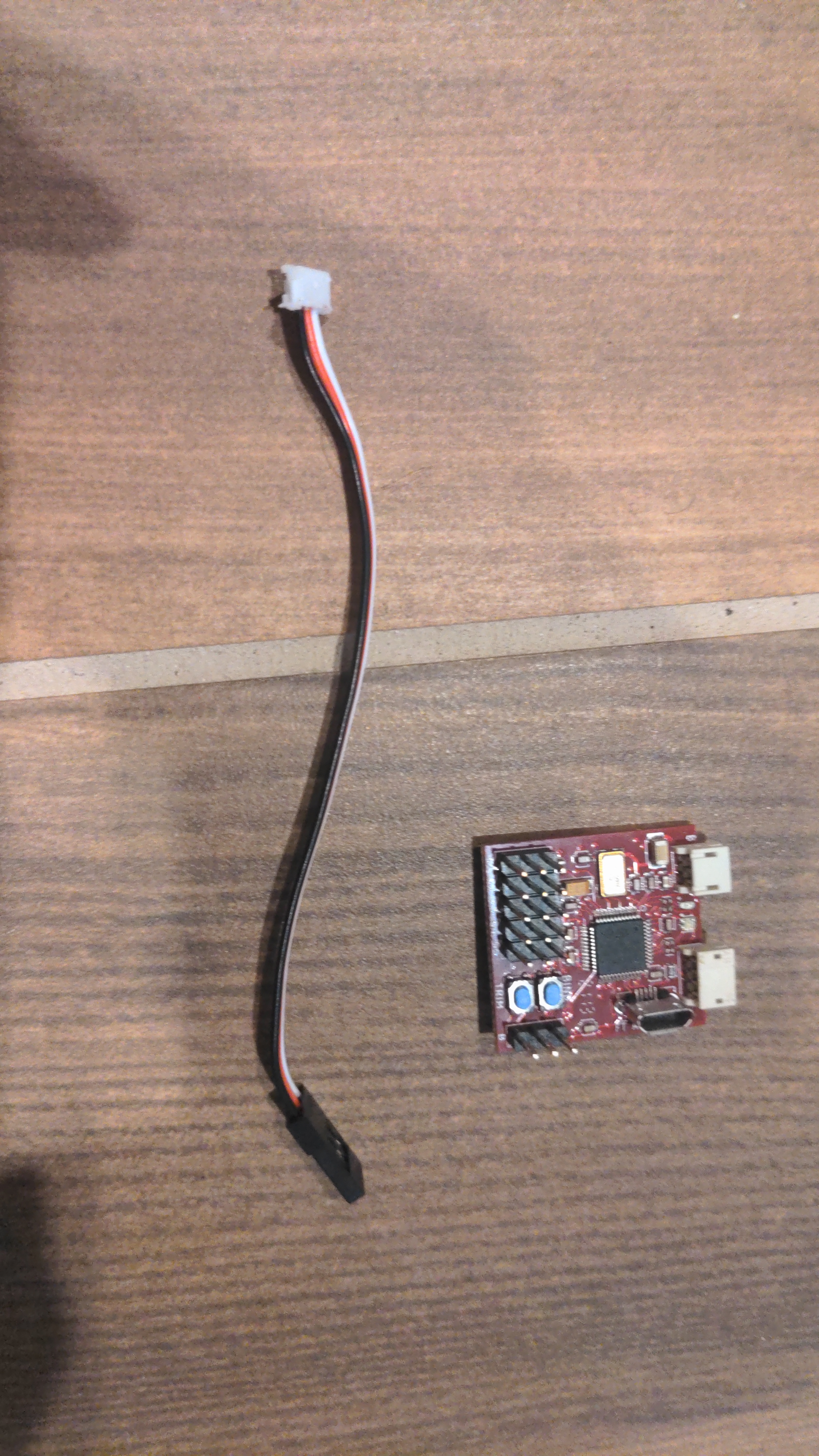

Hey guys how do you connect the receiver to the aura? I have this little cable that came with my r88 that I think connects the gyro to the RX but idk which end goes in the RX and which goes in the aura.

To connect to a serial receiver you need a cable with two of the black ends on it. One will plug into your receiver port and the other will plug into port B on the aura. If you’re using a dsmx satellite reciever it’ll plug into one of the white ports on top of the aura.
