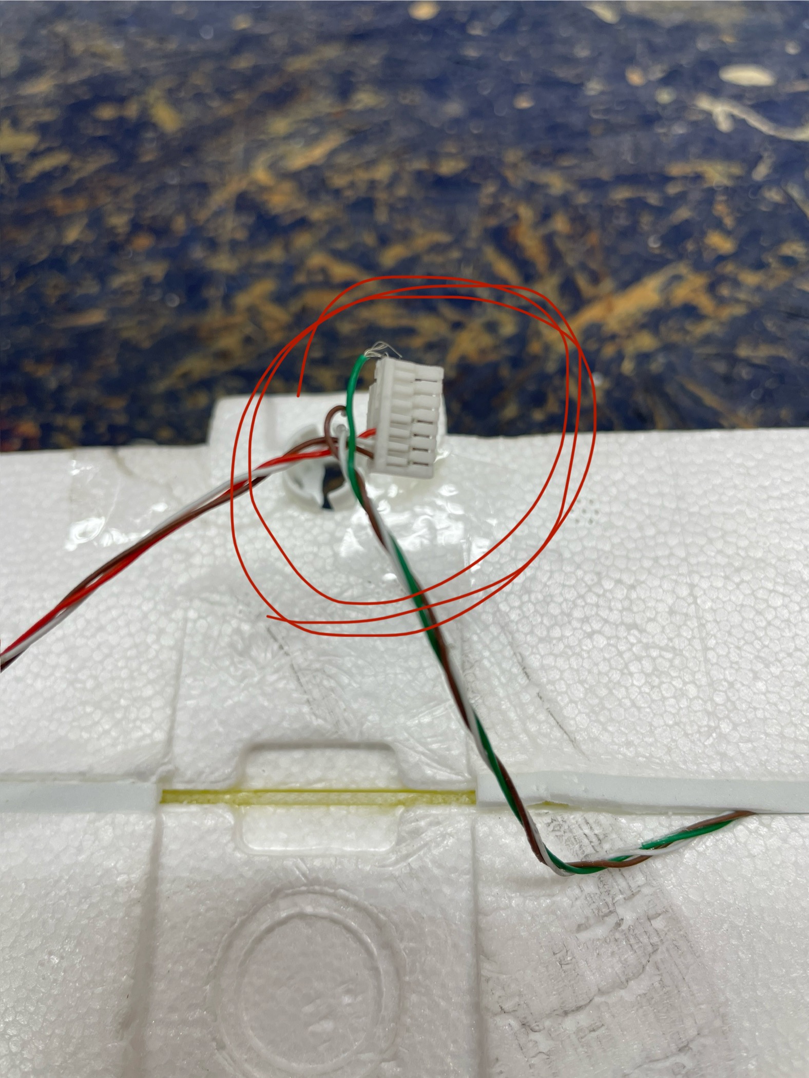

My UMX Conscendo had a little spill causing the wing to exit the fuse. As a result the plug for the wing’s ailerons had three wires become disconnected from the white plug. See attached pic. What is this plug called and where can I find a replacement plug. I know the wing is only $20 but I am cheap.
Thanks

You mean not everyone has an UMX Conscendo? Thanks for your input. If someone knows what the plug is called feel free to mention it. Otherwise, I will get around to contact EFlite support to ask them. Or I will just buy the $20 wing replacement.
Captain Video
Hard to tell from the picture, but it resembles a JST plug.
JST plugs come in various pitch's, the distance between the pins, and various number of pins.
Maybe this will help
https://en.wikipedia.org/wiki/JST_connector
Marv. Thanks for your reply. I think will be able to work a temp solution for the ailerons. I think I can wire the left aileron power reverse. Just like other Flite test builds. What do you think?
Bricks
If that wire pulled out the pin should still be in there, you may be able to get it out open it up and recrimp the wire. By memory there is a little plastic tab holding the pin in lift it up and push the pin out.
Yup, it appears to be some sort of jst 7 pin connector. My buddy has a umx conscendo, so I can post some pics of the plug for reference if ya want.
