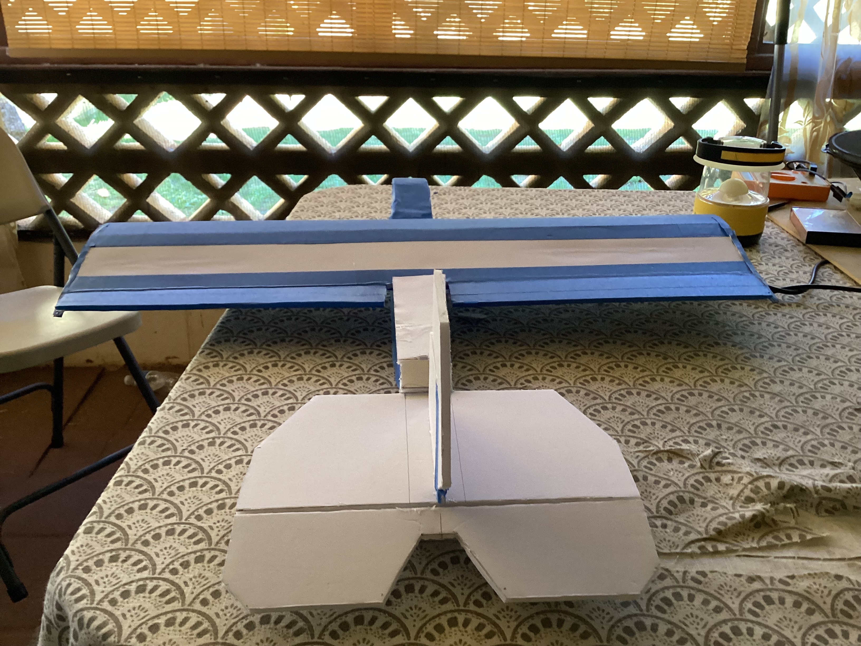

All LIPO batteries then are charged at the wall outlet? For how long? And my airplane calls for 5,640 mah. Under 2 ibs. 560 grams weighing in now. Should be under 2 ibs. or just under 1 kg. In the video they only give 1000 mah. They just go on watt factor then? 300 watts is the watt factor for a 2 ibs airplane. Which do I buy? Steps I took to get the mAh.
1. At 300 watts used for the watt factor it comes out to this…
2. The formula i used. Watt factor/battery voltage = x
3. y = (x) x (10/60)/0.80 < === this is the battery capacity. 0.80 is the 80% rule discharge rate. 10/60 is the fraction in 10 minute flight Time.
4. y = mAh or milliamperes/hour.
y x 1000 = 5,640 mah.
Also this airplane, I threw it and it flew for 15 yards and it went straight. So good to go on.

...They just go on watt factor then? 300 watts is the watt factor for a 2 ibs airplane....
Watt factor for batteries no, for motors yes.
To pick your motor, watts per pound is a good rule of thumb. 80 watts per pound is a minimum, 200 watts per pound will give you unlimited vertical. After you pick a motor the mfg will suggest a voltage and amperage. Pick a battery that can supply a few more amps at the voltage the motor is looking for.
That sounds wayy to big for that size of a plane! It proably going to be right around a 3cell 1,000 mah lipo👍
