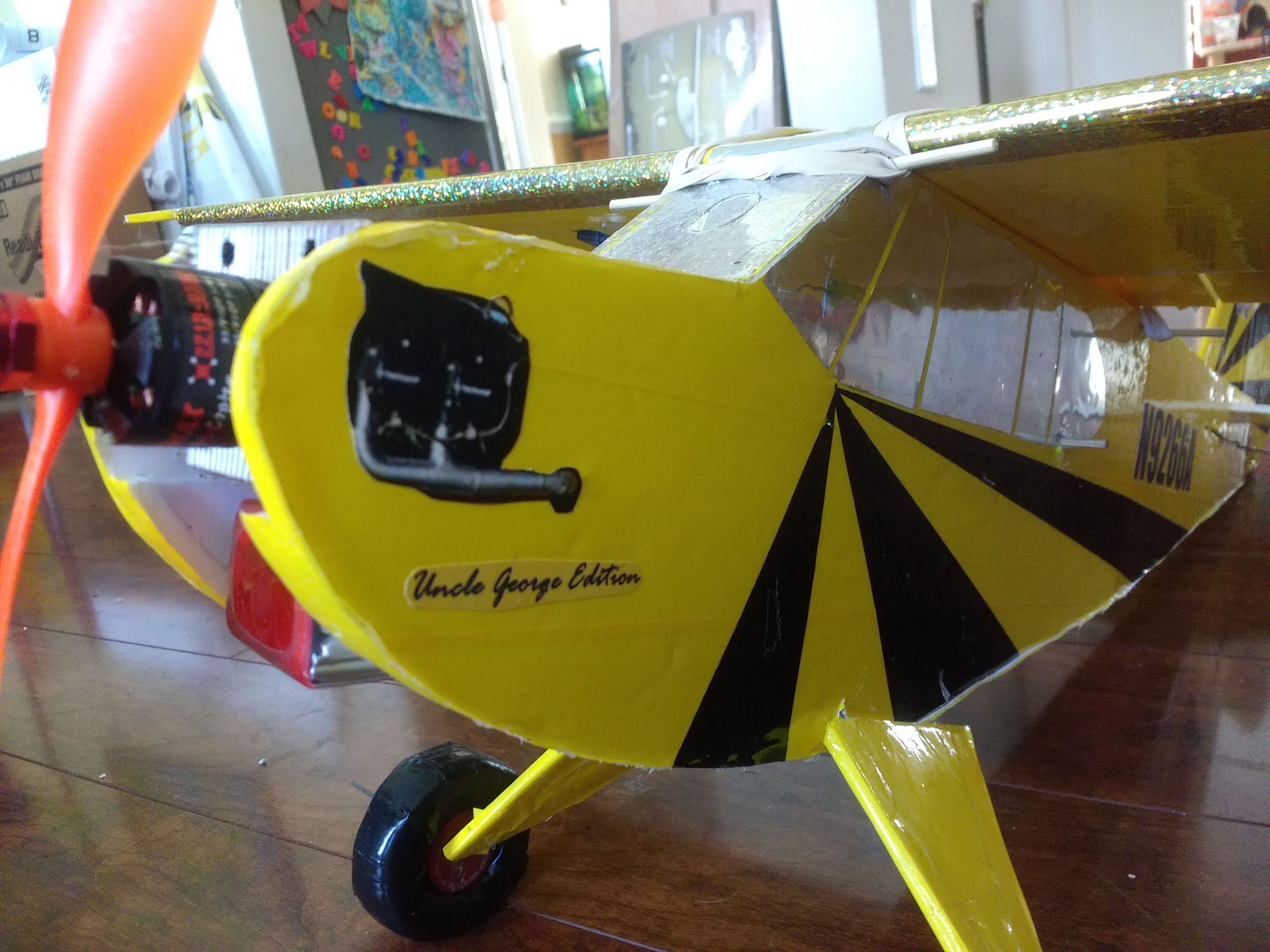

ya, didn't want to rub it in. if you look closely mine is also 1-of-a-kind. I had Rasterize modify the skins a little. this airplane is being built for a silent auction @ my school to raise money for the PTO. i am building this and another of my own wing designs, each will come with everything needed to start flying. hope to make a decent amount for the school but since this is the first time i have tried this, i have no idea what to expect. cross fingers.
skins are cool but i always forget how much more work and time it adds to the build. can't wait until someone figures out how to print the skins on the foam and save us all some time. ;)
