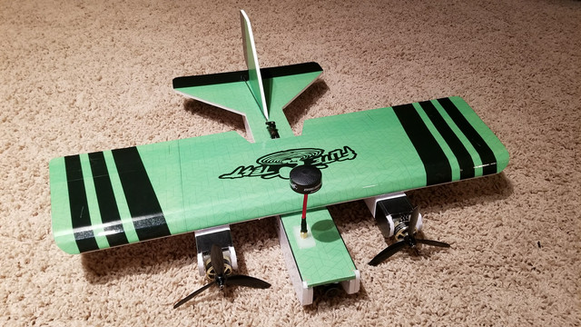

After watching a number of videos of people's maiden flight of the SuperBee, and seeing that it had a tendency to nose down immediately upon launch, I decided to configure my ailerons so neutral is aligned with the bottom of the wing instead of the top wing surface.
I was happily surprised during my maiden flight when it floated out of my hand straight and true. It did not require any elevator trim, nor any up elevator input on launch. It only needed a couple clicks of left trim and she was good to go.
I know that Josh's build video says to align the ailerons with the top wing plate (so slightly down), but based on my experience, I would recommend trying it with the ailerons aligned with the Bottom wing surface.
Sorry I didn't get a video. Everyone at the field had their own planes in the air.
My AUW is about 16 Oz.
Electronics:
Suppo 2208/8 2600kv x 2
Suppo 30A ESC x 2
APC 4.75x4.75 (one E and one EP)
RCTimer TS-9018 9 Gram servos x 3
1000Mah 65C 3S Turnigy Graphene
FrSky D8R-XP
3D printed Firewalls and Control horns
