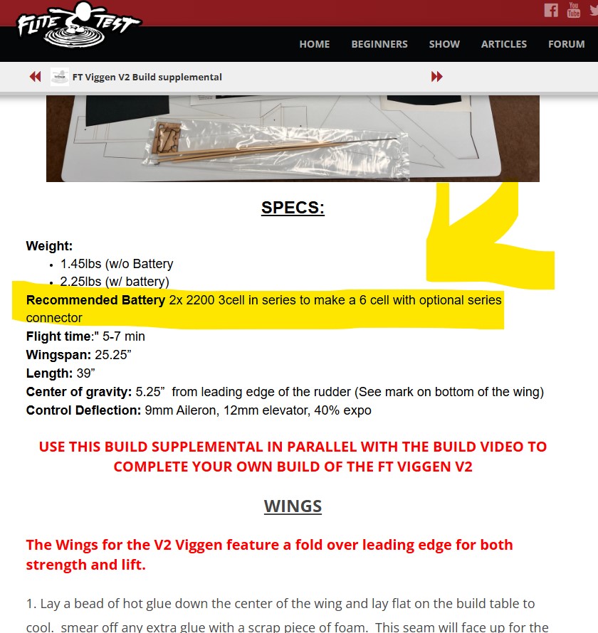

I've been thinking about getting the Viggen V2 kit, and note there is an excellent supplemental article that goes along with the build video.
The article is here: https://www.flitetest.com/articles/ft-viggen-v2-build-supplemental
Okay - one thing I'm confused about is power. The prototype video has the EDF running on 4S and speed gun clocks 80mph!
Why then doe the supplemental article spec say 6S as per the below? How much power is really necessary? - I was hoping to run a decent 4S battery for better flight time. Thoughts? Thanks John

I prefer the 6s. The 4s just seems to lack power, but it will work okay and save you a little money on ESC. If you do go 4s, make sure you get a 4s EDF and not a 6s one. Not sure what your flight experience is too, but this is not a good first plane either. That's just my opinion and I do believe that "overkill is underrated," so you might keep that in mind too. :oops::)

You should have no problem with the Viggen either way then.
