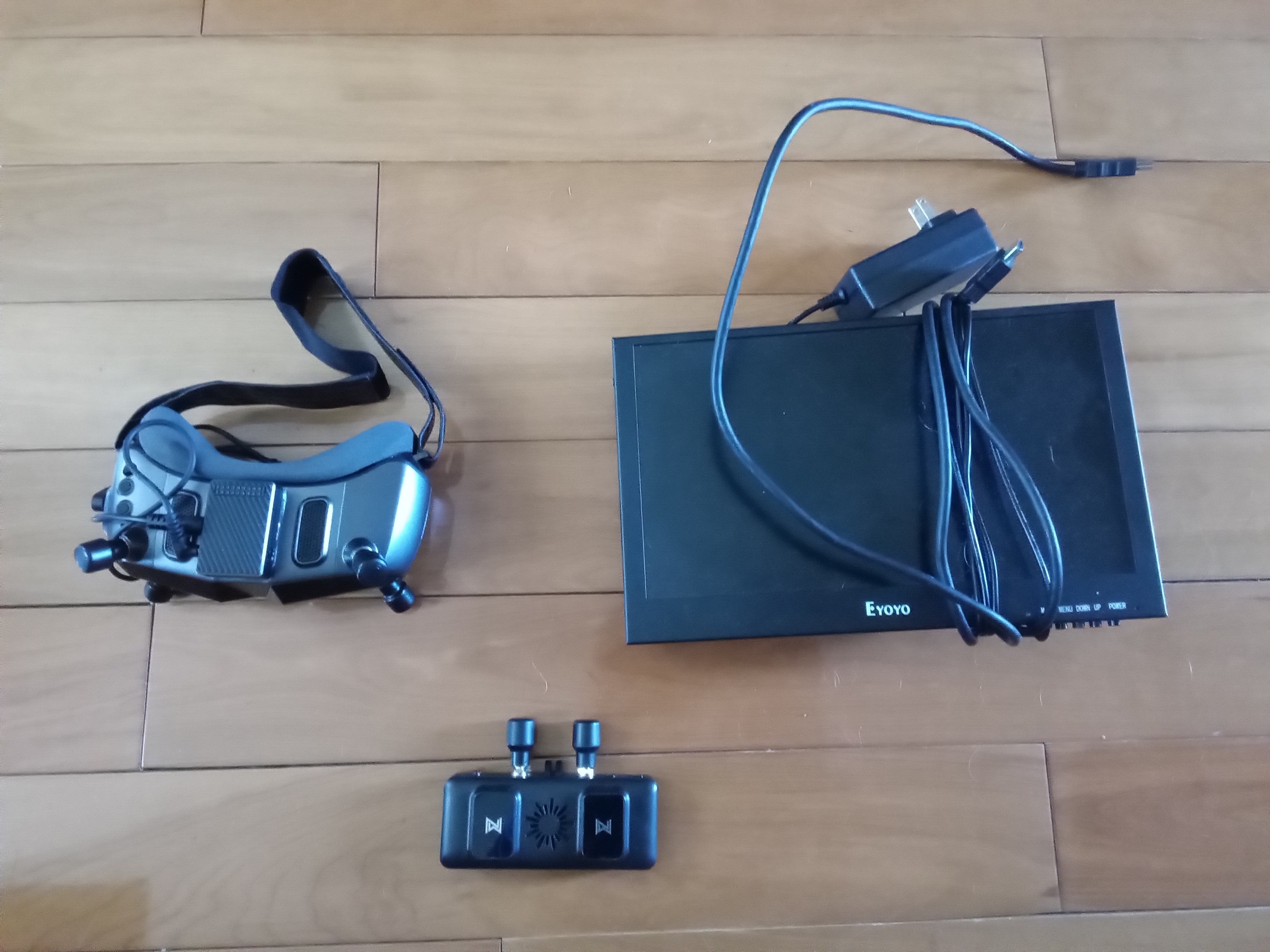

Picured above: 12" passenger screen. Walksnail VRX standalone RX. Walksnail Goggles x
Well the walksnail can do 100fps with some of the camera/transmitter setups. They reduce the resolution to get the framerate up. The goggles support up to100hz. whatever you are using for a display must support it, or you will end up with a blank screen. My 12" "passenger" display and my old Transformer goggles do not support that kind of refresh rate, so I can not demo it for passengers.
So basically they had the walksnail VRX module and hooked it to the HD zero goggles. I have the GogglesX and a VRX. So yeah, I have played with it a small amount. I prefer the higher resolution at 60hz though.
All of the Walksnail gear can do HDMI output. the GogglesX can also do HDMI input
