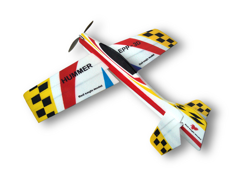

That plane (totally carbon fiber) weighed 12 1/2 lbs. This one about a lb.
As long as properly designed, and you know how to do it, it will fly, this one in gusty wind.
