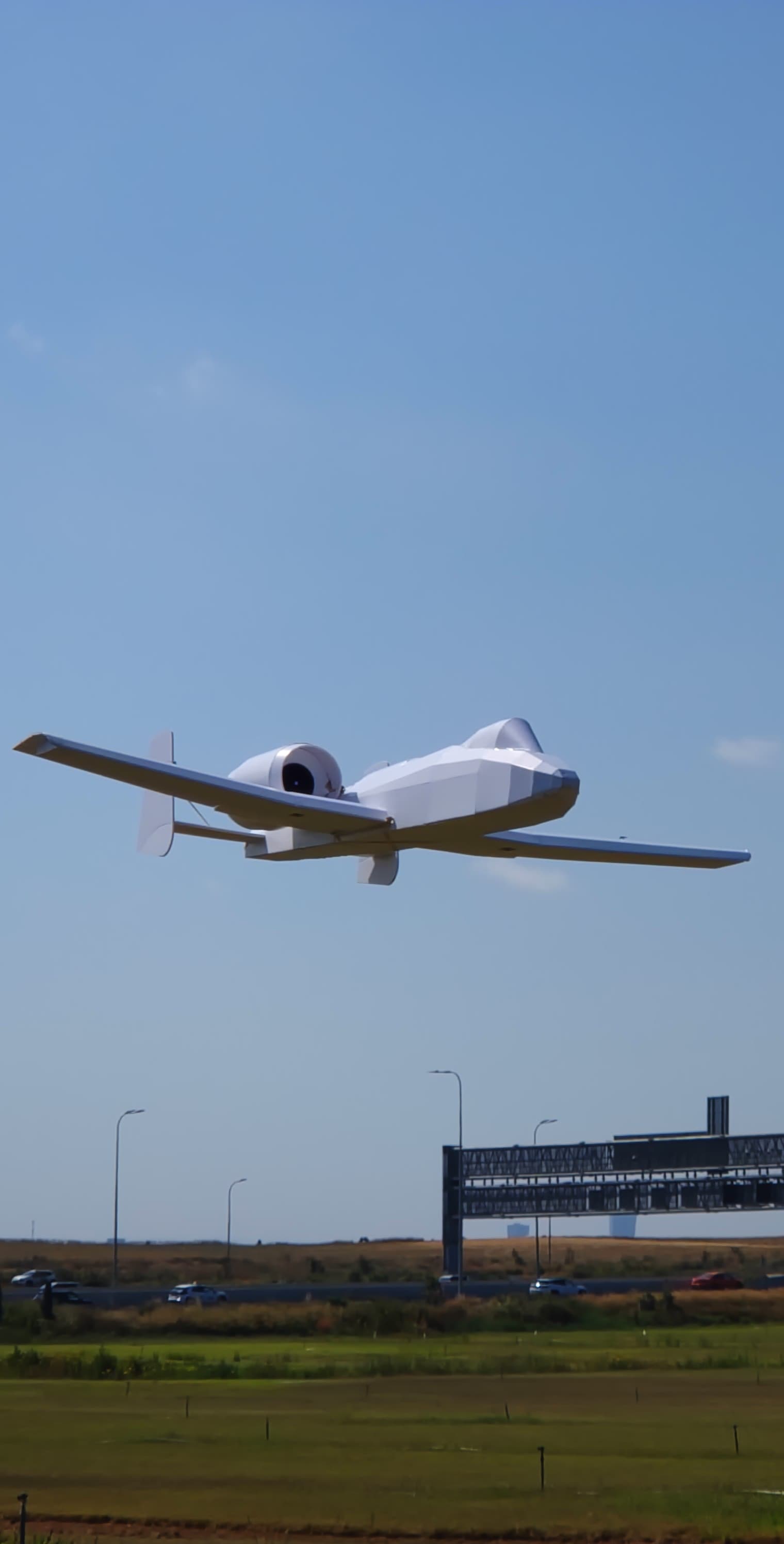

It looks like you put the elevator servo in the original position. If so, and you haven't already, make sure to reinforce the control rod with a coffee stir straw, zip tie, or something. It likes to bend on the EDF version especially at higher speeds.
noam
Ok so I flew it!!!!!
Nice. I've built both the original propeller and EDF version. The EDF is definitely much more fun in my opinion. Mine is a 6s 5000mah setup.
My edf's are rated to 4s and I am running 2x 4s 3000mah, I'm thinking of getting 2x 5000mah as an upgrade.
I used a 1.6mm pushrod and it doesn't bend at all.
