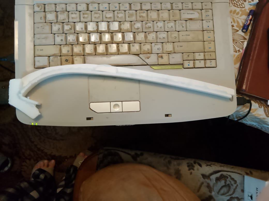

Each of us has encountered a solution to a problem when building a model. I want to share my best practices. To build a curved pattern (for example: wing profile) I cut out a strip of foam and press it to the surface with needles (the assembled wing always has a different curvature than according to the drawing). Next, using a glue gun and foam pieces, I assemble the rigid structure of the pattern. Everything is visible in the photo.

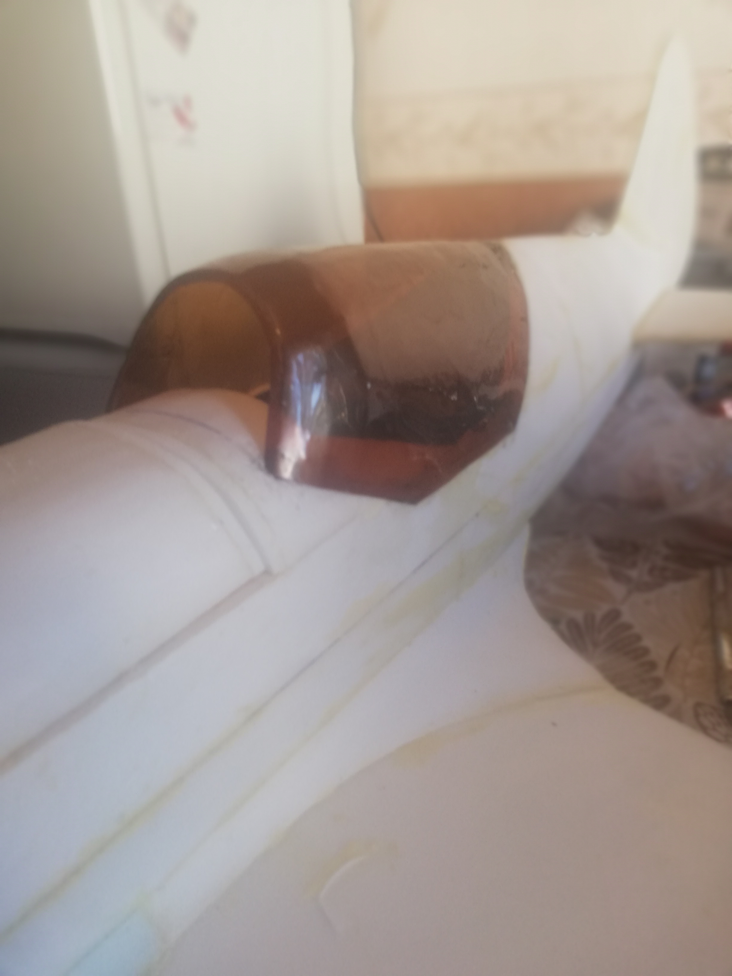

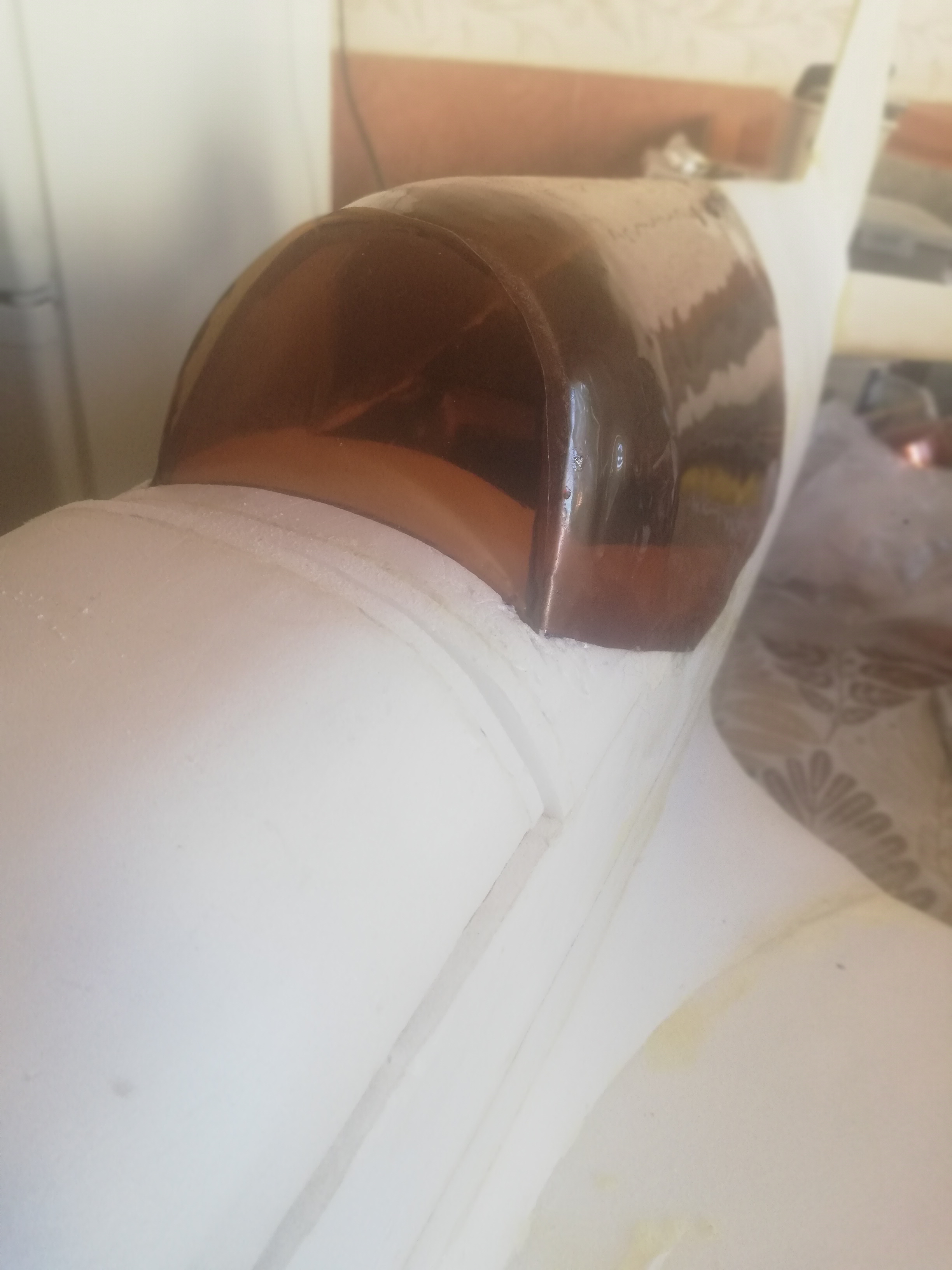

I continue to share my experience .When it is not possible to make a complex shape out of a bottle,
I make several pieces and glue them together into a whole. The photo shows a MIG-3 flashlight.
