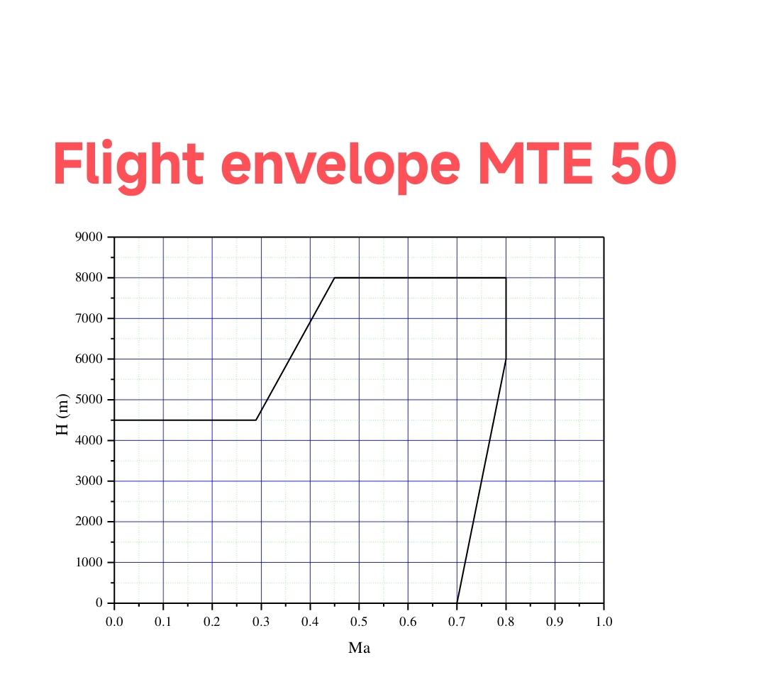

On Sunny day, I fly near touching 16,400 feet (5000 m) but I observed engine flame out, All sensors found In good condition, on third attempt Engine restart . Life saved.
On discussion with expert, following main points result out why engine flame out at such high altitude.
Either violation with following points
1.Low density air.
2.Engine can flame out without any sensor warning ⚠️.
3.Automatic relight often fail due to low density of air.
4.ECU altitude compensation Map vs Ambient Pressure/Low Density of Air.
As engine fuel tank not pressurized .
Flight envelope here.
What are forum friends openion?
Too rich fuel mixture ratio at altitude such that there is too much fuel for ignition Or not an efficient enough spray pattern to ignite. Believe the spray pattern changes to not dispersal shape which may miss the igniter. You can also extinguish a fire with fuel (mostly by cooling) in space, but that is inefficient and only applicable where there is no sufficient oxidizer available in the environment. Traditional engines run until they cannot make a critical horespower to continue acceleration rotation. It will run, but not make adequate thrust to burn available mixture. Egt will indicat near ambient tempratures instead of typical

All turbines even full size have an altitude limit where the lack of oxygen reduces the thrust to the minimum the plane needs to fly although it is usually higher than the relight altitude.
This was exactly what Gary Powers in the U2 suffered over the Soviet Union. Flying at 65,000 feet and power limited to flying just a few knots above the stall speed he suffered a flame out. To stand a chance of a relight he had to descend to below 60,000 feet where due to the reduced altitude he came within range of a SAM missile.
Each design of model turbine as they have a less efficient compressor then full size will have a specific and much lower relight altitude limit.
