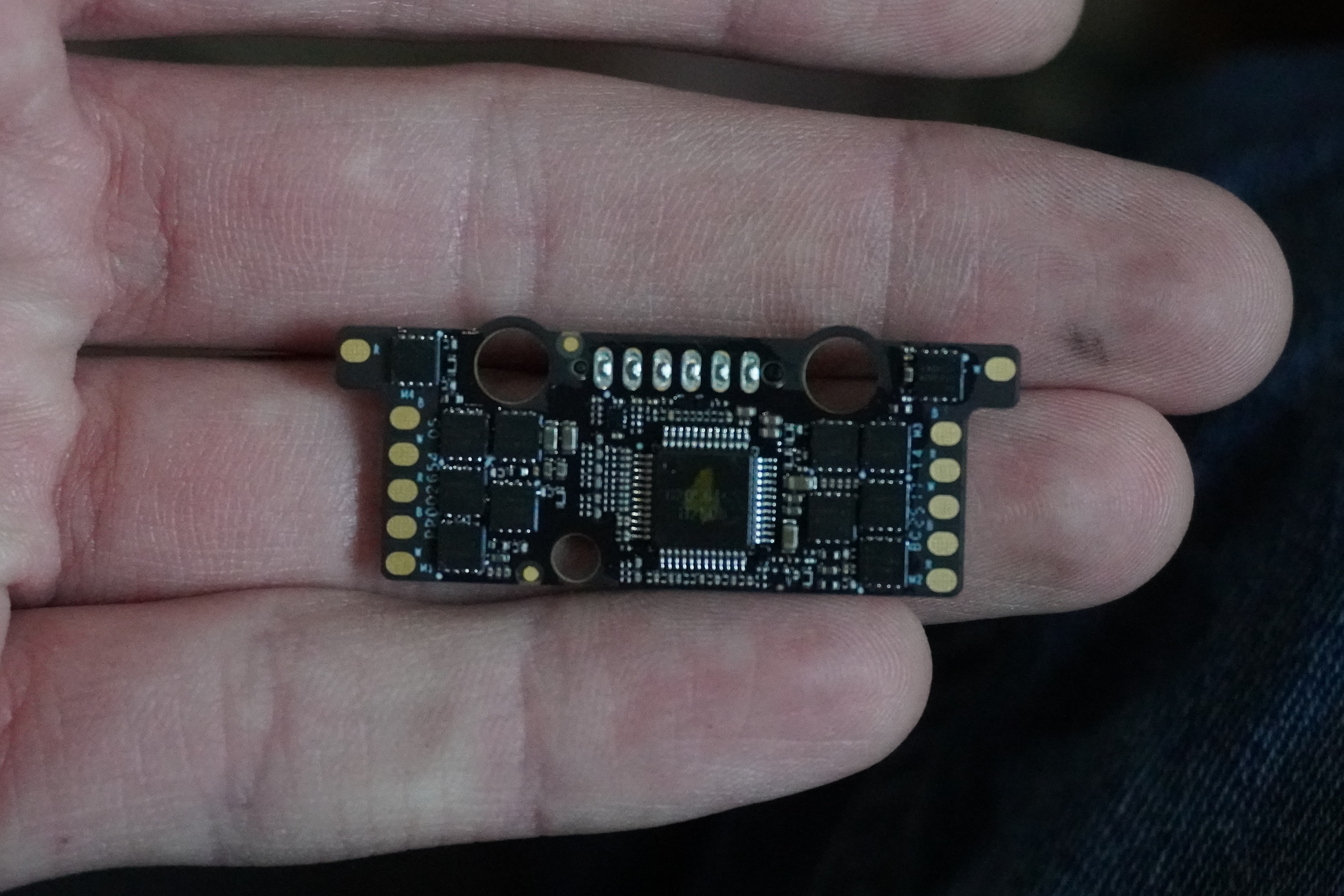

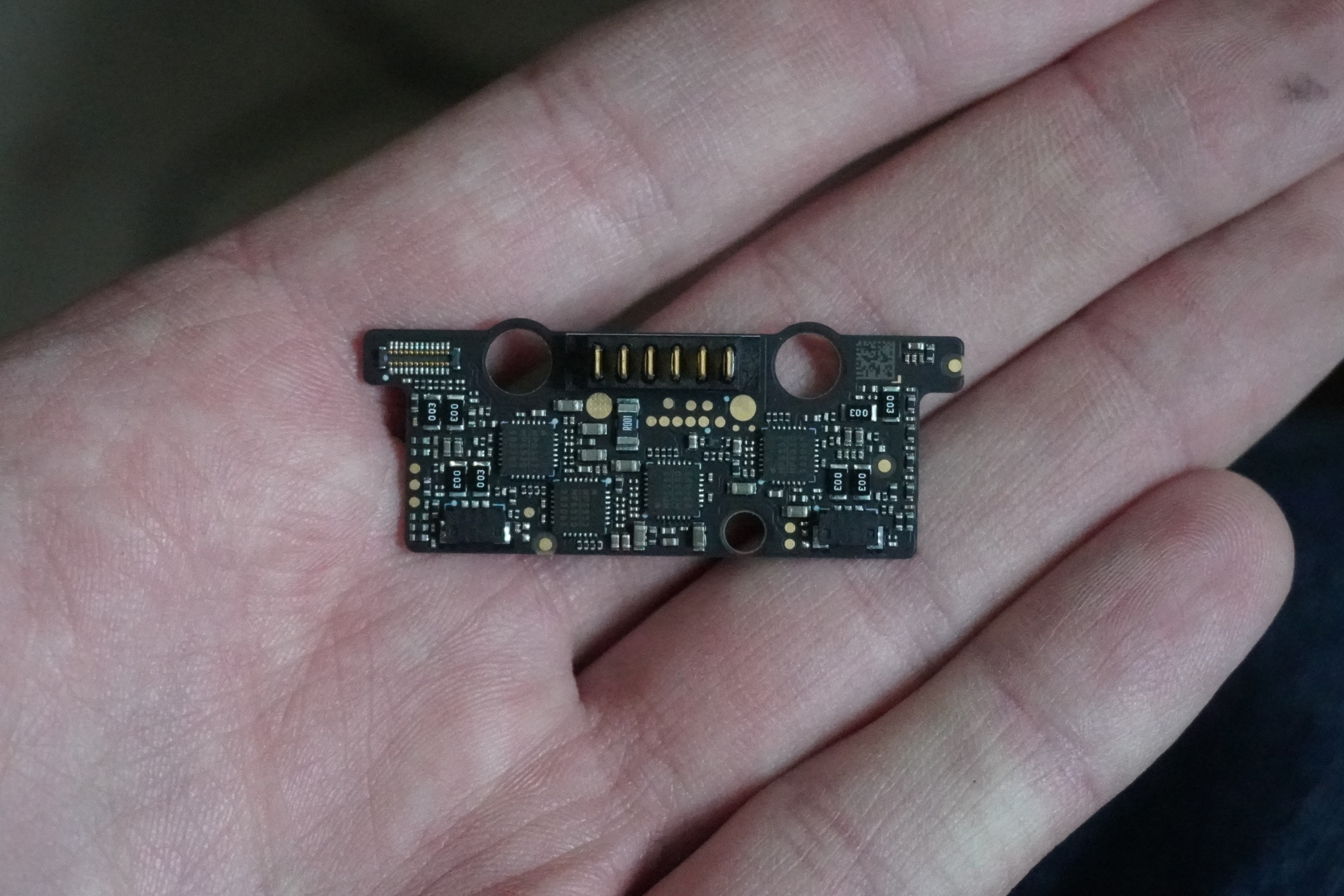

So it might be the ESC module as that's what connects to the battery...Thankfully that's only $20-30! But I hope its not the switch, because that's on the mother board which coats about $150-200😬
Hope it’s the cheap option! (or a free one 😂)
I have a feeling it is😅👍 So to power the drone on you hold down the power button down there are a few LED's on the top and they go in 1 2 3 4 cycle then it powers on...now right now the drone just powers on and one of the lights flash, but I can hold down the power button and it does the 4321 for powering off, so i would think if it was something with the switch is would be frozen to on and you couldn't power it down with the switch.
THANKFULLY the camera and gimbal seem to be fine! With those, dJI actually has a digital code so that only the camera in the drone will work with the motherboard that's in the drone, unless you send it to them and they reset it in the firmware!!🤯 (And good luck sending it to them nowadays with the DJI ban in the US!😆😆)
New ESC in!!
I am kinda thinking that its the ESC - motherboard ribbon cable...I did a continuity reading on the end of one of the ribbon cable..not end to end, just on one end as it has a continuity of 2.4 ohms between so of the pins, which means there must be something messing with the signal between them, which could very well power on the drone and give a batt communication error.
