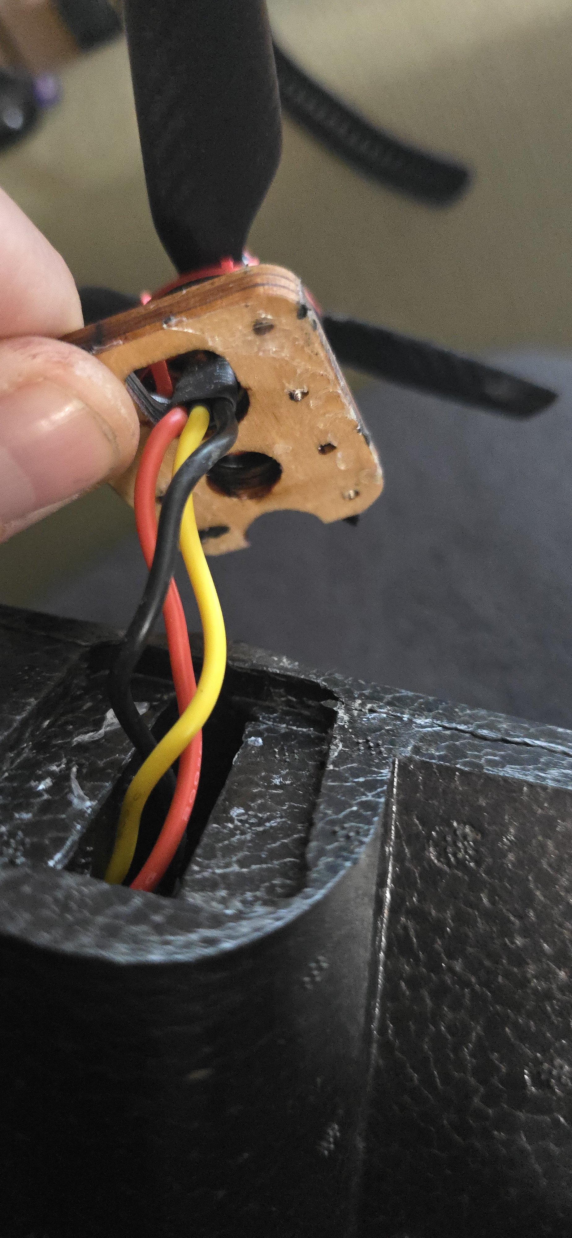

Nope, I too an auto stethoscope and it seems like it coming form the left gimbal motor...So I think there might be a little grit left in there, or if worst comes to worst that motor is only like $30...vs $150 for a new gimbal😬 (Thankfully I don't think the motor are locked with that digital ID thing..pretty that's the camera side of things which seems to be okay)

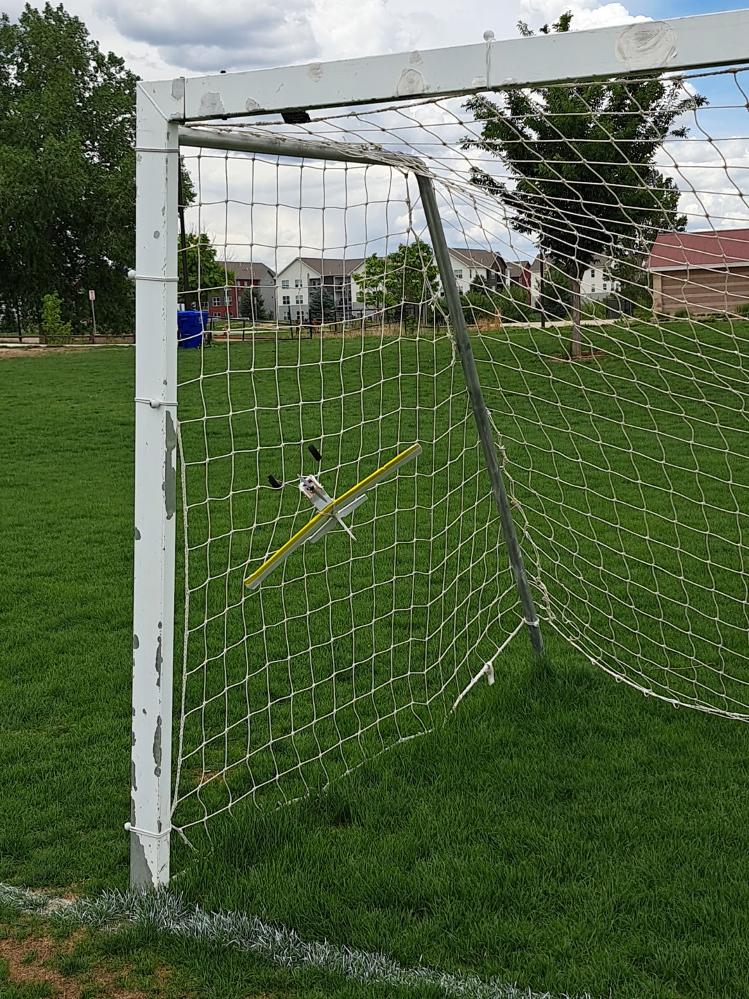

Another clear, nearly windless morning , another broken prop. 😂
Didn't get enough altitude for The Tree to get it.

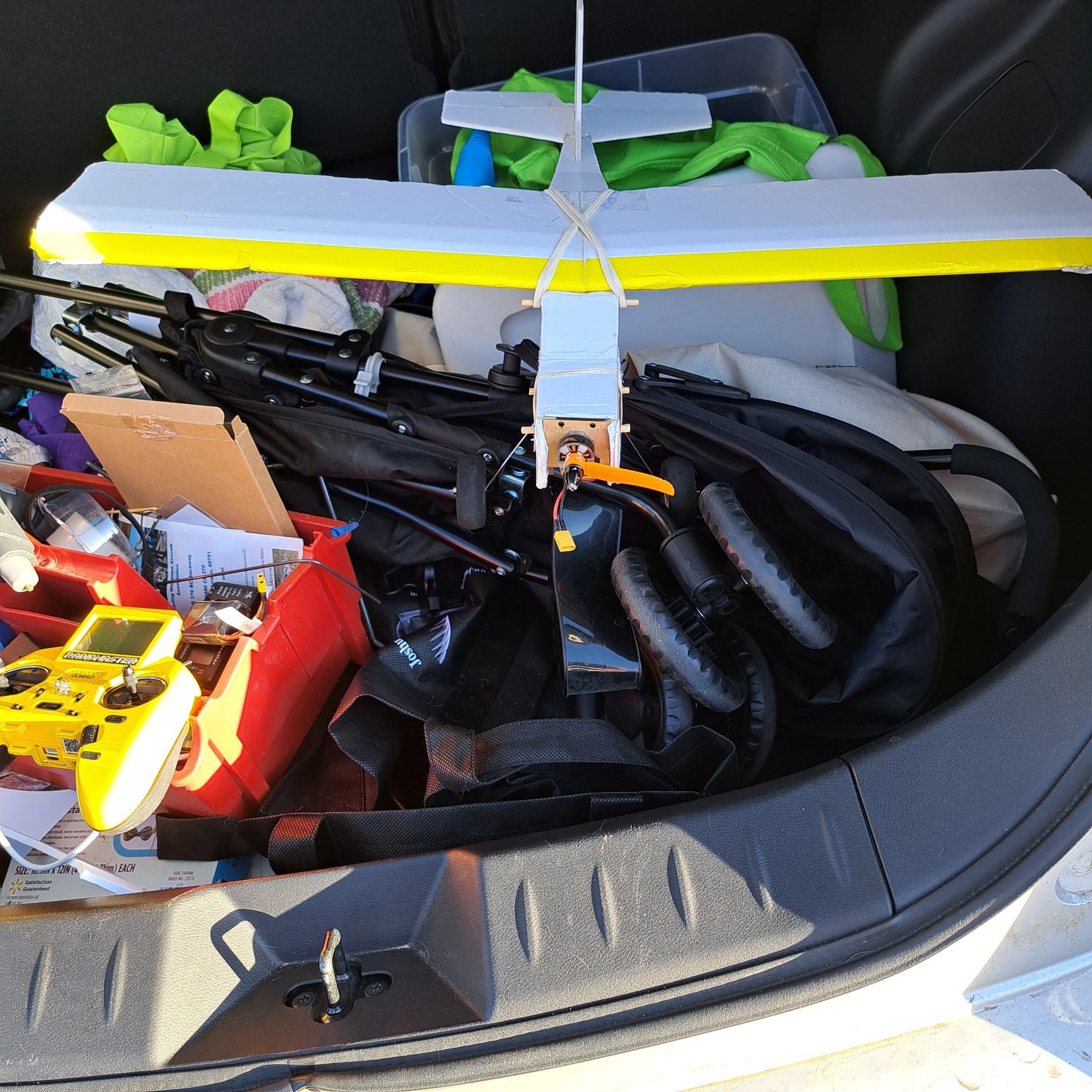

Just the RMRC Recruit. Foam Tac will fix it all. Not sure if it was just me flying without my glasses after flying FPV and loosing orientation, or if one of the servo extensions pulled loose, but I flipped it back into leveling mode, and it still kept spiraling down. Battery tray and one winglet need glued back in, and I am for sure going to put longer servo extensions in. It was a tight reach to the stock FC from the Left Servo. It had to go over/around the PWM RX, and it is VERY plausible that under G loads, the RX popped it out. I put it back up in the air with both winglets removed, and boy, does it need the winglets.
After quite a few landings, the Firewall has not come back out! YAY!

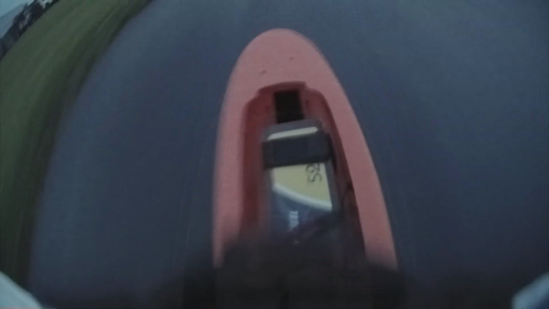

I crashed the HD-FPV/Gimbal pod on my Stratosurfer doing too rough of a bump and go.... This is the view from FPV pod leaving the Stratosurfer before going through the prop, knocking it off. Made sure plane was in leveling mode and took my FPV goggles off in time to watch the plane land itself in the middle of a corral of Longhorns.
