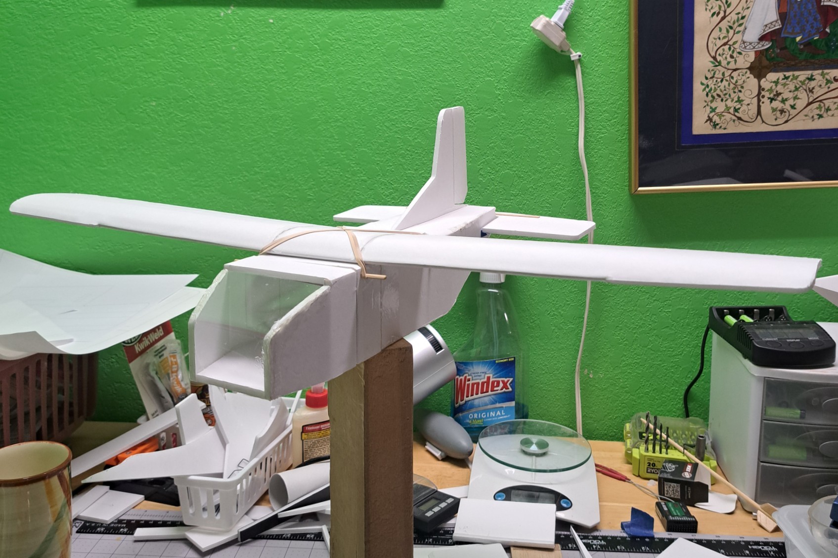

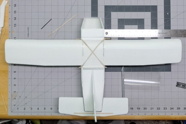

Fresh off the board. No electronics installed yet. I want to do flaps, but have to figure out how.
24" wingspan, 14" long. Wing is removable. The stabilizer is full flying, something I've never tried before. Twin 1306 4000kv motors. Weight, no servos or anything, 76g. Clear nose for a FPV camera.
My buddy just got the first motor mount 3D printed, and it'll have about 600g of thrust on 3s. It will probably be quite happy on 2s, and STOL like crazy on 3s!
I'm hoping I can wrap this up tomorrow. I plan to bring this and another plane to Flitefest.
