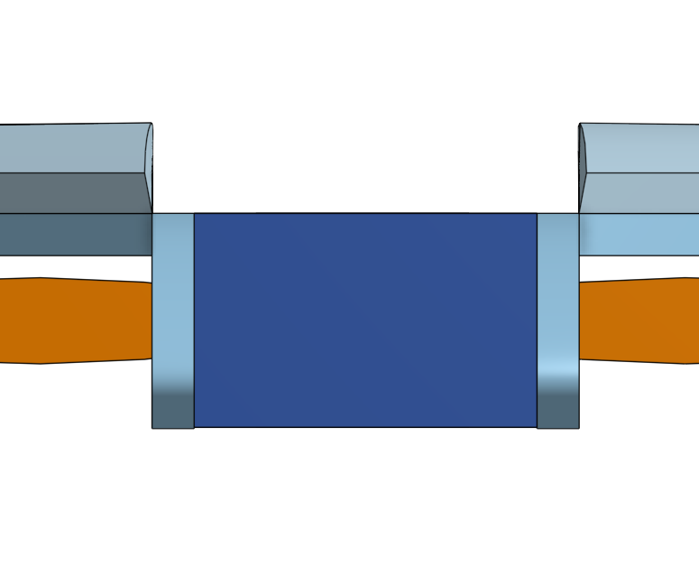

Fresh off the board. No electronics installed yet. I want to do flaps, but have to figure out how.
24" wingspan, 14" long. Wing is removable. The stabilizer is full flying, something I've never tried before. Twin 1306 4000kv motors. Weight, no servos or anything, 76g. Clear nose for a FPV camera.
My buddy just got the first motor mount 3D printed, and it'll have about 600g of thrust on 3s. It will probably be quite happy on 2s, and STOL like crazy on 3s!
I'm hoping I can wrap this up tomorrow. I plan to bring this and another plane to Flitefest.

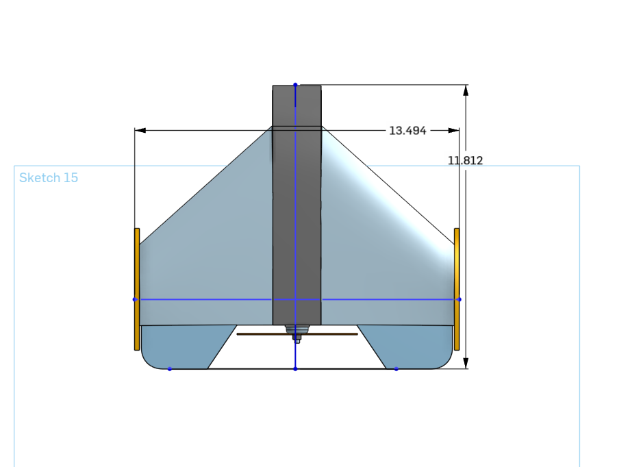

Hmm, only a 15” wingspan? I think the plane might spin instead of the prop😂. I think that;s about the same wingspan as a Eachine mini warbird, but not entirely sure.
The tiny flying wing in the Pic I dubbed Fruit Bat, as it rather resembled one.
It flew indoors on 1s with a 5" prop, and a 1106 motor. I think the wingspan was 12". It was very sensitive to the throttle, wanting to torque-turn and it would loop with too much throttle. I had to bend the winglets to the right to counter the torque.
