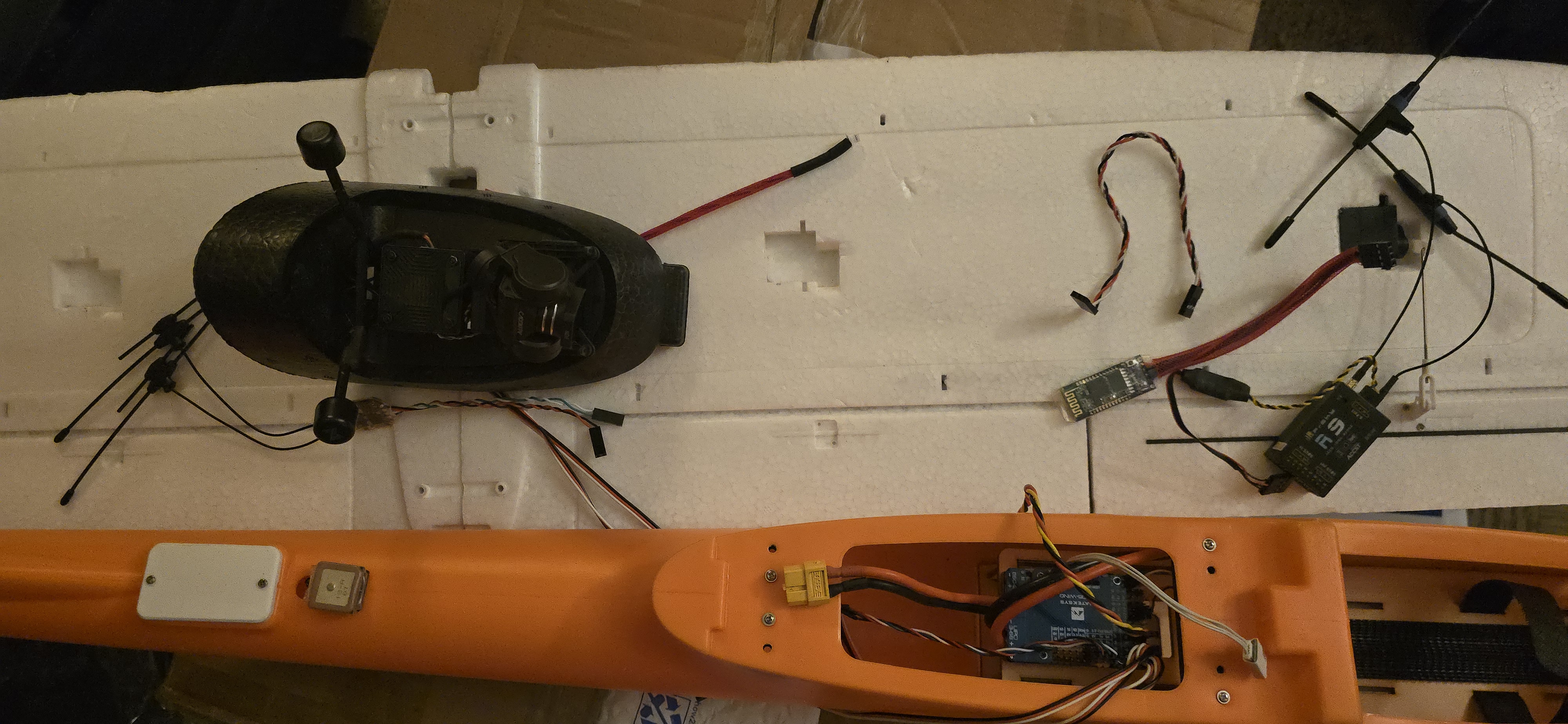

In the process of updating the Stratosurfer to the latest ArduPilot Plane release, switching from FrSky R9 to ELRS Gemini RX, removing bluetooth (or maybe moving it to a different serial port), and finally hooking up the headtracking setup. Old R9 and Bluetooth on the Right. Technically can be replaced by just the ELRS RX on the left Partially obscured by the FPV pod. ELRS Backpack Wifi can be set up to connect to the plane through your TX/RX connection. No wires needed between the TX and tablet/phone/PC. ELRS Backpack is something I am playing with and have working, but doing more reliability testing before enabling it on this plane. ELRS Gemini is Simultaneous Dual-Band (900/2.4Ghz) Capable. It can also run single frequency 900 or 2.4ghz mode.
