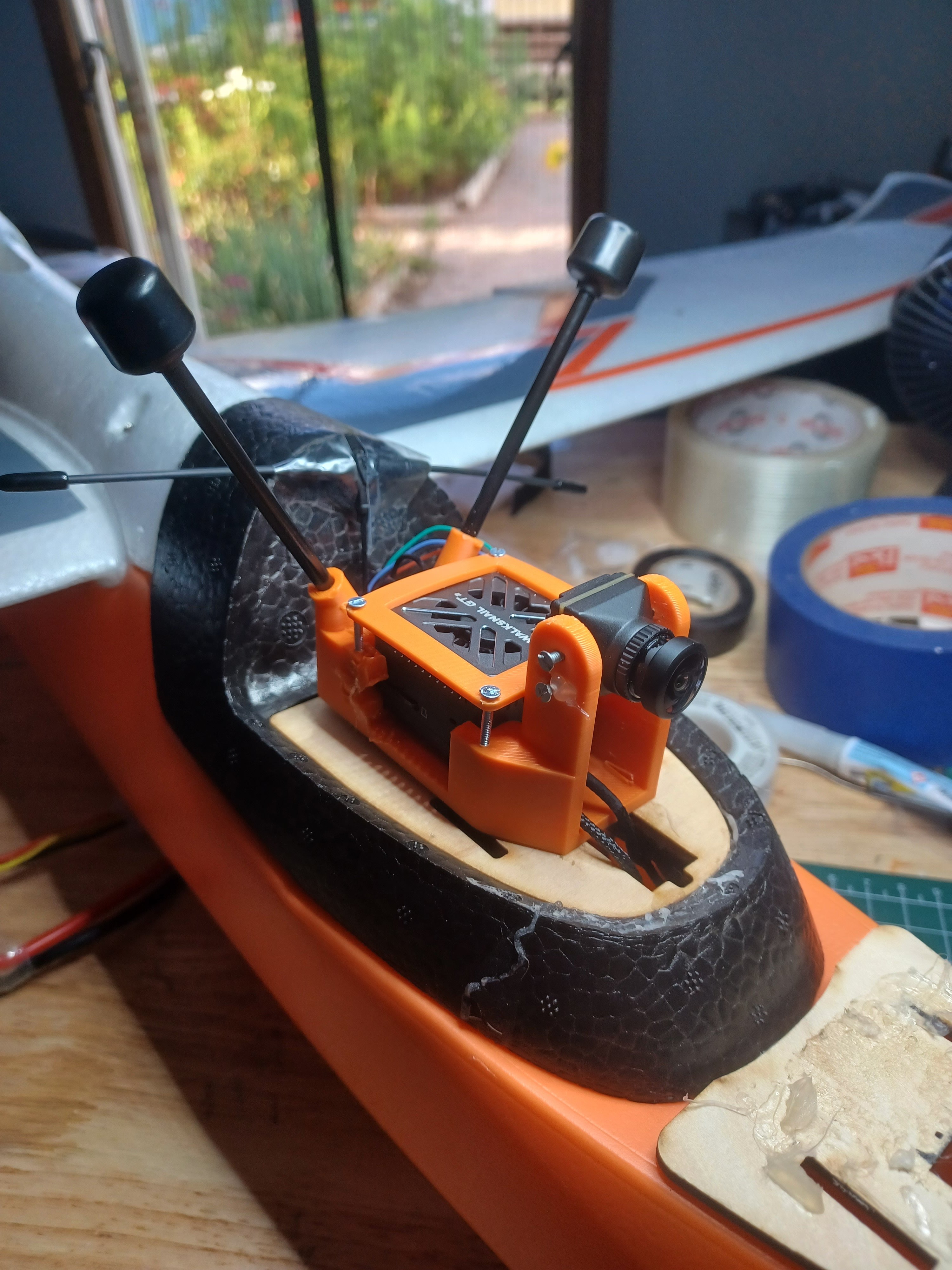

Wondering why my vtx has been disconnecting even when close by I made a couple of adjustments and tried again. I made sure the antenna was connected firmly to the vtx, then I straightened the antenna cable from it's tightly bent position and taped the antenna upside-down onto the outside fuselage. I don't know if this is what made the difference, but it performed well this morning at 330mw and 1km distance. It was a nice flight.
