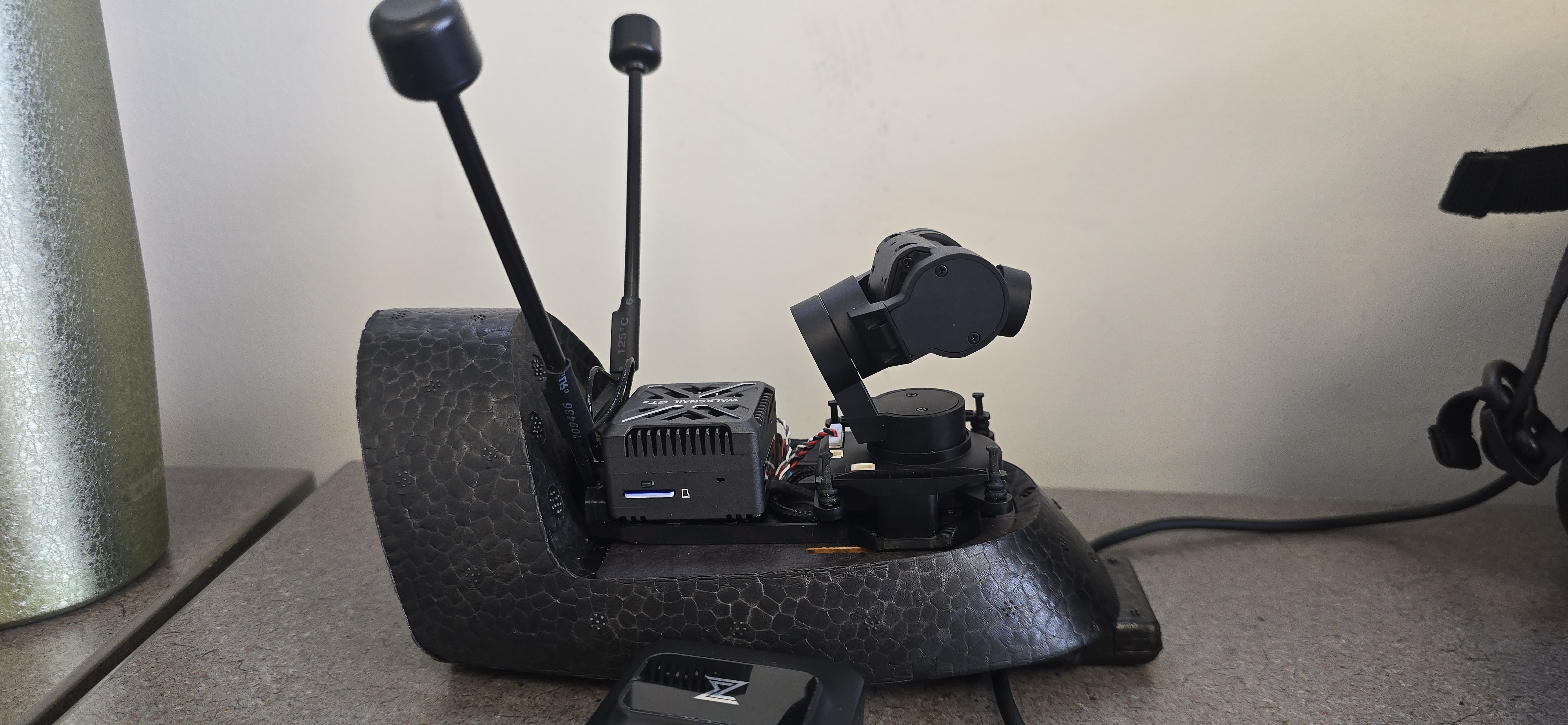

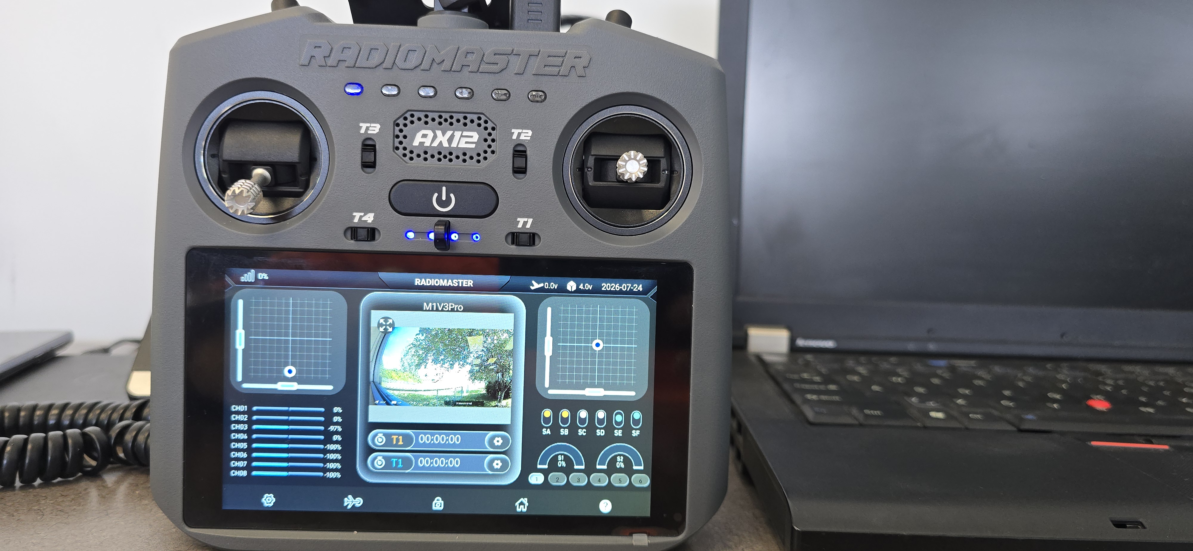

Was updating the firmware on my new FPV setup with the GT2 and GM3 V2. Been playing with the Radiomaster AX12 at work too with my Walksnail VRX hooked up. Video feed in the center can be enlarged to full screen by clicking the upper left corner of the image.
I have both the Walksnail VRX and GogglesX. My range varies by the direction I fly and how many tree lines I fly behind. I have not yet flown the GT2 to see what it does for penetration. I have a bunch of different antennas to test too. Generally speaking, I will get better range from the VRX up on a pole than I would with the GogglesX due to the obvious better antenna placement. I don't really go out more than a mile where I normally fly and usually don't max out TX power. I can only use the headtracking with the GogglesX. Planning on putting the Moonlight setup back on another FPV pod for the StratoSurfer with just a pan servo like I had originally to do comparison of the cameras and VTXes. Looking for fan options to mount to the Moonlight VTX. The one on the GT2 is great at keeping that TX cool on the ground. Wonder if it will bolt up directly to the ML.
