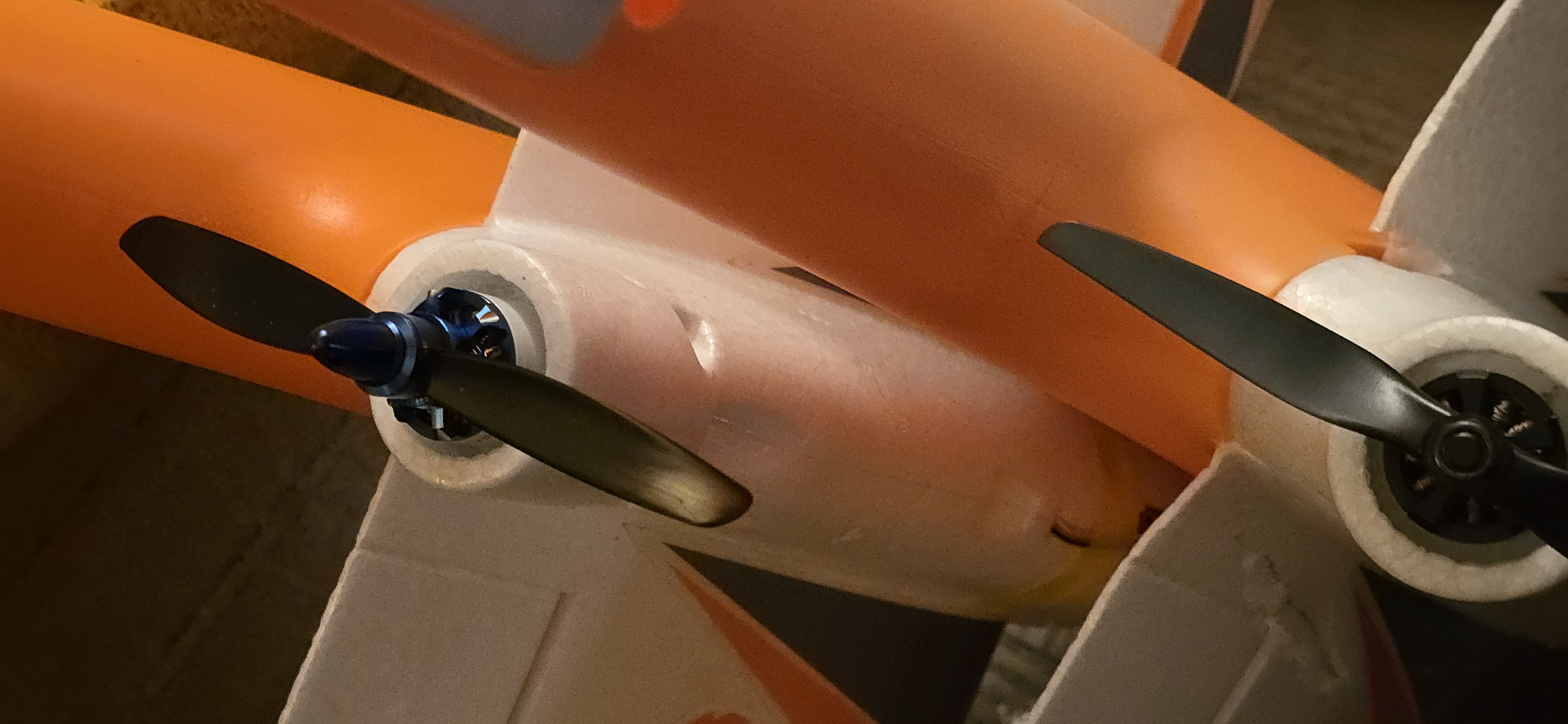

Any of you Stratosurfer people deal with this. My motor is tightly screwed to its mount, but the mount, which is slipped into a slot and screwed there with one screw, has loosened. I've been on many flights, but noticed recently that the propeller is striking the fuselage due to the looseness. The screw is tight. Any engineering tips to fix this. I put in some foam board spacers to keep the motor from drooping, but then it occurred t me that the rotating motor might have a friction/heat problem (the spacers aren't tight, but they are lightly touching). I'll ground test as soon as I can get out. First photo you can see the clipped props and the fuselage gouge. Second picture shows my dubious solution.

I have one power pod that the motor/mount will not come out. I think I used glue. 🤣. But I don't recall having a prop strike the boom before. What size prop are you using?? I don't venture above 6".
Barely a scratch on my original in the front.... Nothing in the back. I'd make a new pod for it.... except they are out...
I probably glued the internal plastic piece too well when building the new pod for my original after it did a failsafe on launch

Thanks for the ideas. I'll try some glue again. I think I tried it once, but I didn't get the job done right. I didn't think of a replacement motor pod. Of course it's out of stock :(, but I'll get it on the list. I'm in the process of buying the Crossfire Nano Module, the Crossfire Diversity pro rx, and the Avatar GT2 Kit. . I guess I'll need a larger battery, too. I want to be able to go a few more miles. I just need to get the Stratosurfer airworthy again. Thanks again for your suggestions. (I hope you had a great time at FliteFest.)

Thanks for this I ended up pulling the motor (the entire mount came with it) out of the pod. Then I glued it back in. It's solid now and working well in the sky. But I'll be cutting it out when it needs to be replaced. I'll need the motor mount and pod. :)
