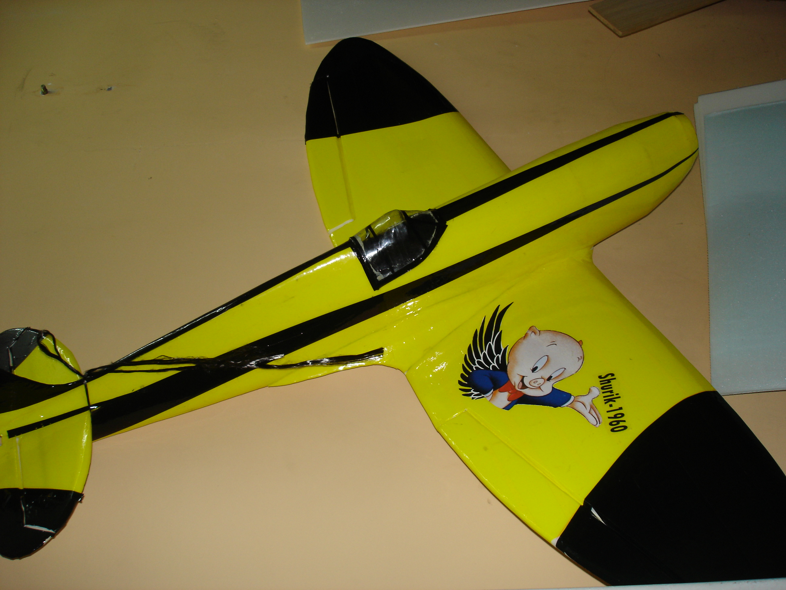

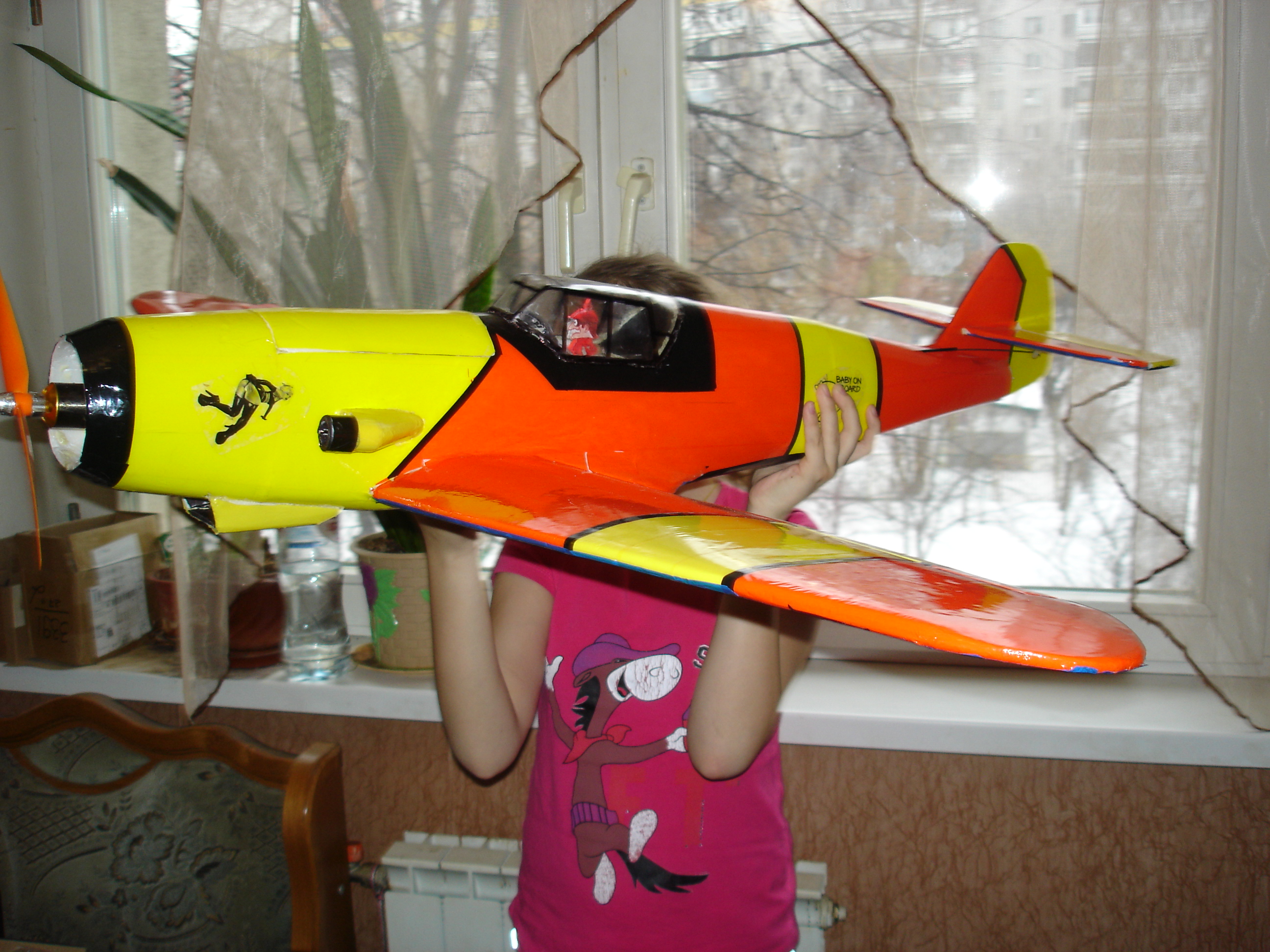

Shurik-1960
For 10 years I have been making models out of foam and for all 10 years I have been covering models with colored tape with an iron: it is beautiful and increases strength!

Shurik-1960
I just bought a small iron and picked up the temperature on pieces of foam when the tape is welded and does not melt.I have been using it for 12 years.Try to break the painted foam and foam covered with adhesive tape with an iron - this is heaven and earth!!!
