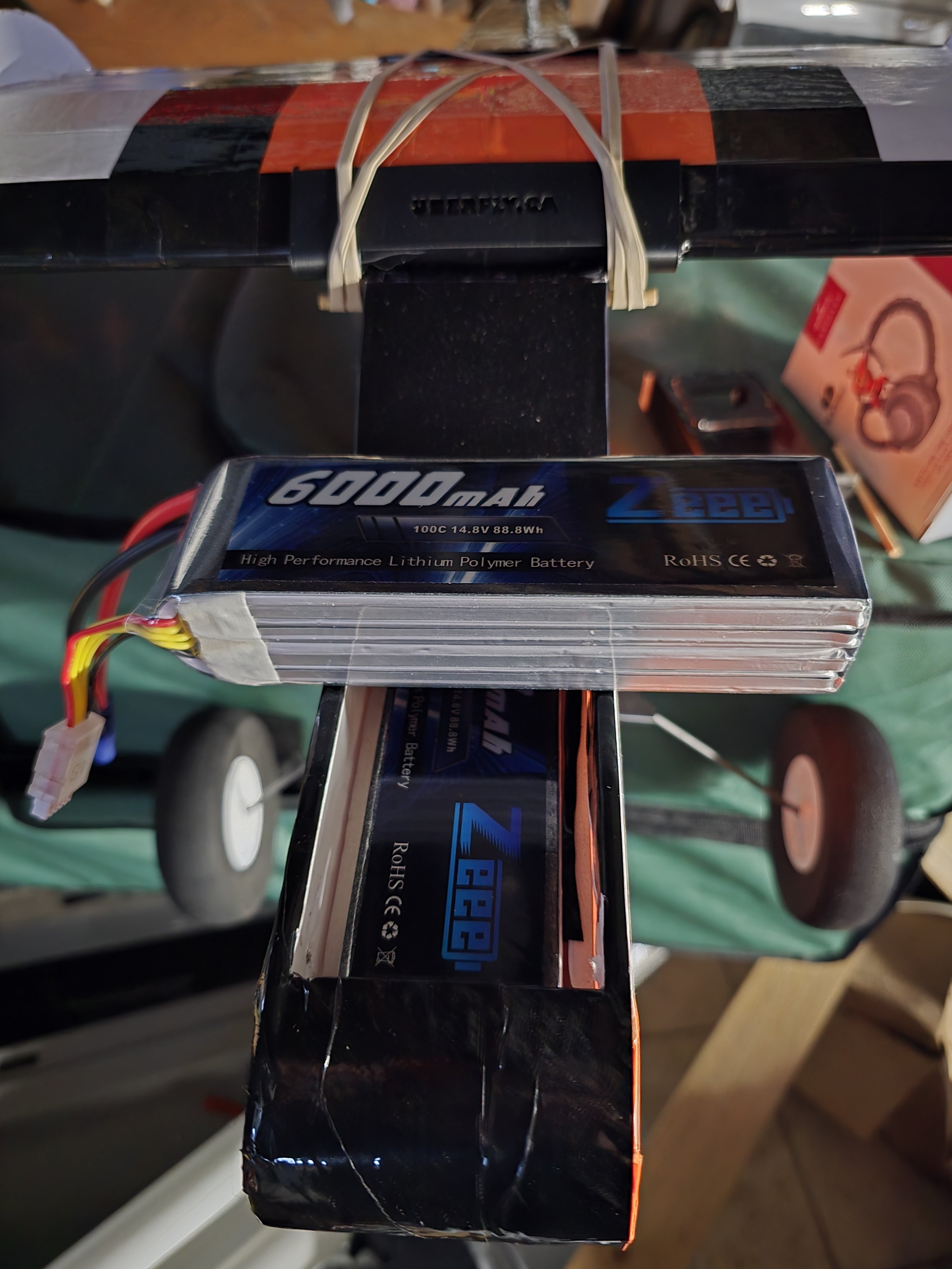

SEEBO

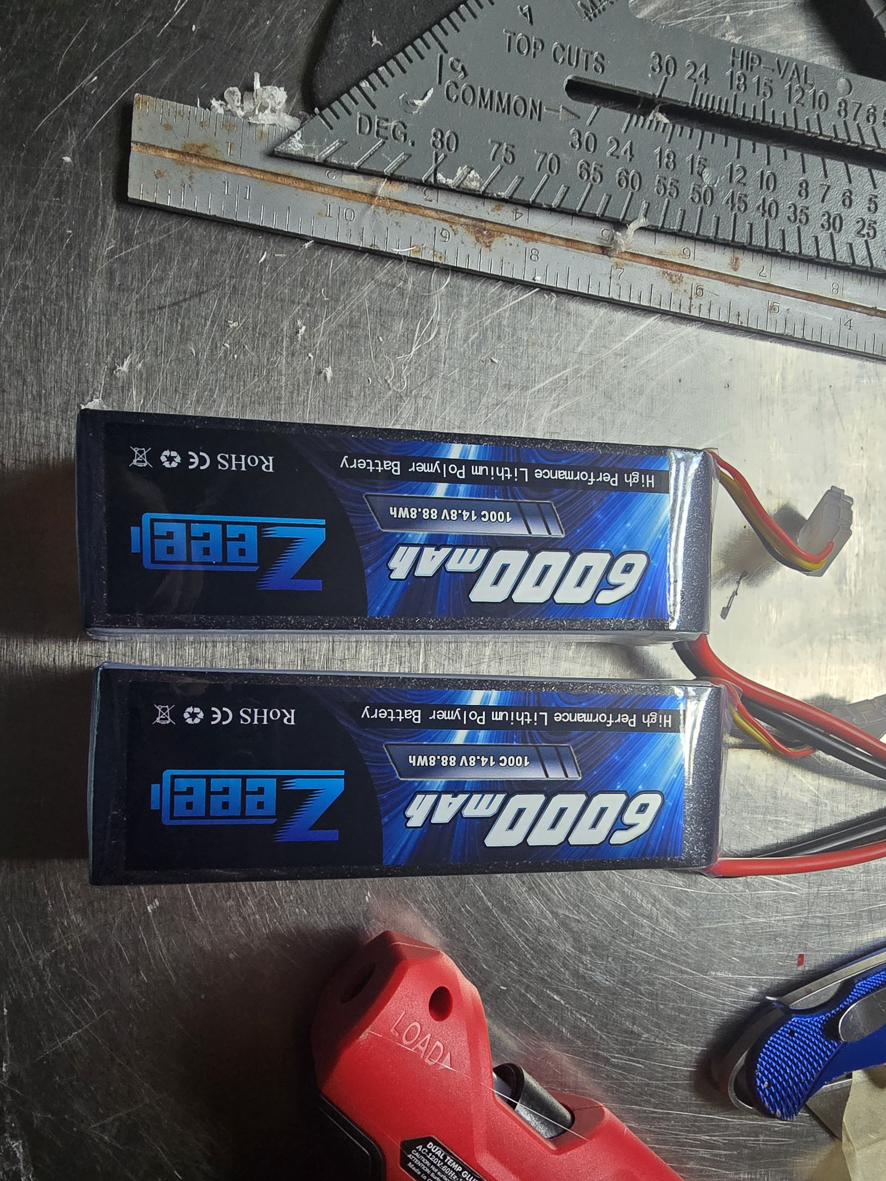

I realize this is an old thread but was there ever a consensus on the best way to balance a twin engine Legacy? I have two 4s 2200 batteries all the way forward in the nose and get a good balance but I cant actually mount them in there due to lack of space. The two batteries together weigh a little over 19oz so I'm thinking I can make a Zeee 4s 6000mah battery work well as its an appropriate dimension and 22oz so I'll be able to mount it just slightly rearward to allow some crumple zone in the nose to protect the battery in a worst case scenario. Any thoughts on that theory? I feel as though a twin engine Legacy has plenty of power/lift to get that brick of a battery airborne.

Took a chance and it paid off! Perfect CG, Perfect fit and hopefully a very long run time. Hated the idea of shoving one of my sturgeon rig weights in the nose.
