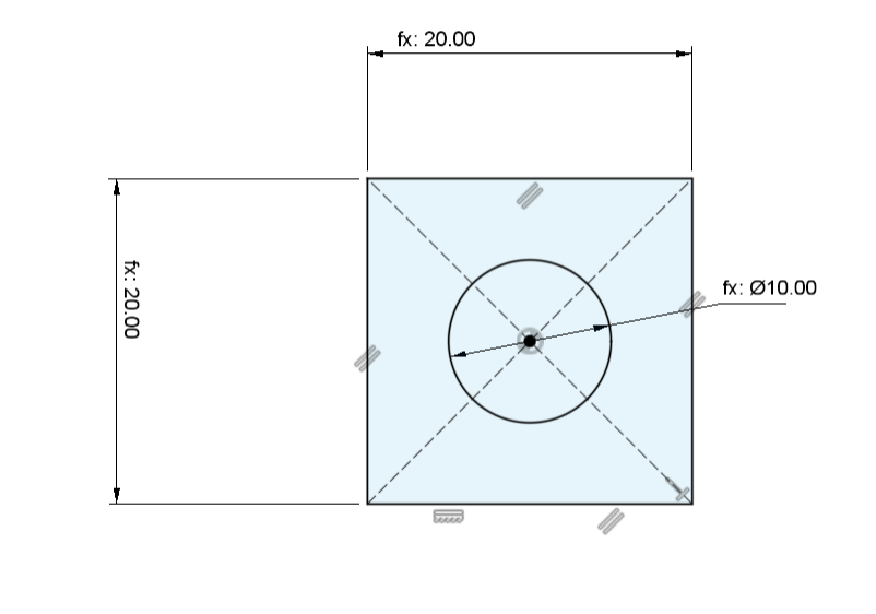

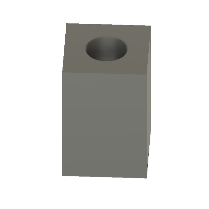

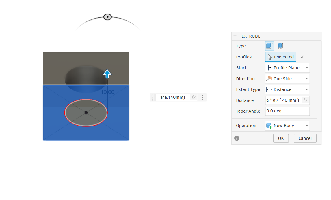

Simple example - your tutorial is 16 steps long. In Fusion, the same model can be made in 2 steps.
  1. Make sketch
  2. Extrude sketch
I also took the extra step of making all the dimensions base on a parameter (a=20mm). This means I can define any mathematical rule I want to and by changing a single value, the whole model will update based on that. Since the extrude distance is a^2/40 this isn't a simple case of linear scaling which can be useful when you need to deal with lengths that depend on an area. For example, with A=60, the height is much larger compared to the width since the width increases by a factor of 3 and the height by a factor of 9.
