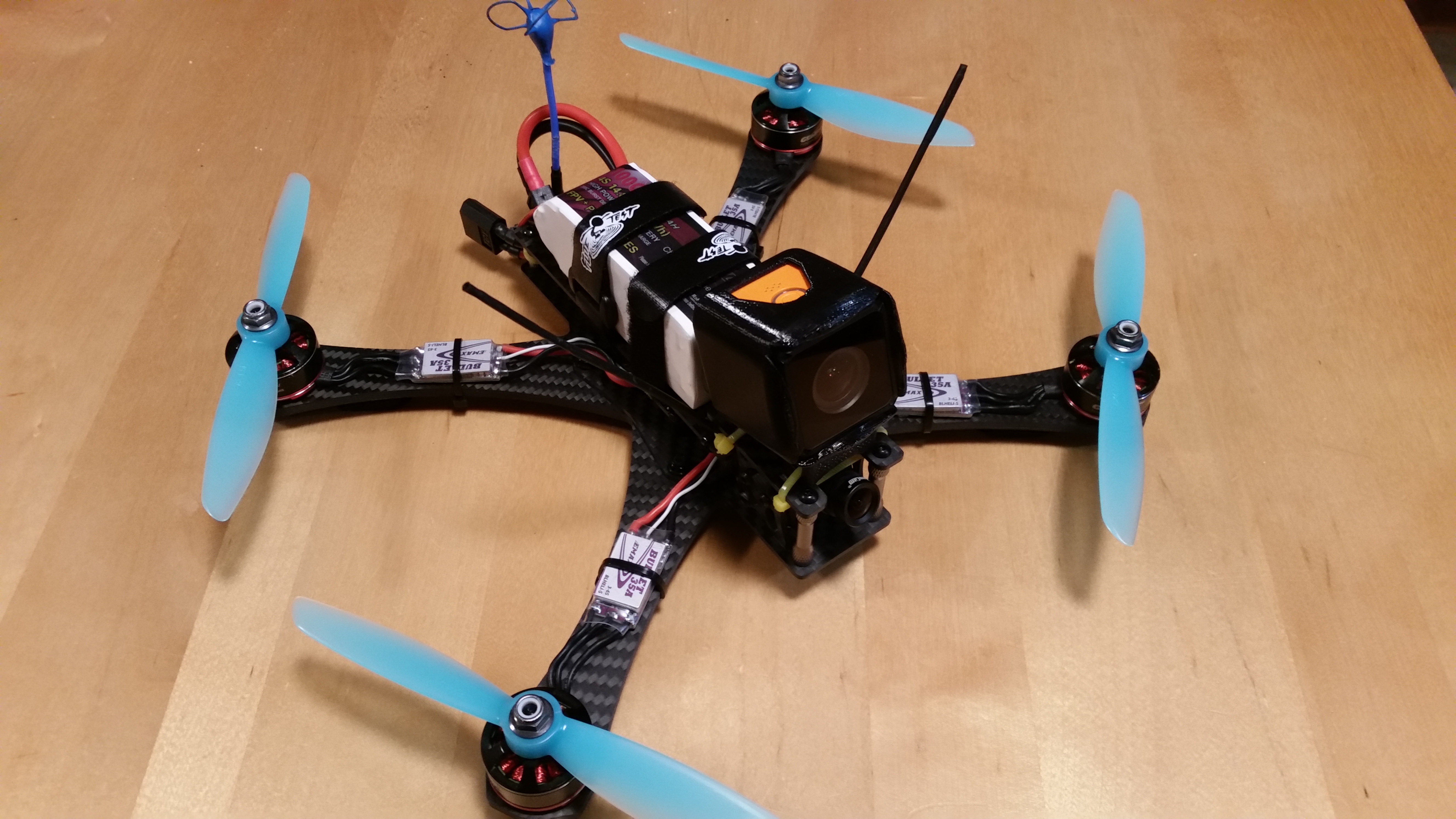

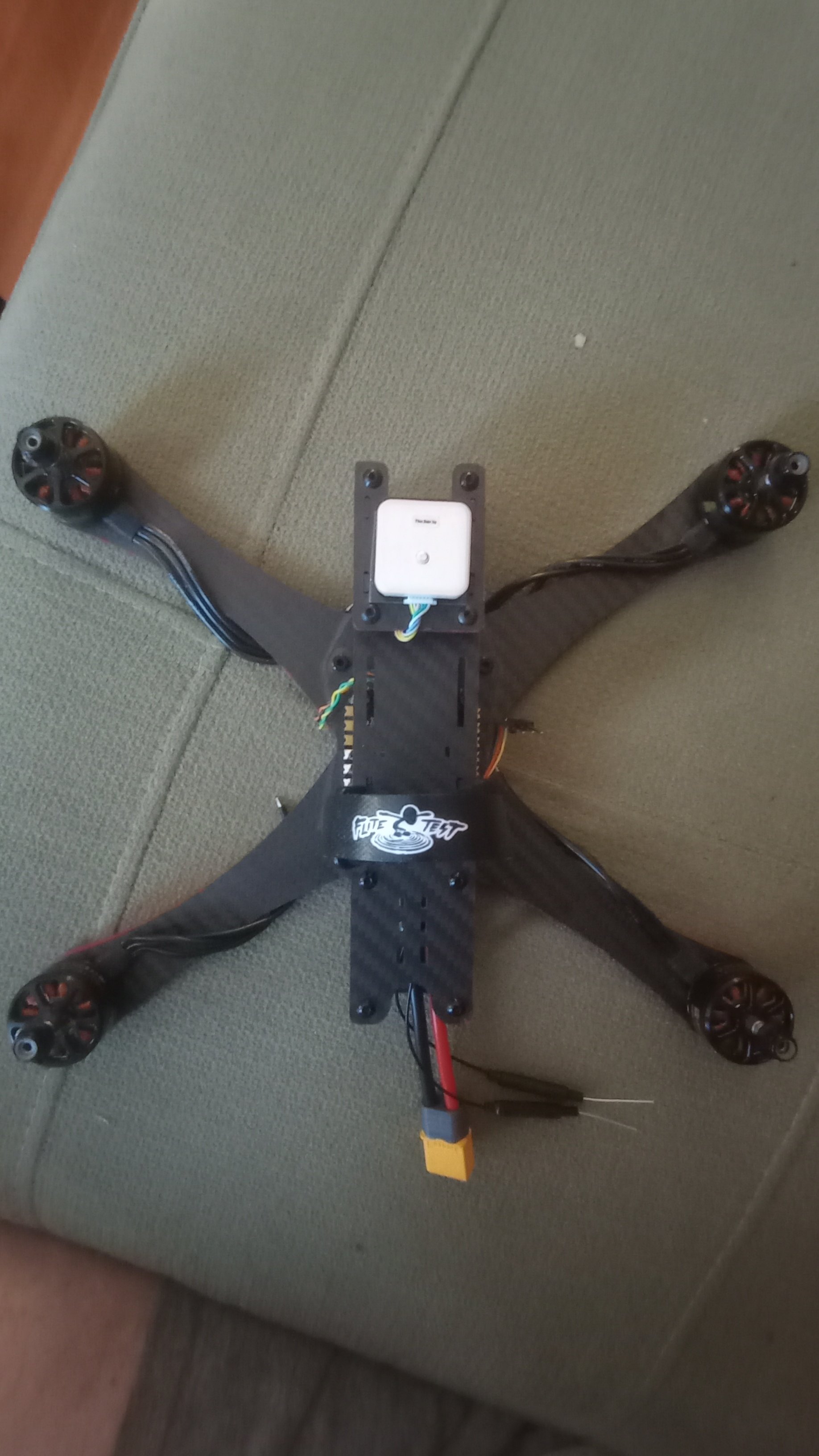

I'm happy with mine. Had it out a couple of times. Seems to be a nice rigid frame. Not as light as some, but I see that as a plus as it adds some robustness and seems to avoid tuning issues I've had on past 6" builds which I attribute to frame flex .
My only request would be that they offer 7" arms as an option/replacement.

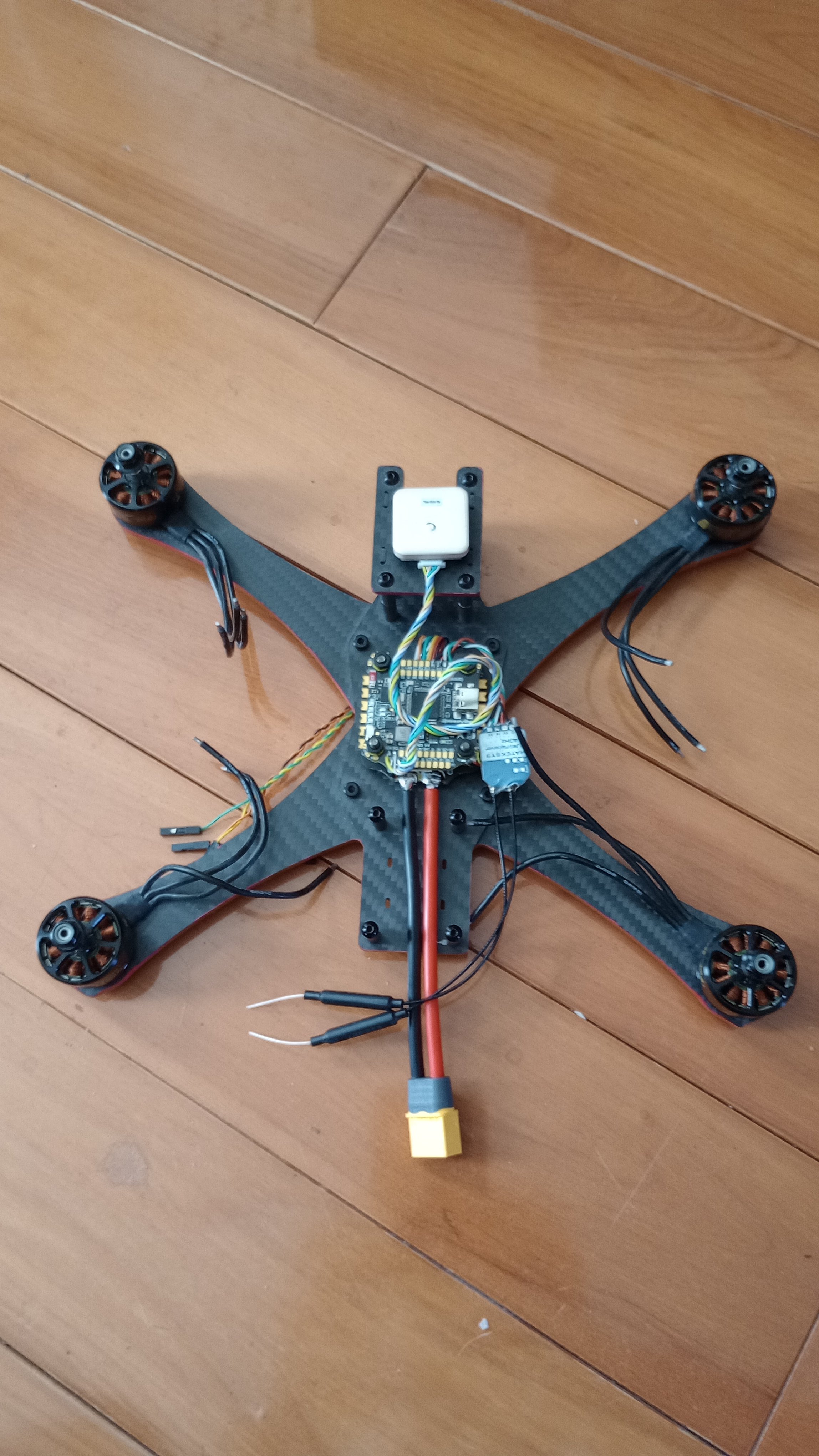

Well.... going to have to revive this thread... cuz I dug my New old FT270 frame and Motors out after picking up a Modern SpeedyBee F405 55A stack. Will be flip flopping firmware from time to time to compare features and flight characteristics between INAV and ArduPilot. Hooking EVERYTHING I possibly can up.
Frame: FT270
FC: SpeedyBee F405 V4
ESC: SpeedyBee 55A 3-6S
Motors: T-Motor F80 1900KV
Props: TBD 6"
RX: Matek R24-D ELRS Diversity
FPV: WalkSnail Avatar Pro V2
GPS: RMRC M9M with Compass
OpticalFlow/Lidar Matek 3901-LOX
LEDS: Bottom of arms.
Beeper: YES
Cheers!

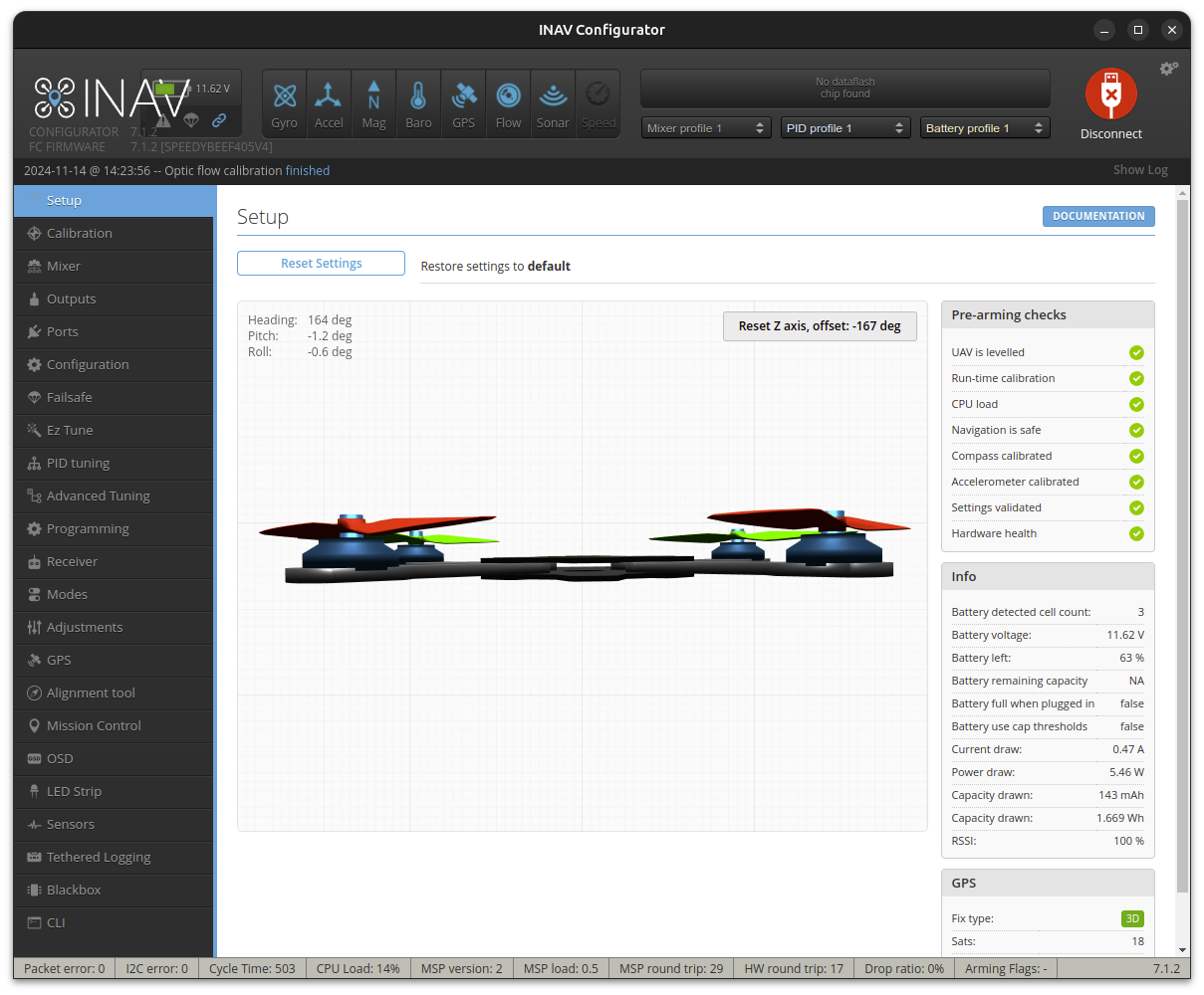

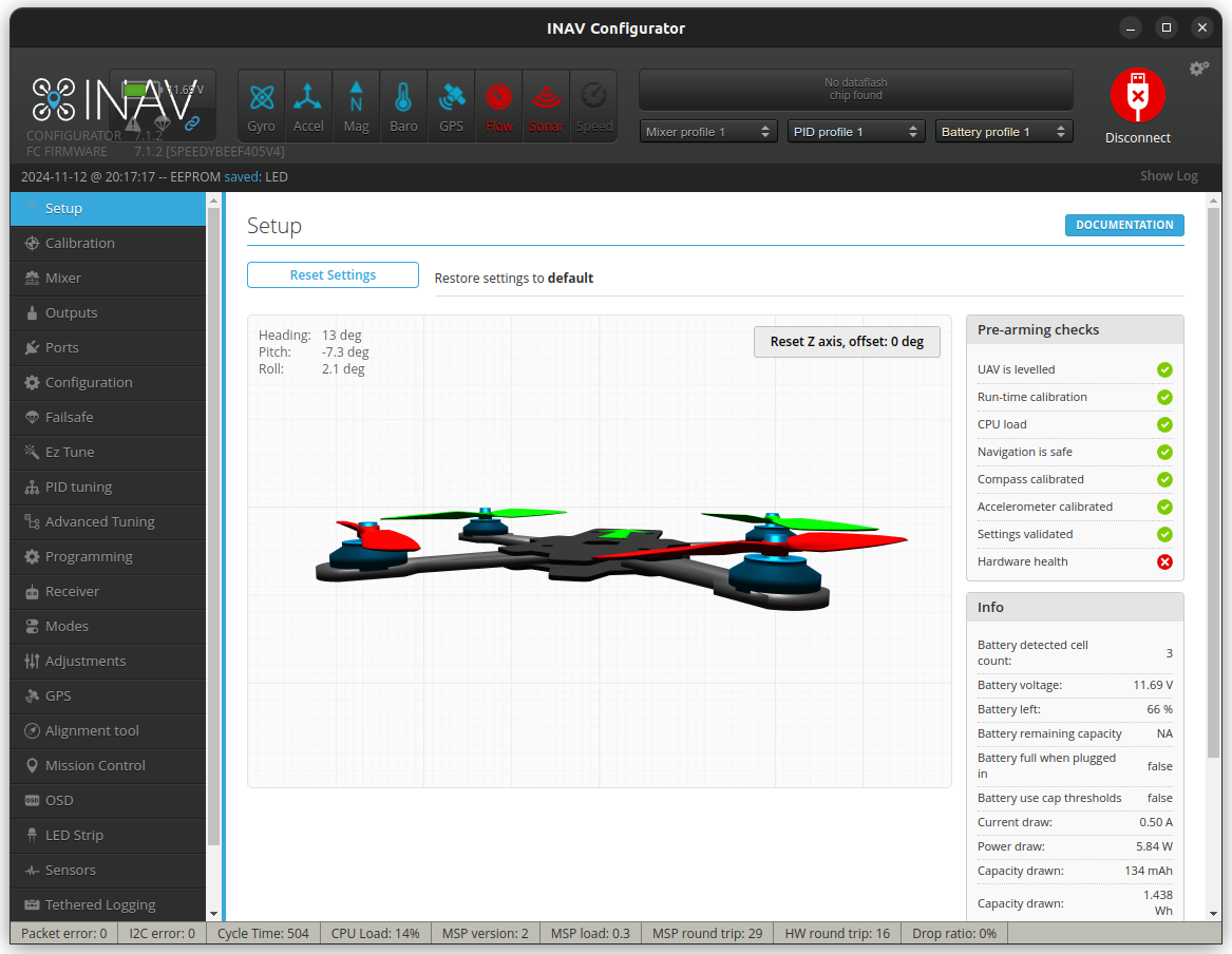

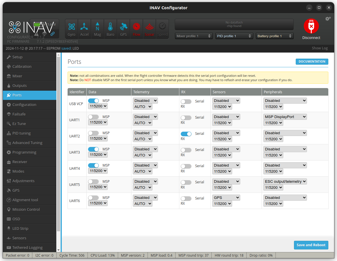

Working on getting everything wired up and tested before final installation into the Frame. Have everything but the Matek Optical flow, beeper, and motors wired and tested.
Serial 1 = OSD serial to FPV
Serial 2 = ELRS
Serial 3 = Matek Optical flow/ Lidar (from what I'm reading, I should just use the baro and GPS for altitude)
Serial 4 = FC wireless/bluetooth config
Serial 5 = reserved for ESC telemetry (not used, using bidirectional Dshot)
Serial 6 = GPS

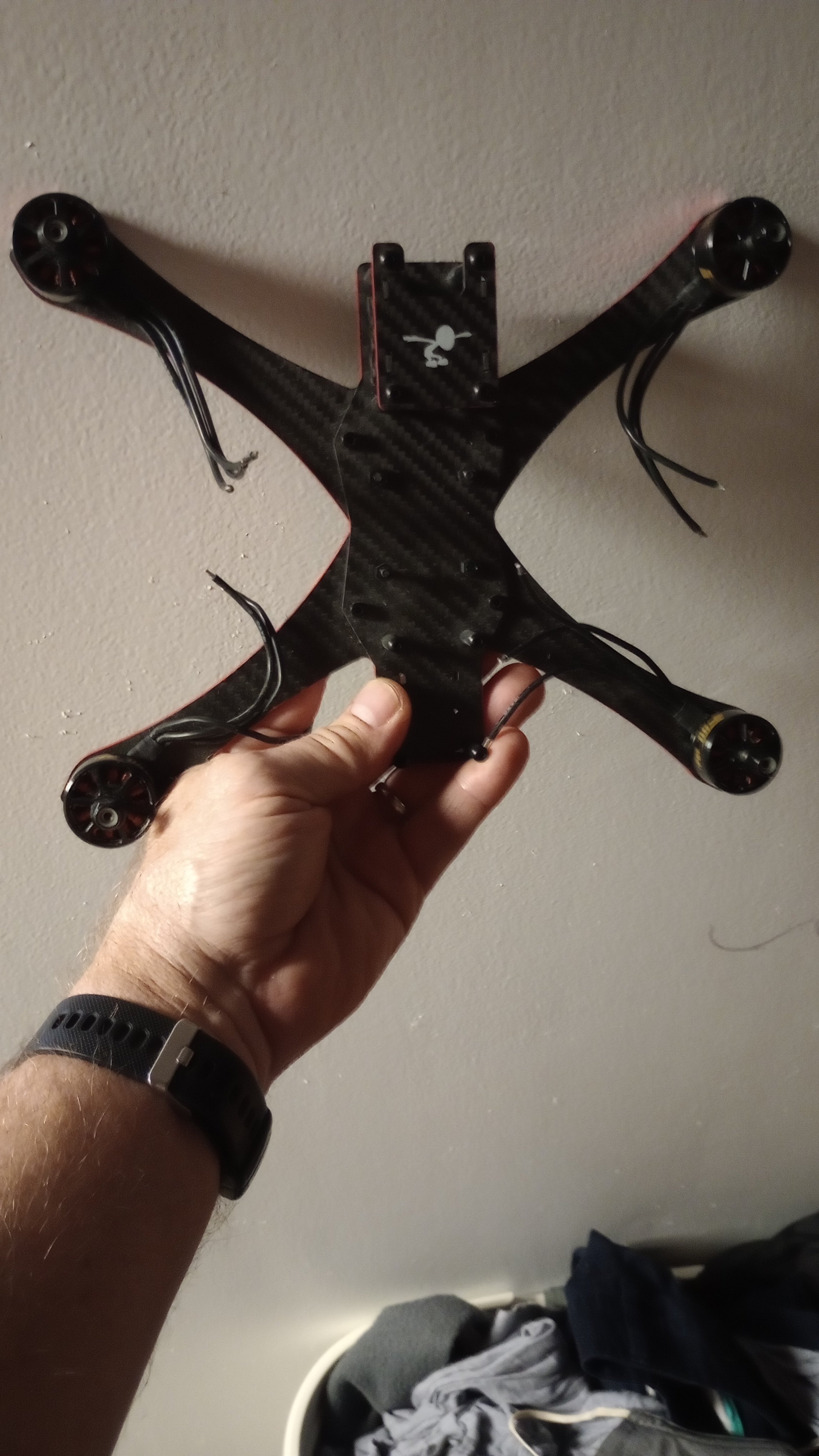

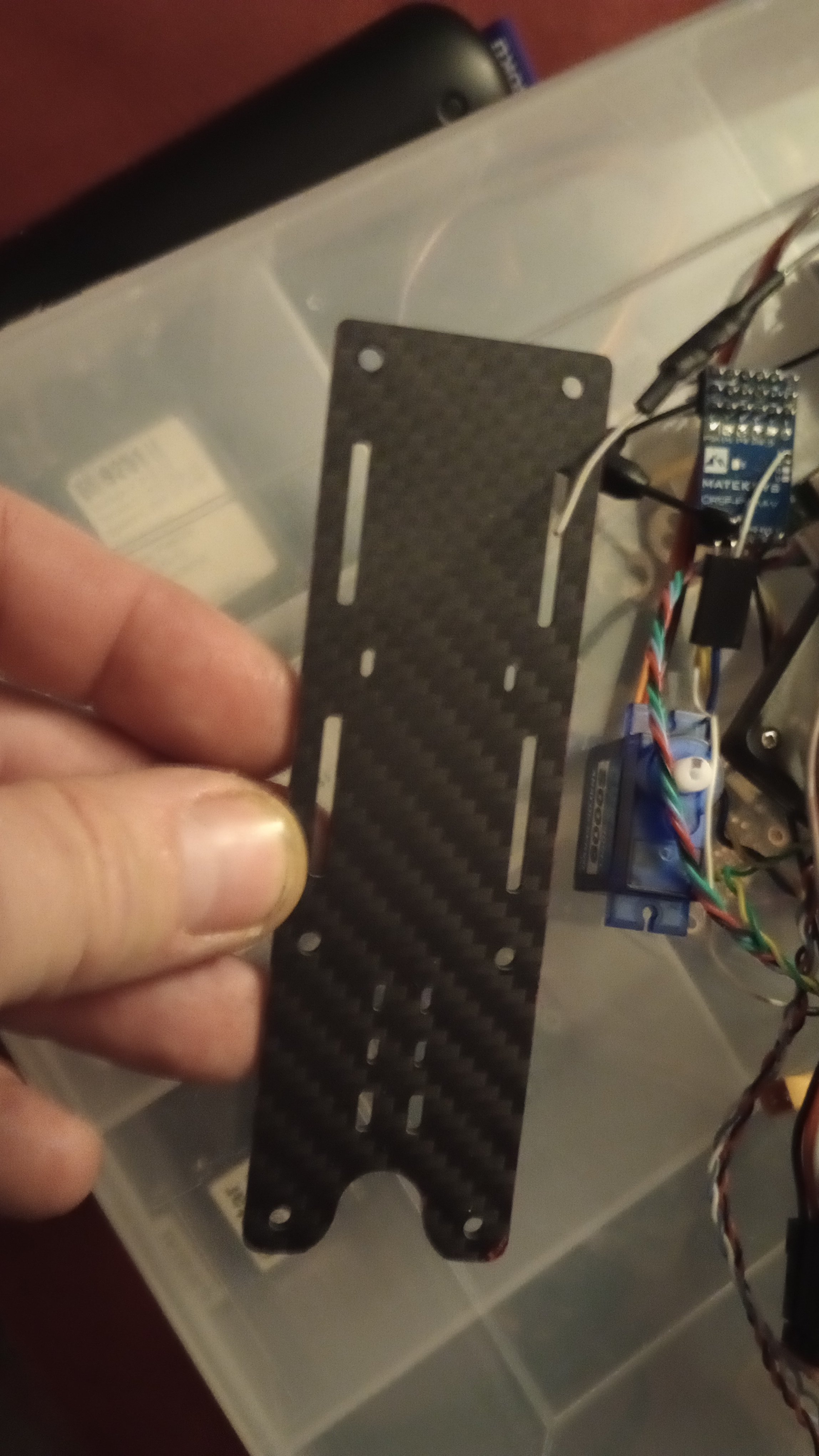

Nuts.... I found every part of the frame BUT the top plate.... >sigh<
FOUND IT! Too many plastic bins full of parts. LOL
Should have been in the FT 270 Frame bag it came in. LOL
Mocking up the top plate hardware. The frame and top plate hardware was originally set up for arm mounted ESCs and I'm using a 4in1 ESC. I'll need 10mm taller standoffs to give enough clearance between the stack and the top plate. It's a little more complex to change the front of the top plate because it also has standoffs above it for the action camera and FPV camera mount plates. Setting it up with a Walksnail Pro camera which is significantly smaller than the typical FPV camera of the past. With a built in gyro, it will make the action camera redundant and mostly not required giving a nice place to mount the GPS/Compass.

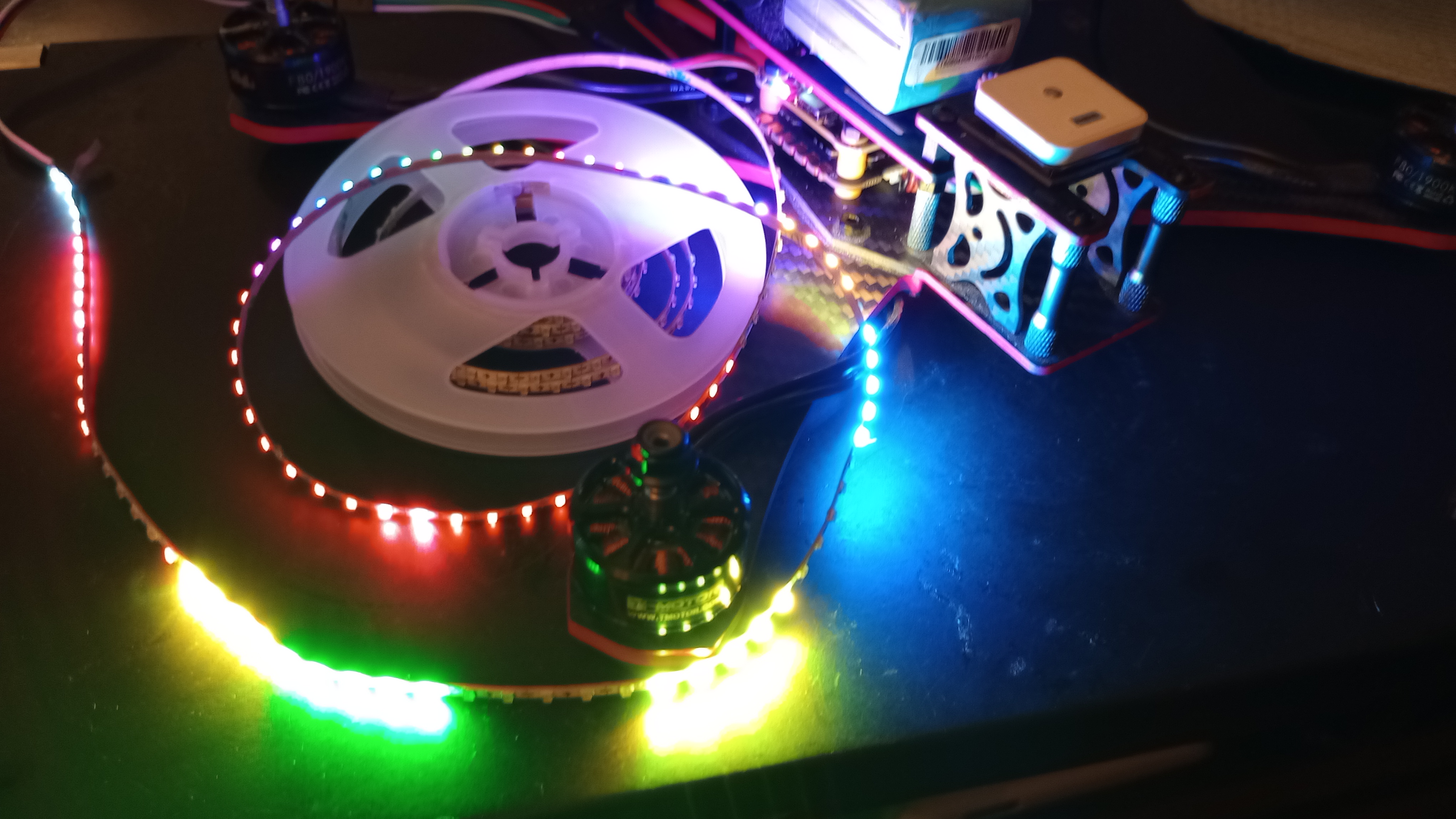

Lights.... did someone say lights??
