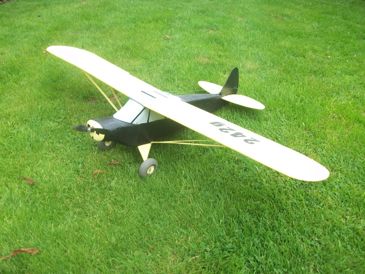

I have five planes that use a 6x4 on a 2s LiPo and they fly really well but they are light for their size, like this home designed Super Cub.
6x4 prop. 40" span and ready to go with a 1000mAh 2s LiPo it weighs 8.5oz (242g).
