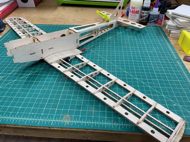

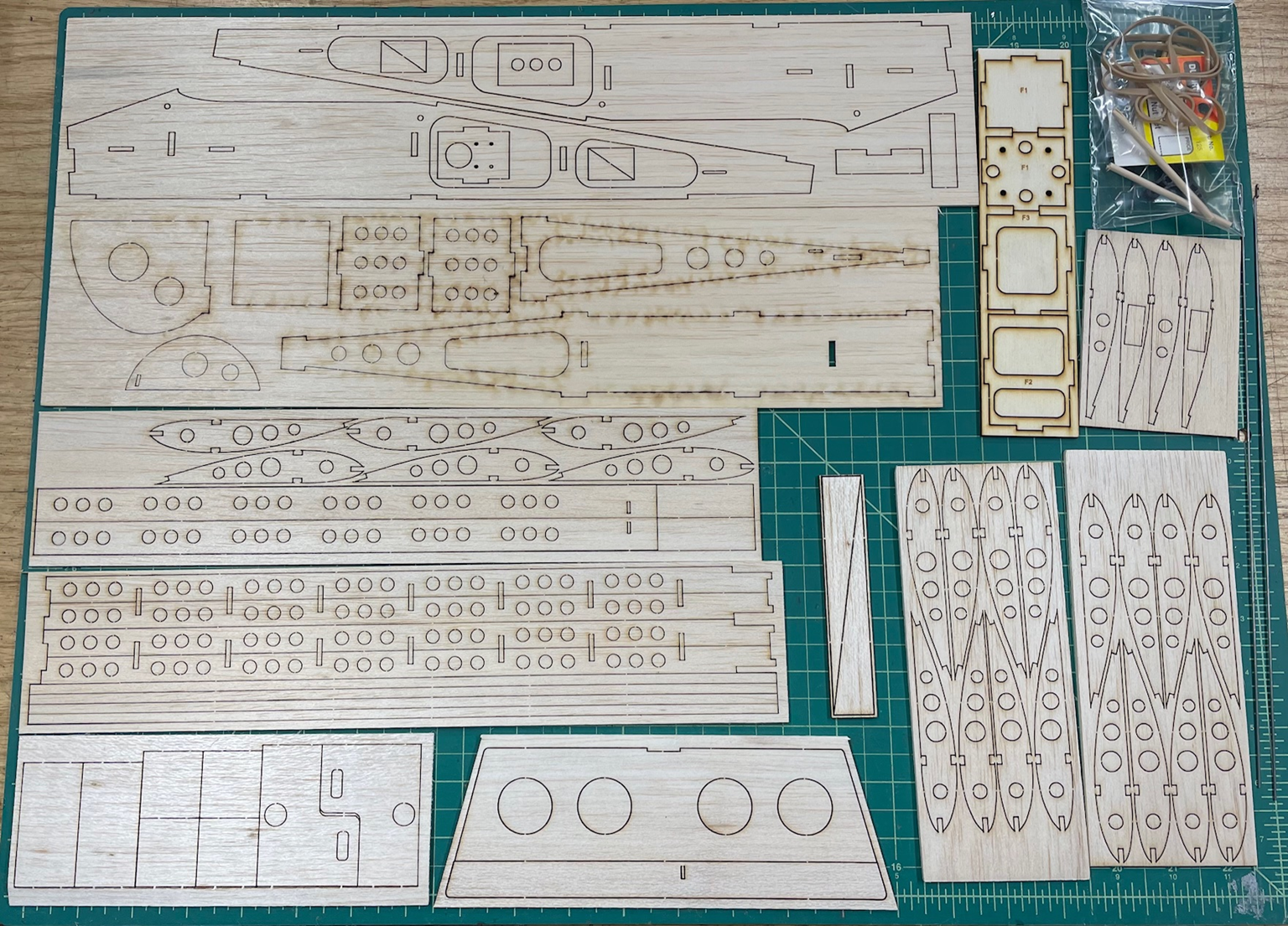

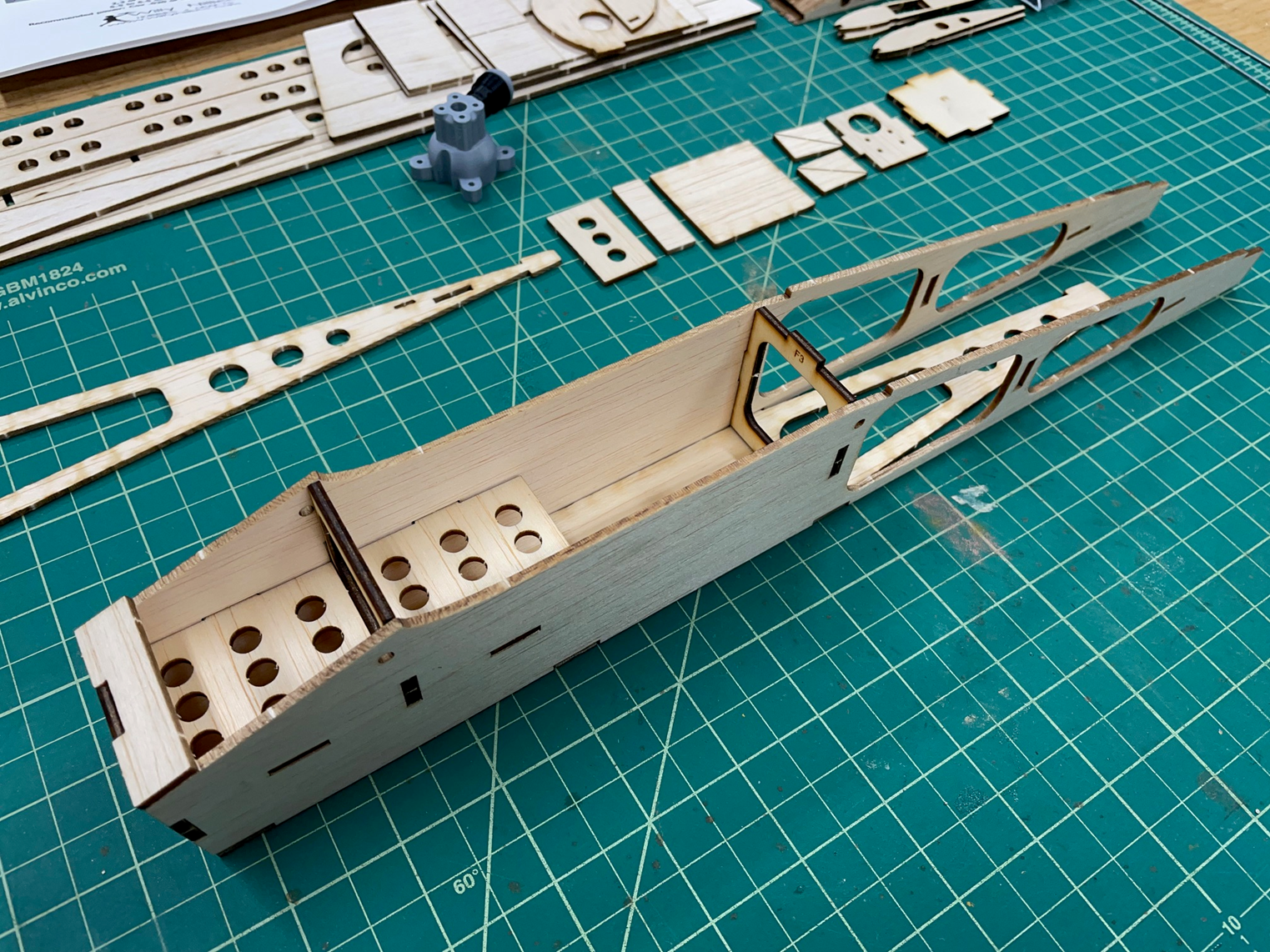

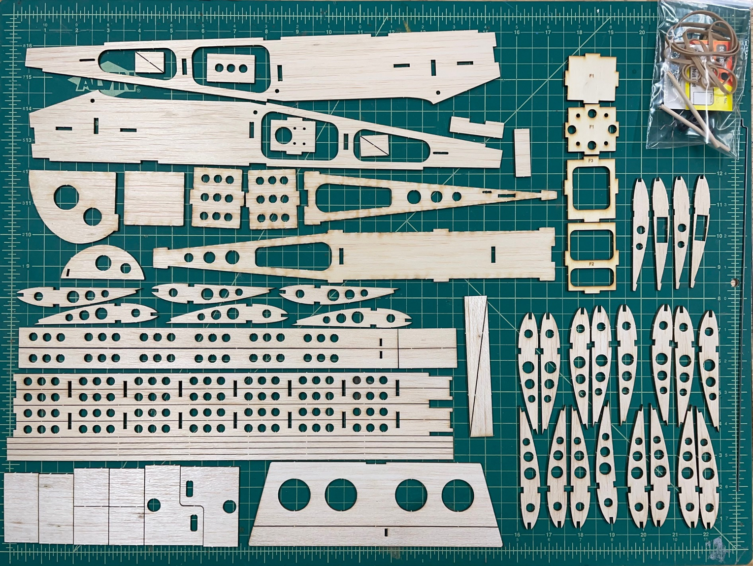

Breaking the seal on the package, there's no turning back now! The quality of the laser cutting is fantastic, and I only needed the knife to remove a few bits of the light ply formers, and the balsa parts almost fell out from looking at them too hard!
I'm not building for speed on this kit, which is good since all of my glue is completely dried up! An order for Titebond II, some CA, servos and other electronics is being put together, and I've obviously got all the other building materials from previous work. In the picture below the fuselage is just being held together by the friction-fit of the parts, no adhesives yet. I'm impressed with the design so far!

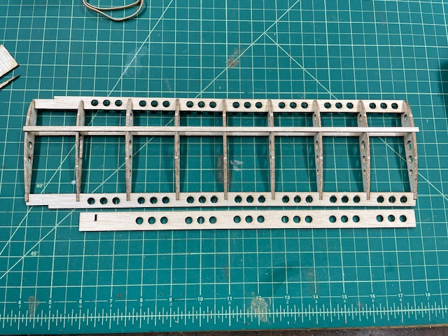

I don't get aggravated with building too often, but this kit is getting me there... Maybe I've been away from building for too long, or maybe I've got a BETA kit instead of regular production (my other Beta kits are marked as such). Here's what I'm running into:
- I haven't found any actual build manual or a build thread showing wing details. The fuselage was pretty easy, but the wing is a headache. There are a few pictures on the WN forum, but it's all very vague.
- The page included with the kit says the wingspan is 21.75", but my wing (without cutting it shorter) would be 28".
- If I remove two full "bays" at the end of each wing I'd end up at 21.75"
- The ailerons are sized to work on a 21.75" wing and would end up very short on a 28" wing. They'd work, but it'd look weird.
- The sheeting at the wing roots (to support the aileron servos and rubber bands) also make no sense.
- There are numerous extra ribs.
- Fuselage servo mounting is completely up to the imagination as there are no trays or info on how/where to mount the electronics.
So again, maybe I got a Beta kit, but it sure would be nice to see some kind of document showing what the designer intended. I'm leaning towards cutting the wing down to 21.75" which would solve some of the issues, and regarding the sheeting at the wing root I may just cut my own ribs and sheeting to do it how I think it would best work.
On the good side, the fuselage went together very easily. I ended up using Titebond II instead of CA which meant I needed to get creative to hold the sides together at the tail. CA would have made it much easier, but I just don't care for that kind of glue anymore.
It's good to be back......?

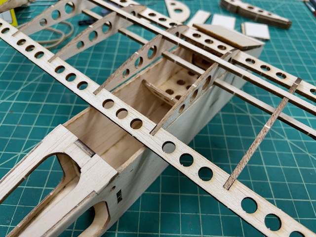

First question do the ribs kinda fit the fuselage hole where the wing goes?
Dang it, that's a key thing I didn't think of... 😖 A quick review tells me no, the wing is far shorter than the saddle. My previous glances at it were also accounting for the ailerons, which obviously wouldn't extend into the fuselage, so I didn't notice it. Well crap, I guess I need to reach out to WN to see if they can identify which wing I have so I can buy a fuselage to go with it. Might as well make lemonade out of this lemon...! 😄
To WN's credit, the wing really holds together nicely without any glue. However, this still doesn't account for all of the ribs I got with this kit.
In looking at the various kits on the WN site I've narrowed it down to two of them which may use the wing I received, hopefully they can figure it out based on the pictures I have shown above.

I reached out to WN via their website last weekend. They do sell the Littlest Stick wing kit on their website and instead of asking them to just send it to me I asked if they would include with another kit & accessories that I'm willing to purchase.
