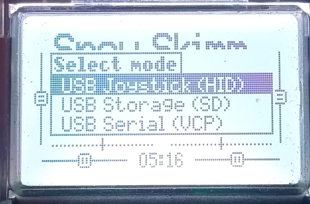

Should I be able to connect my Pocket ELRS to my Windows PC and be able to see what's on the MicroSD card? When I plug it in via usb cable, I hear Windows recognize a connection, but there is no sign of the Pocket in Explorer. I've looked for drivers, but can't find anything that could be expected to apply.
Make sure you have the radio powered up when you plug it in to the top USB port. It will give you a menu of options to chose from. USB joystick, USB SD, etc...
If you plug it in unpowered it will be in firmware update mode which you probably don't want to mess with at this point.
The bottom USB port is for charging only.
