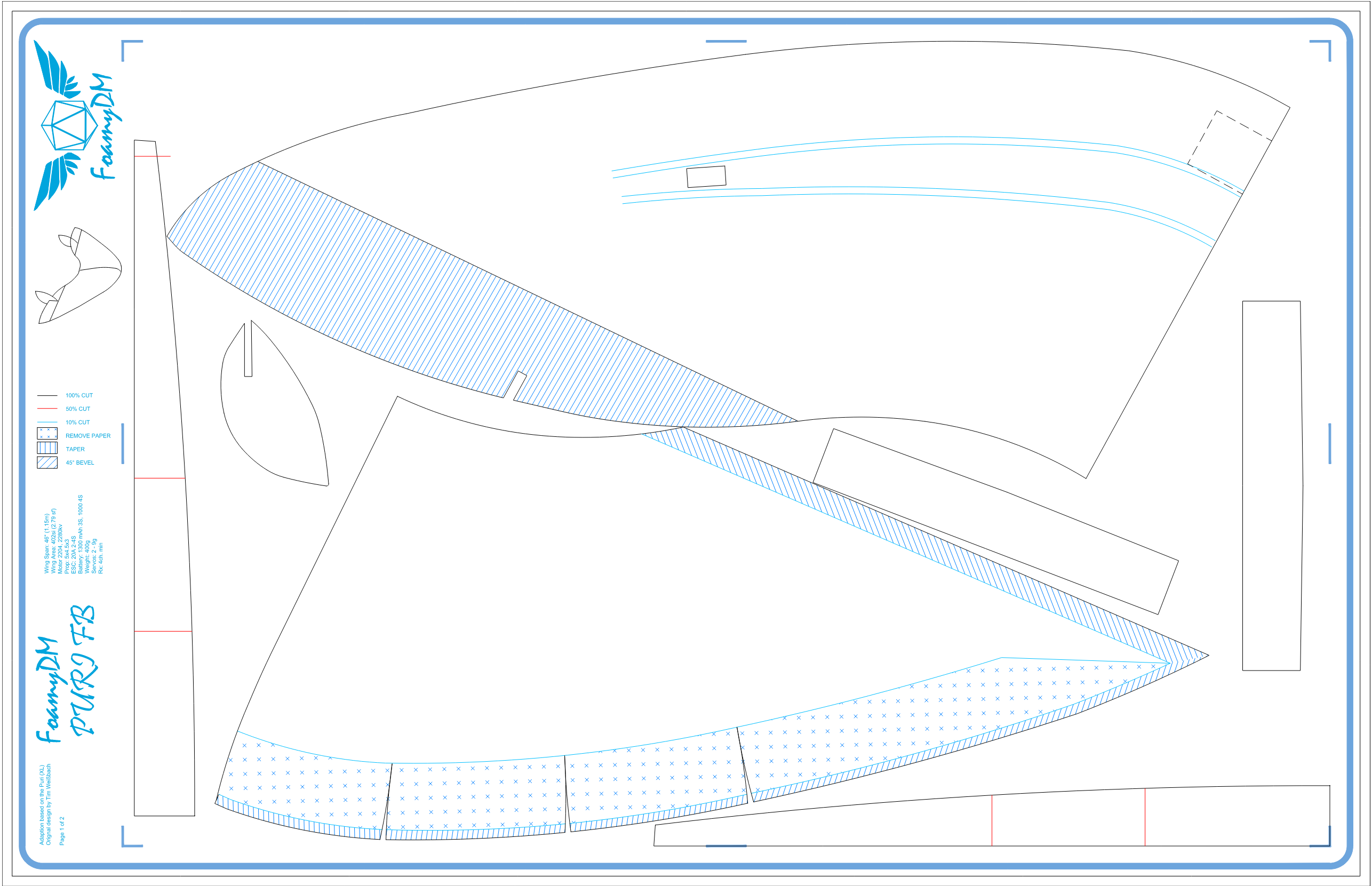

This first version will be a direct replica of the original. What I like about this aircraft is its shape it reminds me of two Maple seed pods glued together at their base. So as per my normal form I use the top down view to create a plan form and from that I created a plan set involving two sheets more or less a foam board.
When I had the plans I managed to mount them and I think a few weeks ago cut out the shapes.

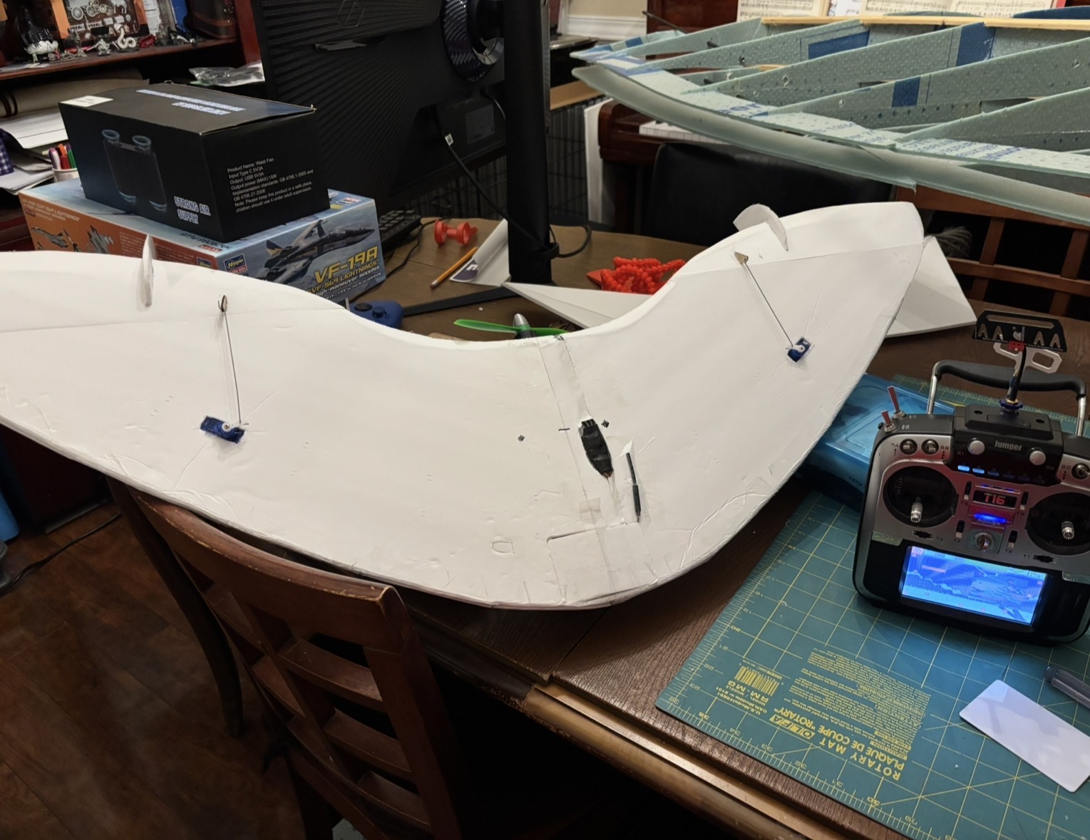

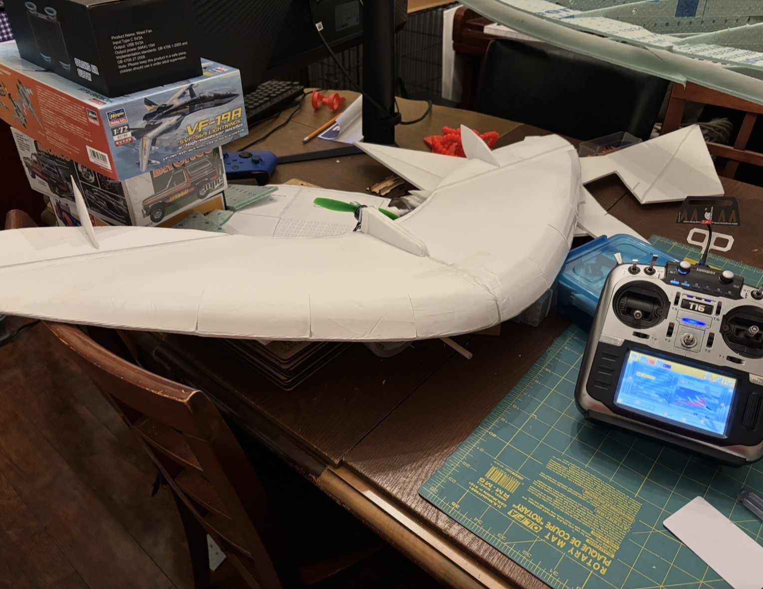

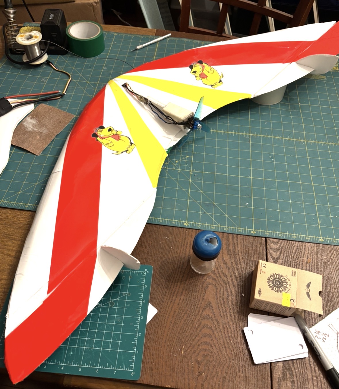

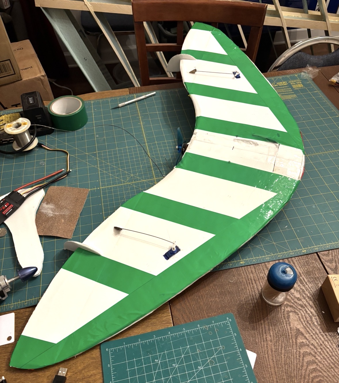

I’ve been rebuilding this per the new plans. In 2026 Buildruary. If the newly designed spar holds up i will rework the plan and upload it, so everyone can try.
I finished my rebuild and glide tested it, and confirmed that the CG is ~6” from the nose with reflex to be 90deg from the motor mount. I need to add the motor stack, and a reflex and throw guide.
