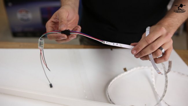

Here is the basic internal setup for the LED strip.
We used two 9 Mode Multi Colour/Multi Function LED Strips from Hobby King. One for each wing.
These things come with a control unit which allows you to pick through 9 pre-set "animations", from solid color, to blinking solid, to cycling colors, and others.
All you need to do is remove the sticky backing on the strip and wrap it around both sides of the spar.
To get the best effect, give the light room to dissipate. In other words, don't have the LED facing directly into the foam. From the outside you will only see little dots of light instead of the nice even glow.
But, if this is the type of effect you're looking for, experiment with it!
This is a setup with a basic single color LED strip. Just remember if you need to solder the ends of two strips together:
POSITIVE = POSITIVE
NEGATIVE = NEGATIVE

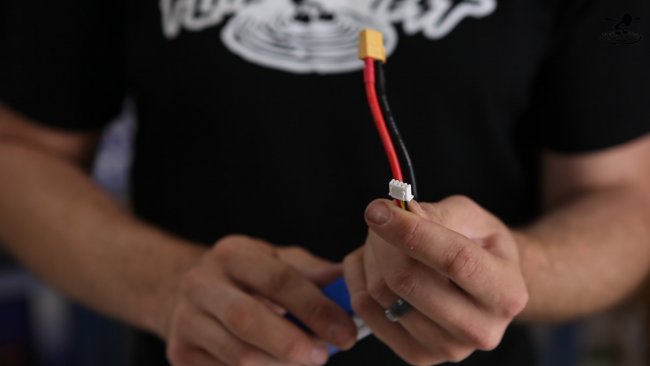

Remember, most LED strips require 12 volts of power to work properly. Less power and they will not glow as well. More power and you can actually damage the LEDs. Be aware this might vary depending on the brand you go with, so check with the manufacturer.
Use a 3 cell battery when powering your lights. If you also want to run the motor off the same 3 cell (instead of trying to fit two batteries into the plane,) you can always pick up a basic balance connector.
