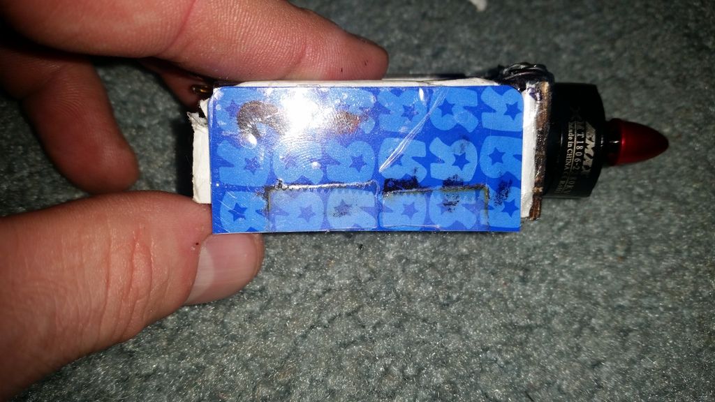

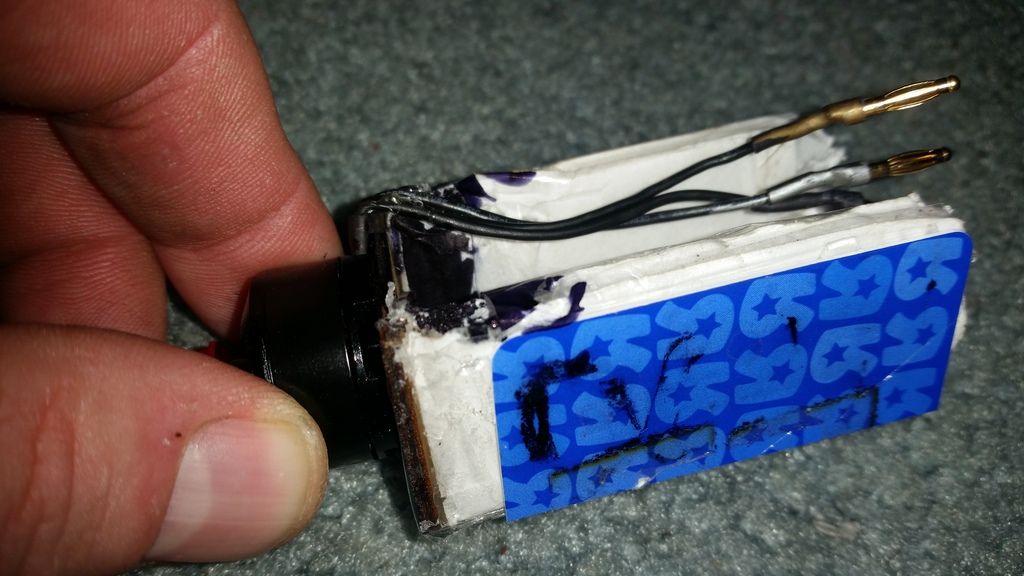

Motor Mount Repairs Mini Sportster.
Crashing is a part of learning. I crashed my FliteTest Mini Sportster today and damaged the motor pod. I made a simple repair with an old credit card. Here is how I did it.... I am Dean New to fixed wings, I have some flight experience with Multi Rotors, I have driven RC cars for almost 30 years but This is the first time I got into fixed wing fight. And this is my first attempt at authoring.
So I was trying to taxy my Mini Sportster and hit a twig and crashed into a planter. The motor pod was pushed back but the plane itself was fine. My first thought was to buy a new pod. Flight Test was closed for the weekend. So I looked in the shipping box where I kept my build supplies and saw an old gift card. Genius struck. A few snips with a pair of scissors and presto reinforcement and meat for new holes. A little hot glue.
A few seconds with my dremel and we have a repaired pod. Time to slide the BBQ Sticks in place and we have a repaired airplane!
Total cost: I old credit or gift card and some hot glue.
In Summary. Never be afraid to fly your plane, and never be afraid to try and make repairs. This repair of mine should make the plane a little stronger, despite moving the CG a little. Never be afraid to build, because if you build it you can repair it!
