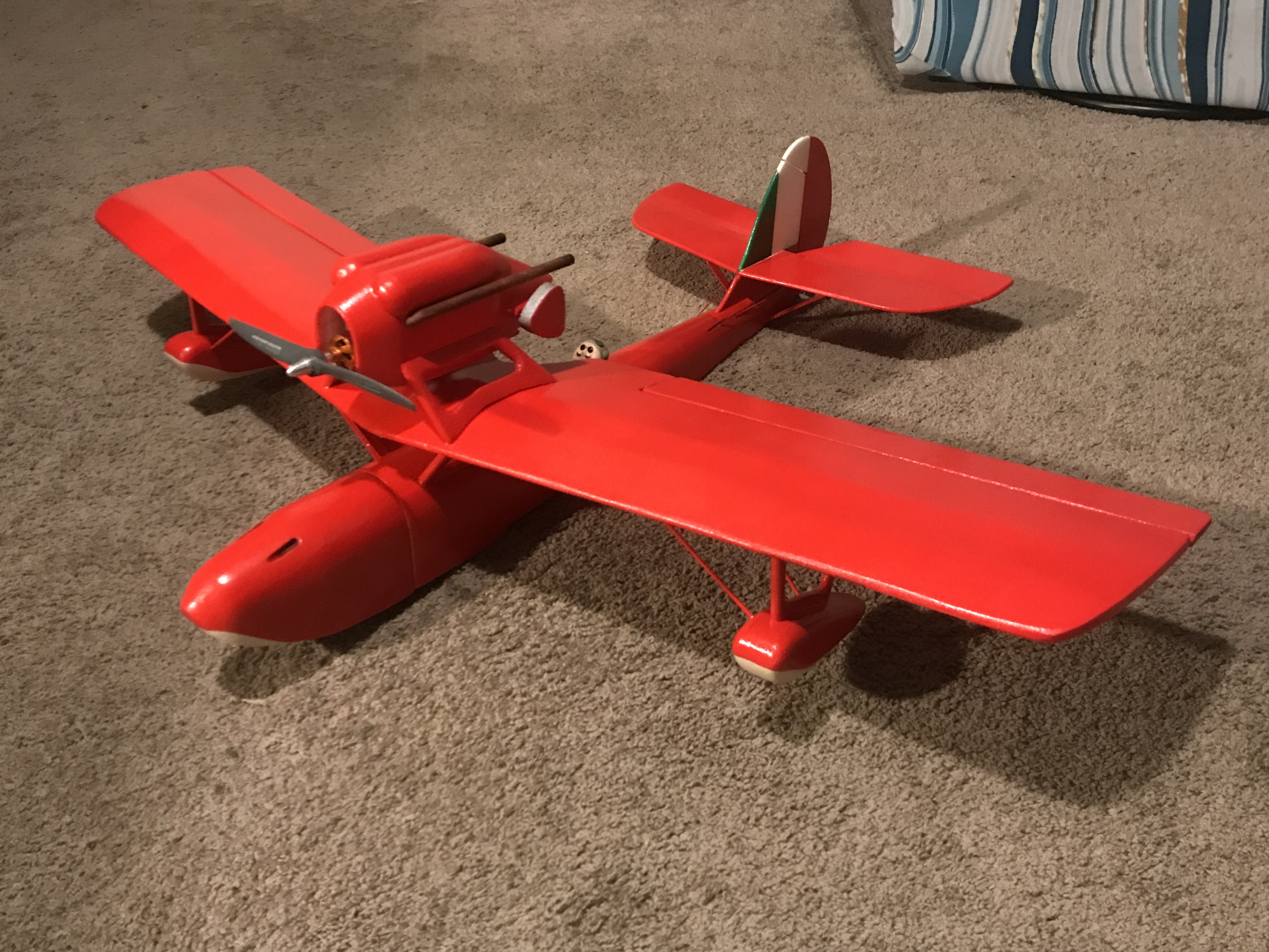

I'd like to end with a real-world example of how foamboard is "heavy" (ie. the same plane can be built lighter). This is my FT-Sea Angel, built with all paper removed. My build has a larger/heavier motor, carbon-fiber wing spars (to make up for the loss of rigidity from removing the paper), extra detailing on the engine nacelle and cockpit, a pilot figure, and a full paint job.
I added a whole bunch of detail and came out with an empty weight of 535grams (18.87oz).
By comparison, the published empty weight for the FT Sea Angel is 635g (22.4oz) So I saved over 100g by building without hot glue and without the paper.
It hasn't flown yet, so it could still be a complete failure, but it looks and feels pretty good to me.
Another benefit of building with just the foam, you can sand in curves!
