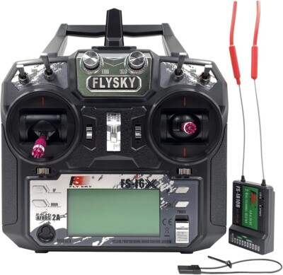

If you ever want to upgrade this transmitter work very well (It's the one I have, my brother has and @Mr Man has)
Here is one on aliexpress if you don't mind waiting a couple weeks:
Or here is one on Ebay:
Or here is one on amazon:
If you look around you might be able to find it at a even better price

Cool, I'd like to keep my DIY setup because it's really flexible, i can just code whatever function I need. Moreover I'd like to make some experiment and I really need the option to connect other sensors

Okay yeah. Just because this one will have zero latency and you get at least 300 yards range.
