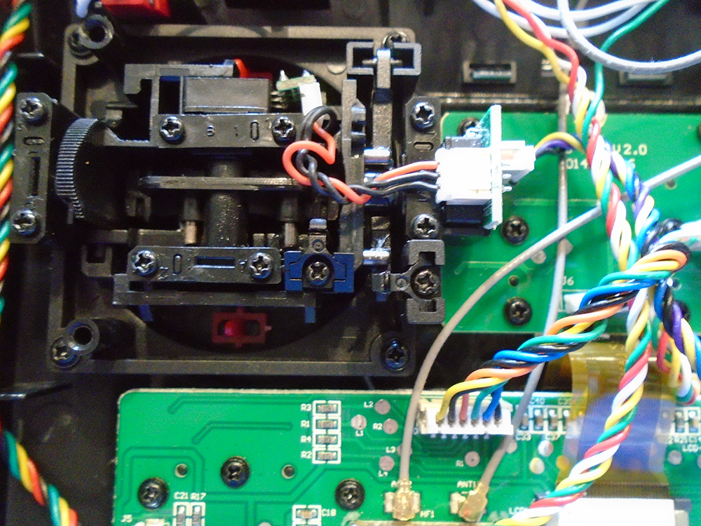

It might help if you reduce the gimbal sensitivity, the sticks have springs internally, which allow you to adjust the tension.
Gimbal Tension Adjustment
You may also want to, adjust the gimbal tension of the sticks. Since FPV pilots move the throttle a lot, you can unscrew the throttle plate tensioner of the gimbal all the way for maximum smoothness. However, since FPV requires smooth yaw, pitch, and roll most of the time, you can tightened the springs on each axis to their maximum. The results give a much more enjoyable experience while flying. Plane pilots may want to tighten the throttle a bit more, as planes don’t need to go from 0 to 100 all the time.
