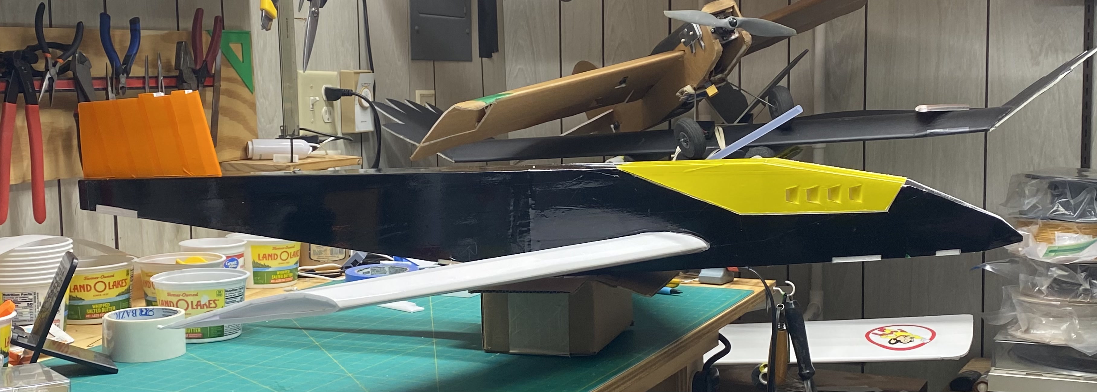

Thanks to a post by @Brian B I discovered this plane and am just finishing up. What a fun build, excellent plans and instructions! Since it's too cold to paint I took my first stab at really thin colored packing tape and I now have great respect for anyone who can do this without wrinkles. I've got a good 15 foot job on it. One big surprise is how BIG it is. It out grew my regular build table and is almost to big for my big table! Hope this post bumps this plane up in everyone's attention.
Edit: Upper wing, vert stab and wing end supports just taped up right now. I'm going to use beacon foam glue on the vert stab to give me some working time to hot glue the ends of the wings. I'll let you know if that brilliant plan works or not :ROFLMAO: :ROFLMAO:
Edit of the Edit: It worked great! Even a blind squirrel finds an acorn once in a while.
