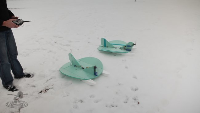

The Snowball was the brain child of RCGroups.com fourm member Lee. He smashed together two ideas from fellow scratch builders goldguy and Larry3215 to create the "ATV" of foam board planes.
What separates the Snowball from a Nutball are the raised motor and the pontoons on the belly.
Snow does not mix well with foam board, as everyone knows, so we built these big guys out of 1/2 inch insulation foam.
It worked well with repelling water, but the material was too brittle in the cold. To see their untimely death check out the episode.

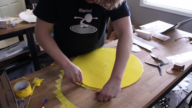

2. Colored Packing Tape
You can pick this stuff up all over the place. We got ours from LazerToyz.com.
This method was the cheapest but most time consuming. The cool part is getting to design your own color scheme! Here, Alex went with "Don't Eat the Yellow Snow(ball)". Just make sure that if you are gluing two surfaces together, cut the tape away because the glue won't adhere too well to the shiny surface.

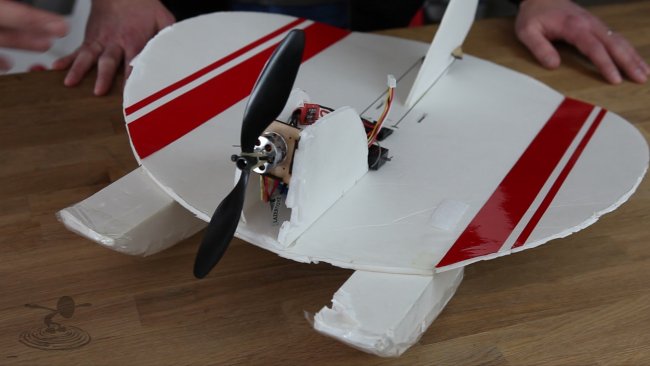

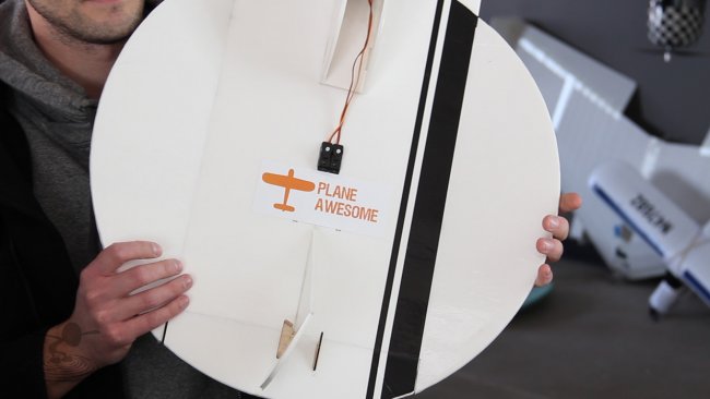

3. Laminate Contact Paper
This is another one that you can get at almost any craft store. This was more expensive than the tape method but looks much cleaner.
The rolls come in a variety of sizes. Same thing as the tape method if you are gluing two surfaces together. Remove the laminate from whatever surfaces you want to glue together.
This is the finished contact paper version. Shout out to Nolan, Blake, Randy, and Jedd from plane-awesome.com for sending us some stickers! Check out their reviews and send 'em some love!

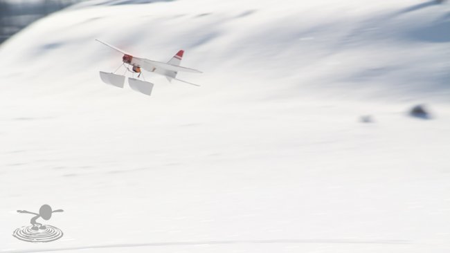

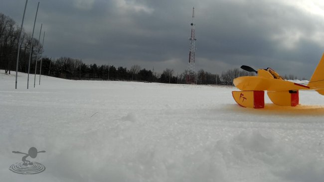

Once we had our planes armored up, we took them for a spin!
We were happy with all these techniques to help our planes combat the harsh season. Use which ever method is more convenient for your project.
