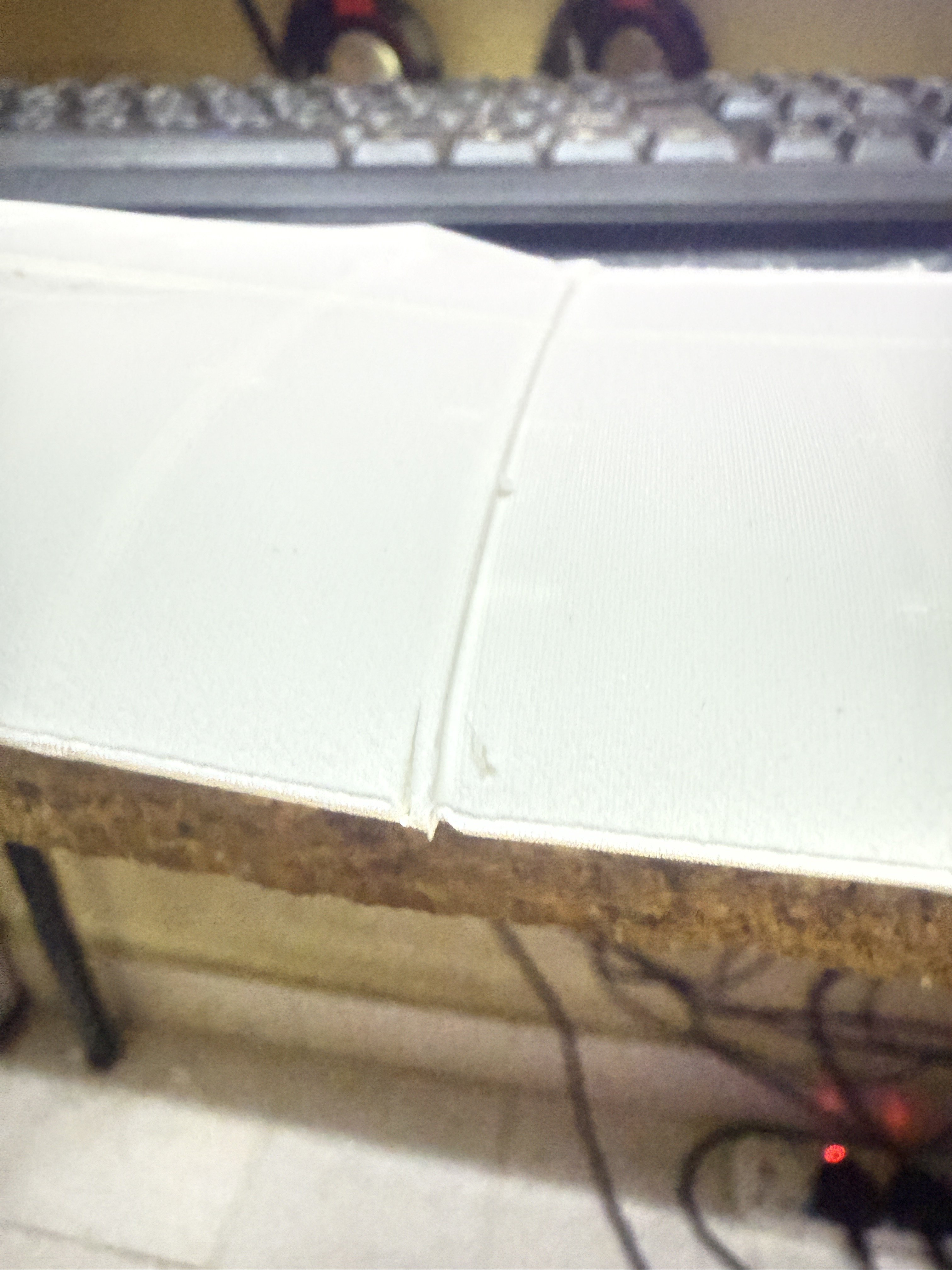

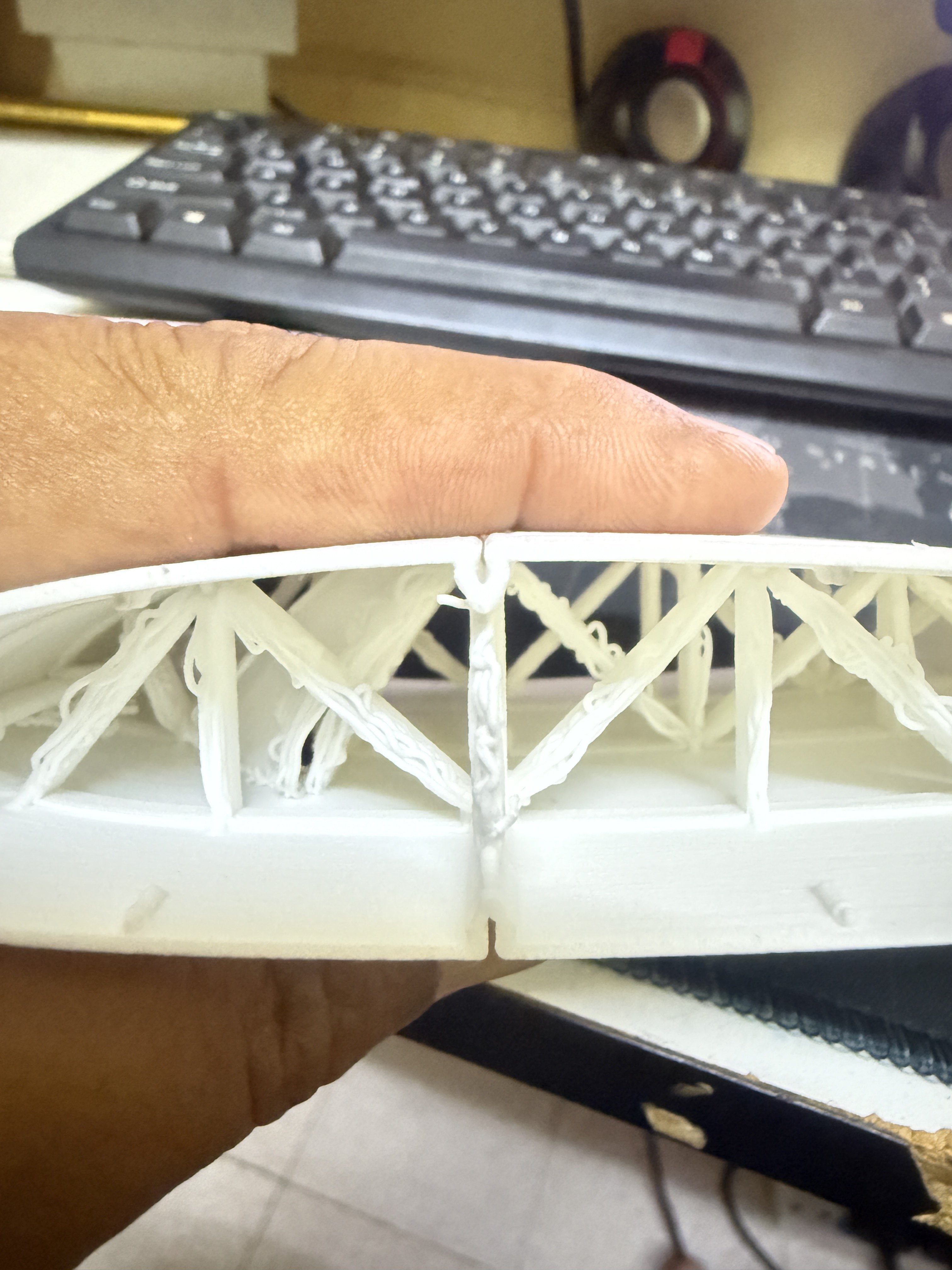

I've tried printing using Cura Slicer with best setup that I can think of, turn out everything printed out well until when assembling the wing parts got me. It seems that the outer line is causing the wing groove channel tighter than it should and I don't think a strip of PLA can get through it (Image A) . I also tried using the G-Code provided by 3dLabPrint and the groove is much better (Image B), however the wing end/seam seems a bit brittle and when tried to join em together, some of it chip off (Image C).
Do you guys have any ideas or tips/tricks on this?
