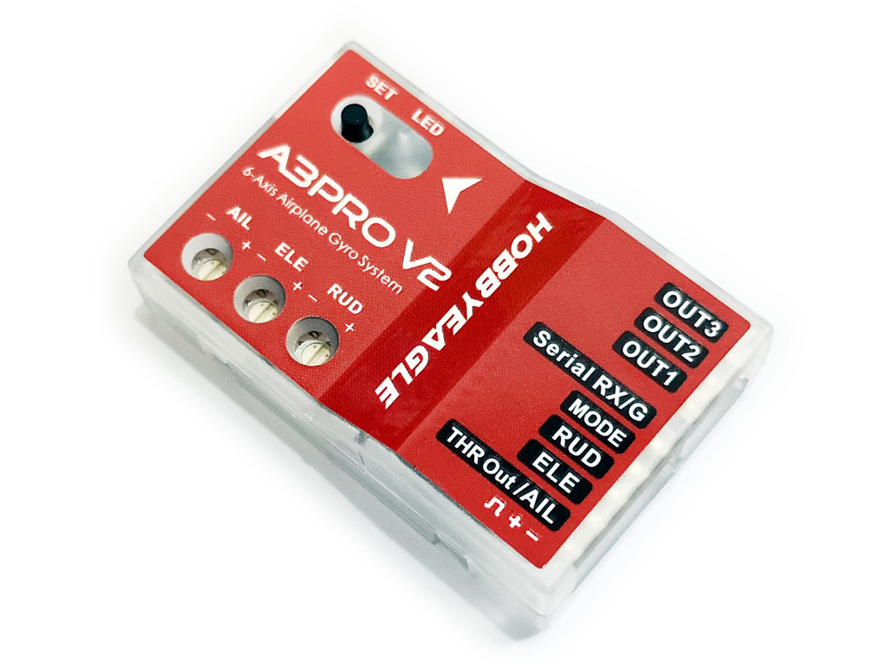

Foamforce
Just get a separate gyro. I use the this one in a couple planes and it’s easy to set up and works well.
For the receiver, get something that supports sbus, then you can run a single wire from the receiver to the gyro. You can get a tiny one like this that only has sbus…
Or a larger one that also supports PWM, in case you want to use it without the stabilizer later.
