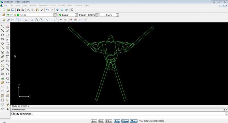

I was going to build a tricopter but say the episode on the V Tail and I was hooked. It just looked cool and still had more fluid movements than a standard quad. I looked at lots of pictures and came up with my own design (based off from the bat bone) and started to draw it up in cad.
I then collected the materials and cut it out on a laser. the main frame is 1/8" birch plywood and the booms are the 1/2" square dowels from the hardware store. I used 6-32 hardware through out to hold it together. I also drew up some landing gear and laser cut those out of some thin ABS (however, I think these will be replaced with delrin at some point) here are some photos I just took of it after I finished the frame

Your design has one common problem. The V-tail motors are slightly tilted towards the front too which will make the copter creep forwards all the time.

Thanks for all the input thus far. The weight of the frame as it sits is 250 grams which seems respectable.
The laser I am using is a Chinese laser. 80 watts which is over kill for this but we use it for plastics at my work. I think it's similar to the laser that the flitetest team uses from what I could see in their videos. It's from rabbit laser in Ohio. Great company to work with. I just use the software it came with which is laser cut 5.3. I draw the files in dxf format in draftsight.
I also cut out pieces to build a H quad so I may put that together.
I'm all about file sharing this kind of thing so if anyone wants the cad, let me know!

Balu, did the one that David built out of the bat bone not have the same issue? I could change the motor mounts on the tail to square it up better. Wouldn't be all that hard. Thanks for the tip!

Yeah, its just a standard right angle gusset with beams construction. very similar to aluminum extrusion I use at work to build machines. kind of like erector sets or legos!
