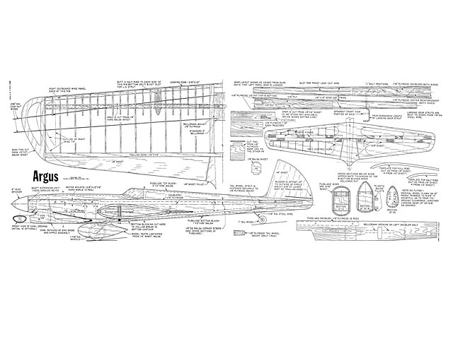

And here's my contribution to the challenge: Argus (Greek God of the Sky)
by Steve Wooley (1961)
Source: https://outerzone.co.uk/plan_details.asp?ID=4885
