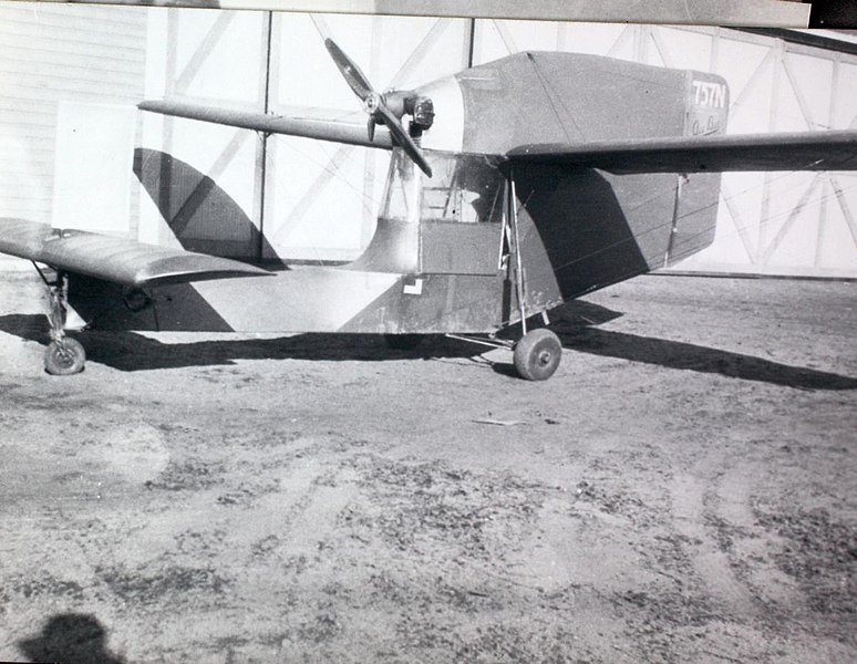

After conversing with @FlyingTyger on my Podcast where Tony covered the history of the Granville Brother Aircraft Company. In that conversation, he talk about the Q-1 Ascender, I knew at first glance I had to try my hand. If you want to hear the conversation we had, you can listen/watch here.
History and Full-scale Specs:
Ascender 1931
26hp Aeronca E-107 pusher;
span: 38'0" length: 19'0" to 23'3" (uncertain);
first flight: 12/1/31 (p: Z Granville).
Designer: Zantford Granville, Robert Hall.
Canard configuration with a forward rudder and elevator used extended Aeronca wings.
1 was Built [X757N] c/n Q-1,
claimed to have been built in about one week at a cost of $500. Crashed in a low-level spin on 1/1/32 and was scrapped
