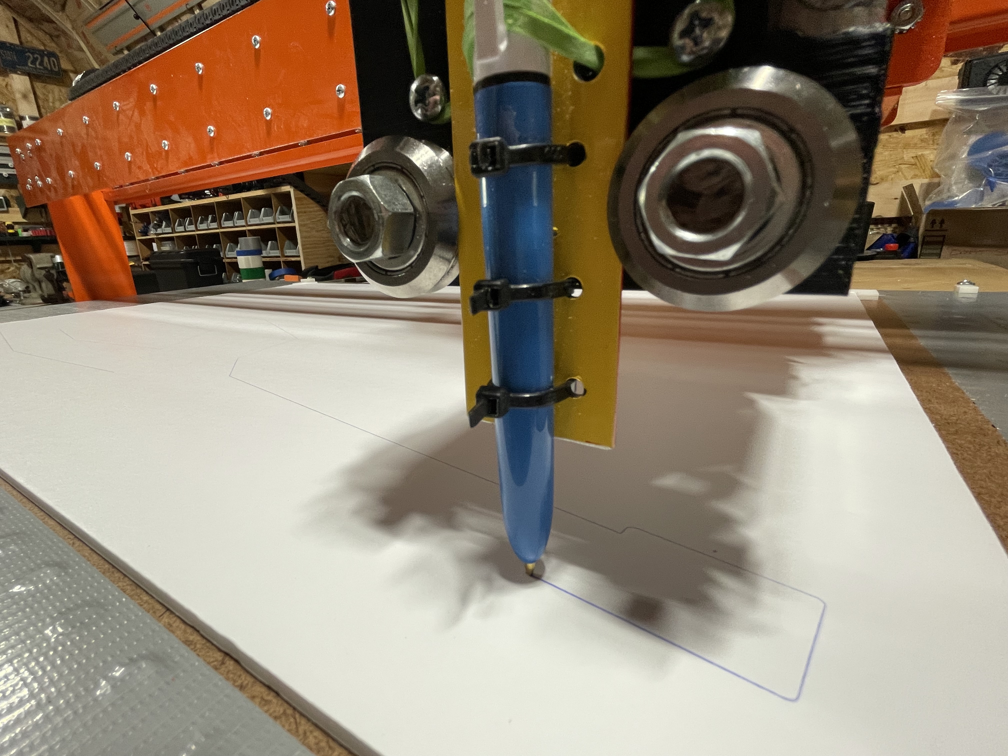

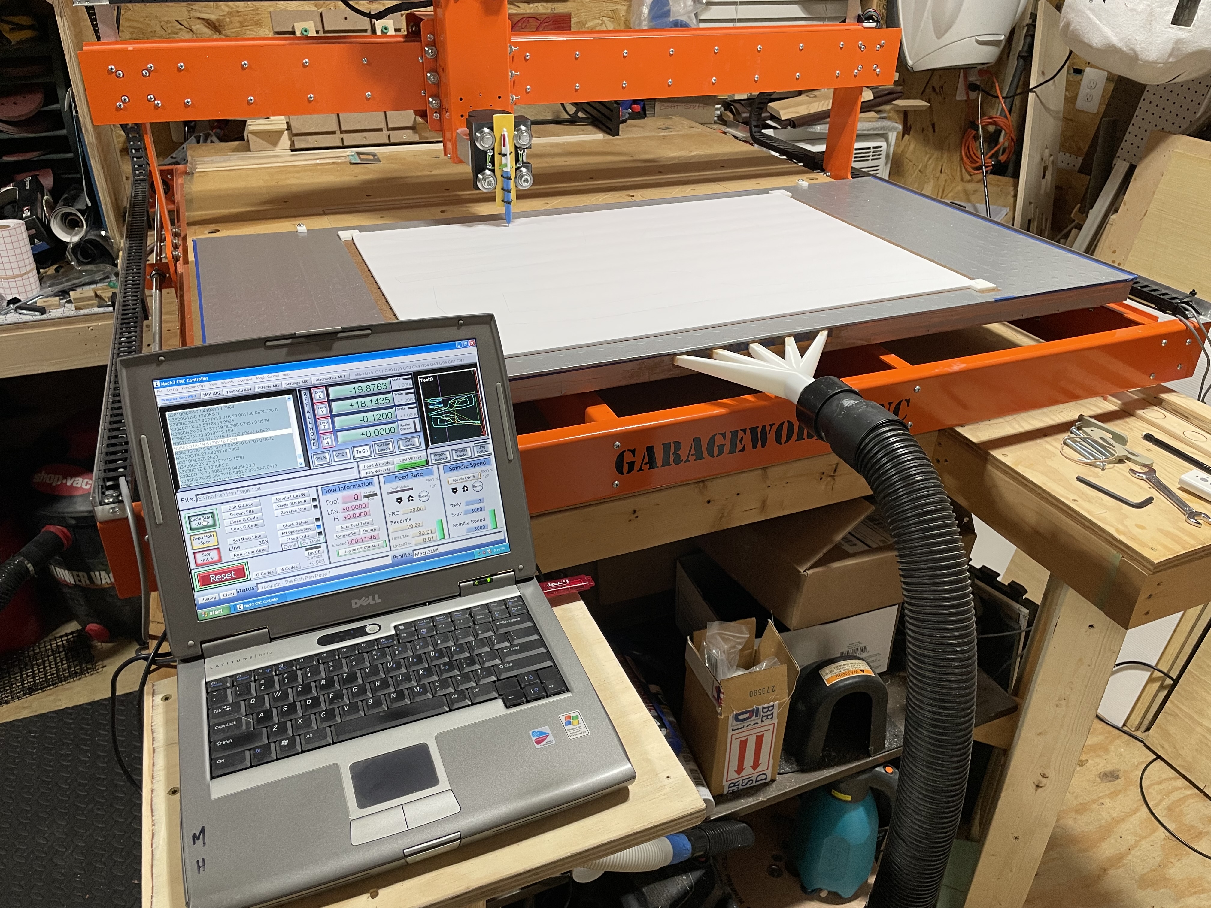

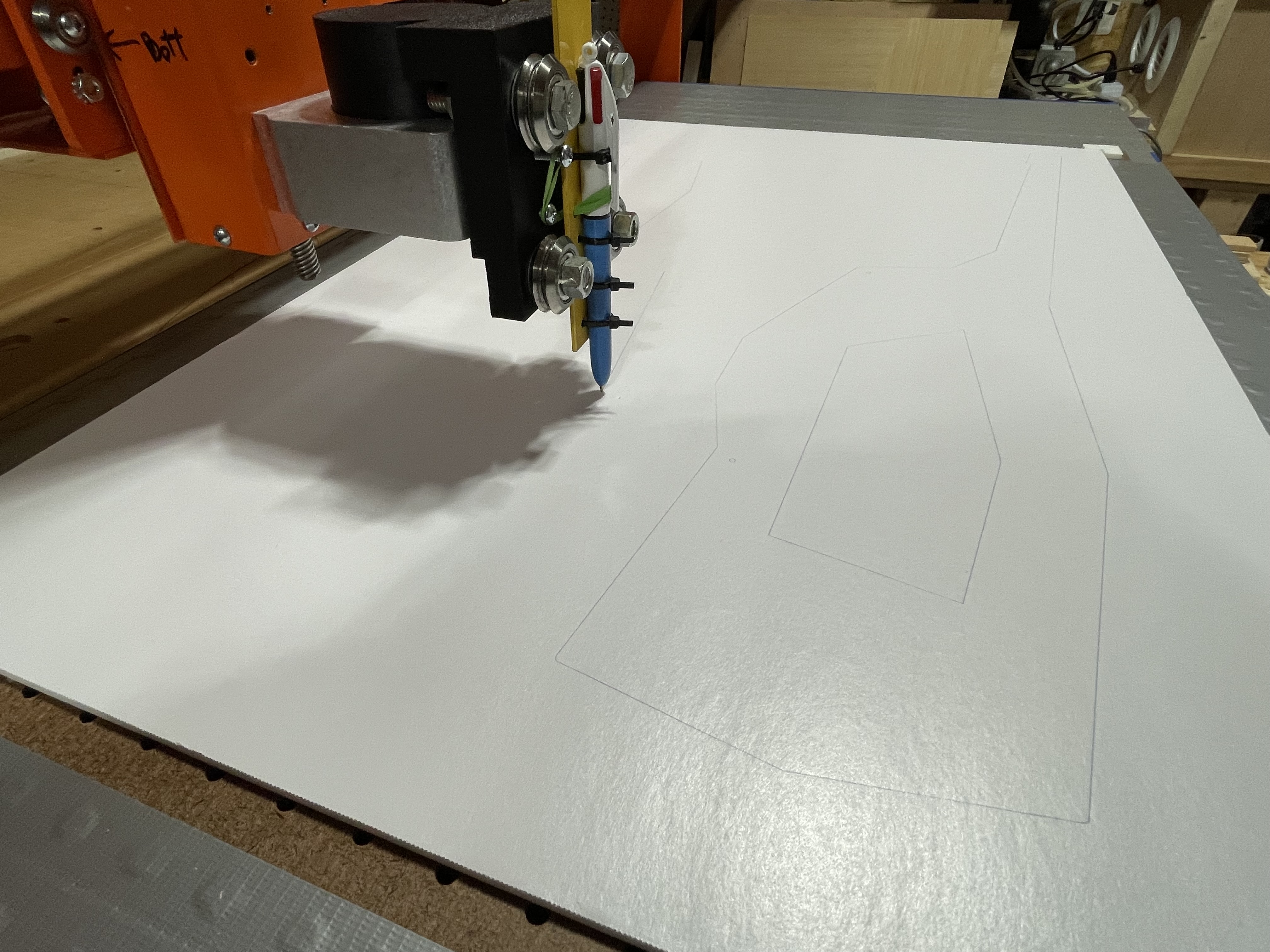

I’ve printed plans at Staples before and it’s worked out well. Lately I’ve been using my cnc as a plotter and then cutting out with a knife. I’ve used tiny end mills on the cnc but the foam board cuts are always fuzzy and the sanding/clean up takes a while. This way is pretty fast, restful, quiet, and the edges are nice and clean.

Pretty cool using a cnc as a plotter. Wish I had that option.
